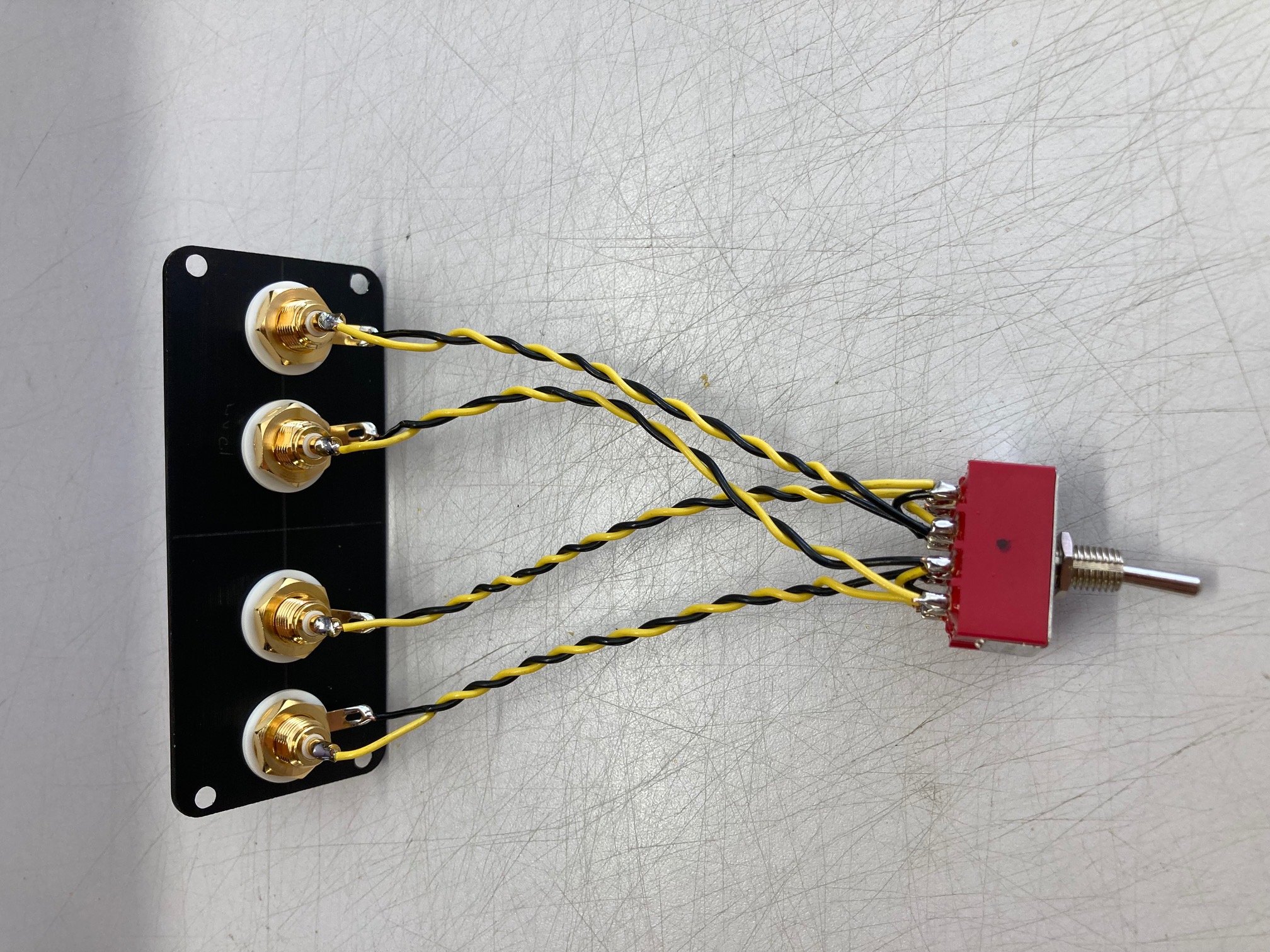

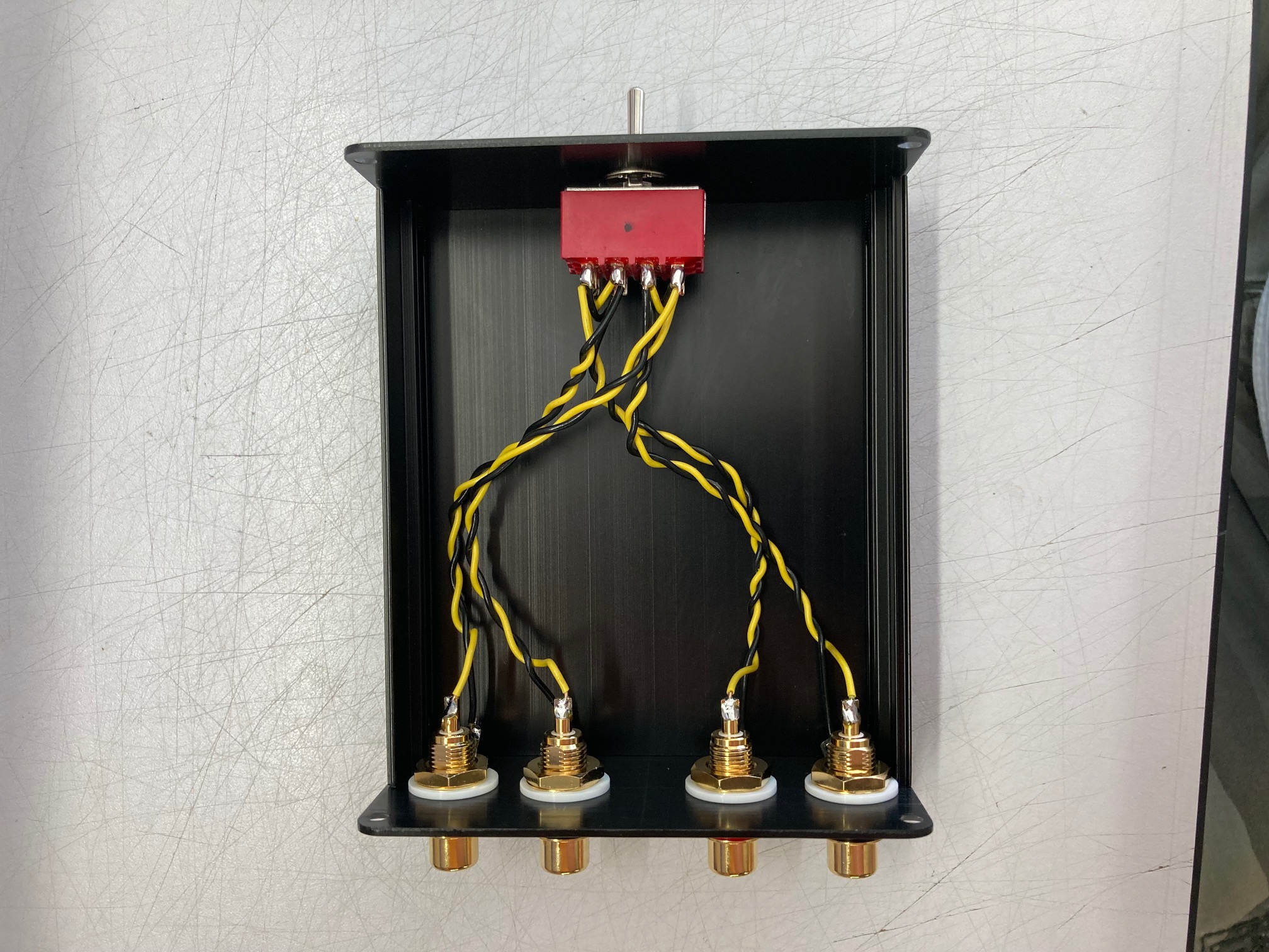

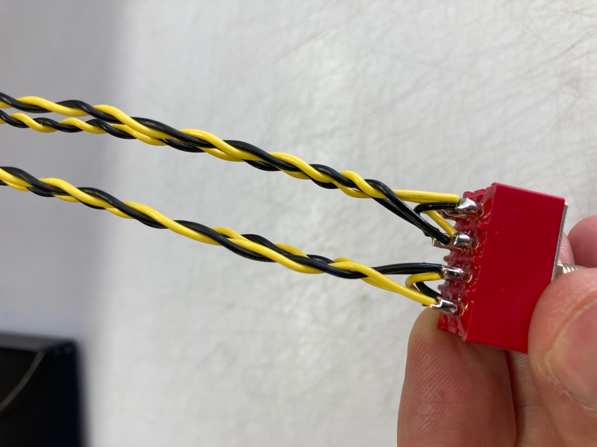

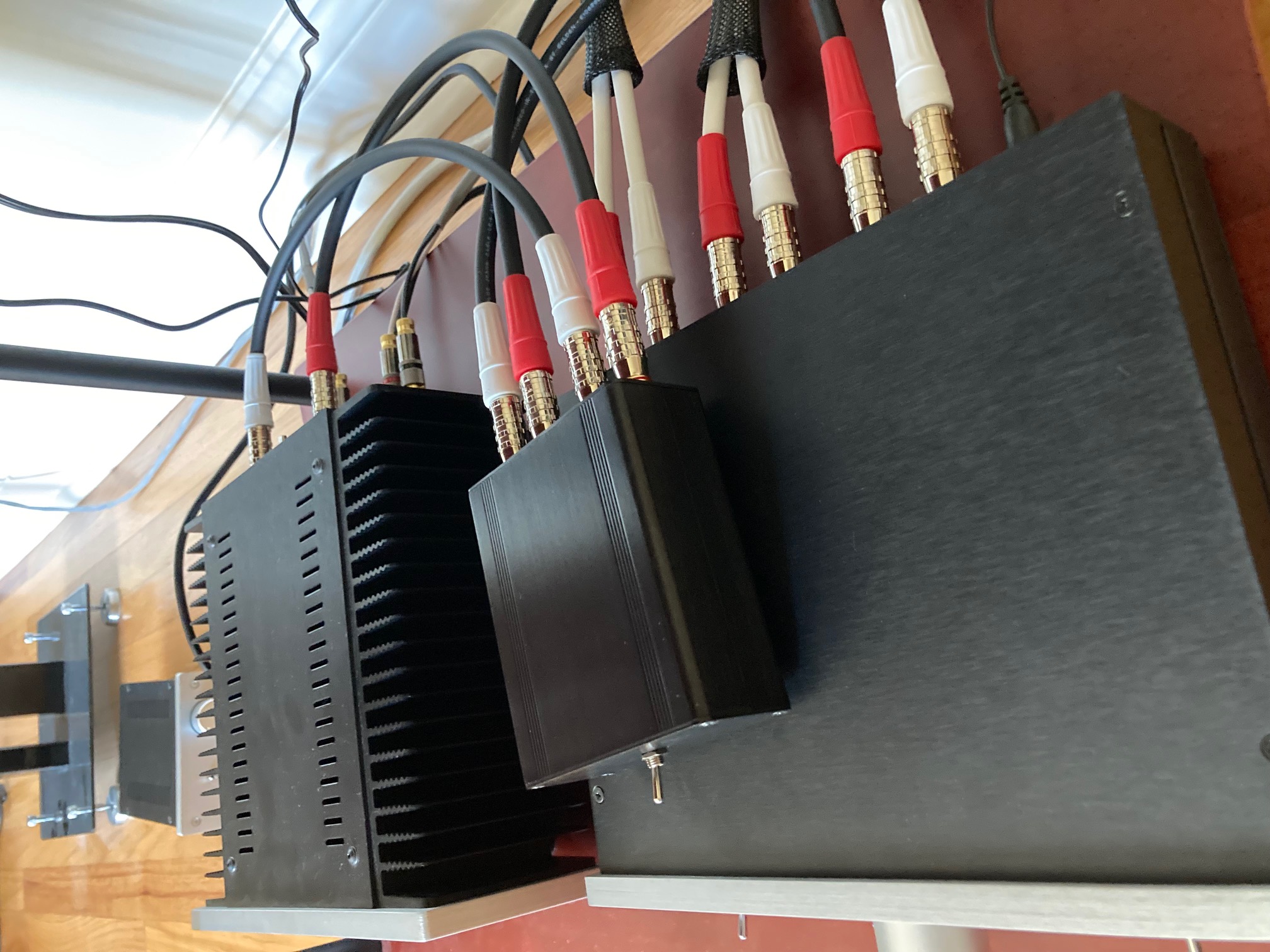

Playing with polarity
My nagging curiosity got the better of me so I built a little box to test the effect of inverting the polarity between my B1K and ACA. In short it's similar to what I hear when inverting speaker polarity on the ACA- loss of soundstage, loss of detail and dynamic range. Everything compresses down and sounds more monophonic. It's a subtle effect but strong enough to lead me to believe I could pick out the inverted polarity in a blinded A-B test. Note, my B1K is biased at 9.5V to produce positive-phase second harmonic distortion.
In a brief test of a transformer-based passive preamp, I didn't hear any effect from switching polarity.
