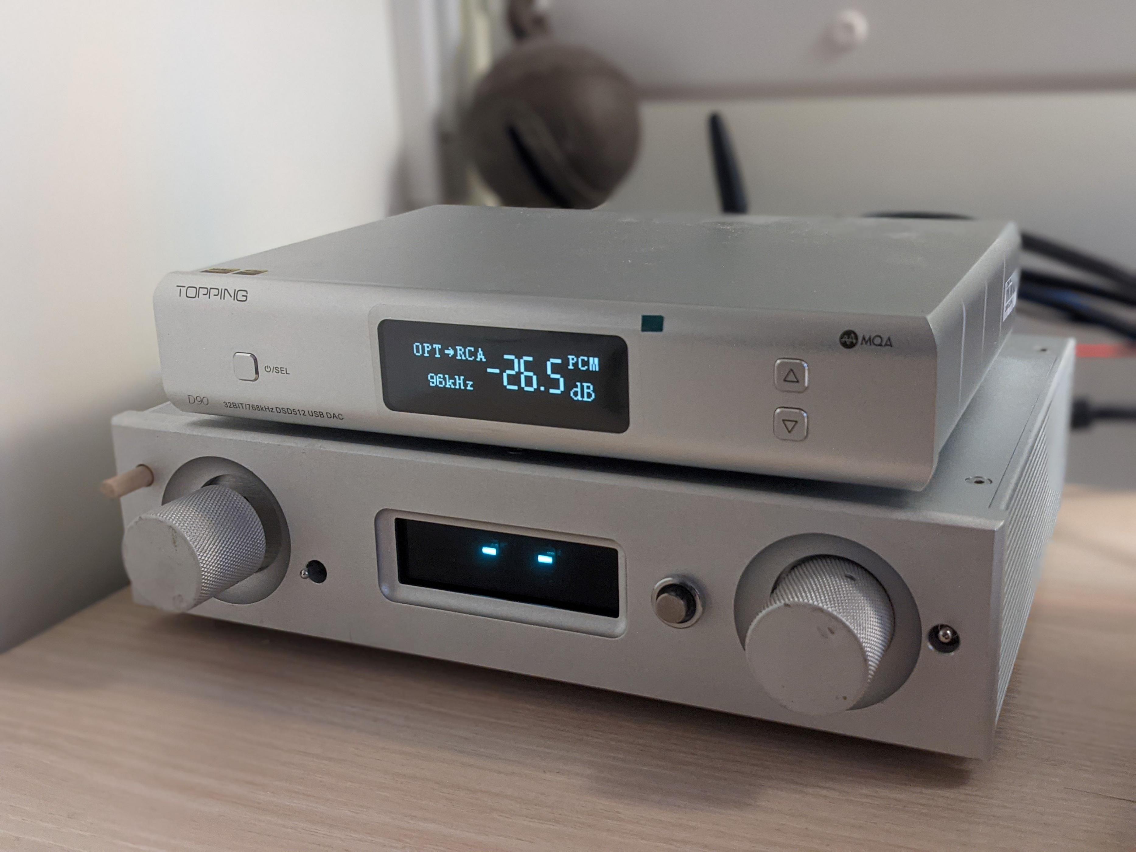

B1 Korg + Wiener Pro Integrated Amp
Hi All,
Glad to let you know that I finished my nice little integrated amp for my bedroom. Paired it with a Topping D90.
It consists of a B1 Korg and a Wiener Pro powered by 24V LPS. I also put an input transform in between the pre and class D for phase inversion. On the front panel, from left to right, are selector, volume control, toggle for bypassing the Wiener, a window for display the Korg, Main power, 12VDC / 9.5VDC plate voltage adj, and toggle for power supply to the Wiener. It rings a bit when I push or turn a switch but the ring damps out in seconds.
The most time consuming part was the planning and fitting of everything in a small box. I am not good at describing the sound but I can say I am happy with it. Thanks for the nice project!

Mainly to reduce some crosstalk between channels. I didn't like the L & R channels twisted together like the build guide.Thanks Cinco !
What are the advantages of running individual ground wires as opposed to the single one shown in the 6L6 build guide ?
If you untwisted all those pairs wired to the selector switch, straightened them out and sky-wired them, it would be ok. I'd leave the grounds twisted though to reduce ground loop area. It won't look very neat though.

Very nice Mituisho! Where did you find the enclosure and knobs you are using?
I bought them from Taobao China.
You may be able to find them in Aliexpress, try search for "Breeze Audio Chassis".
