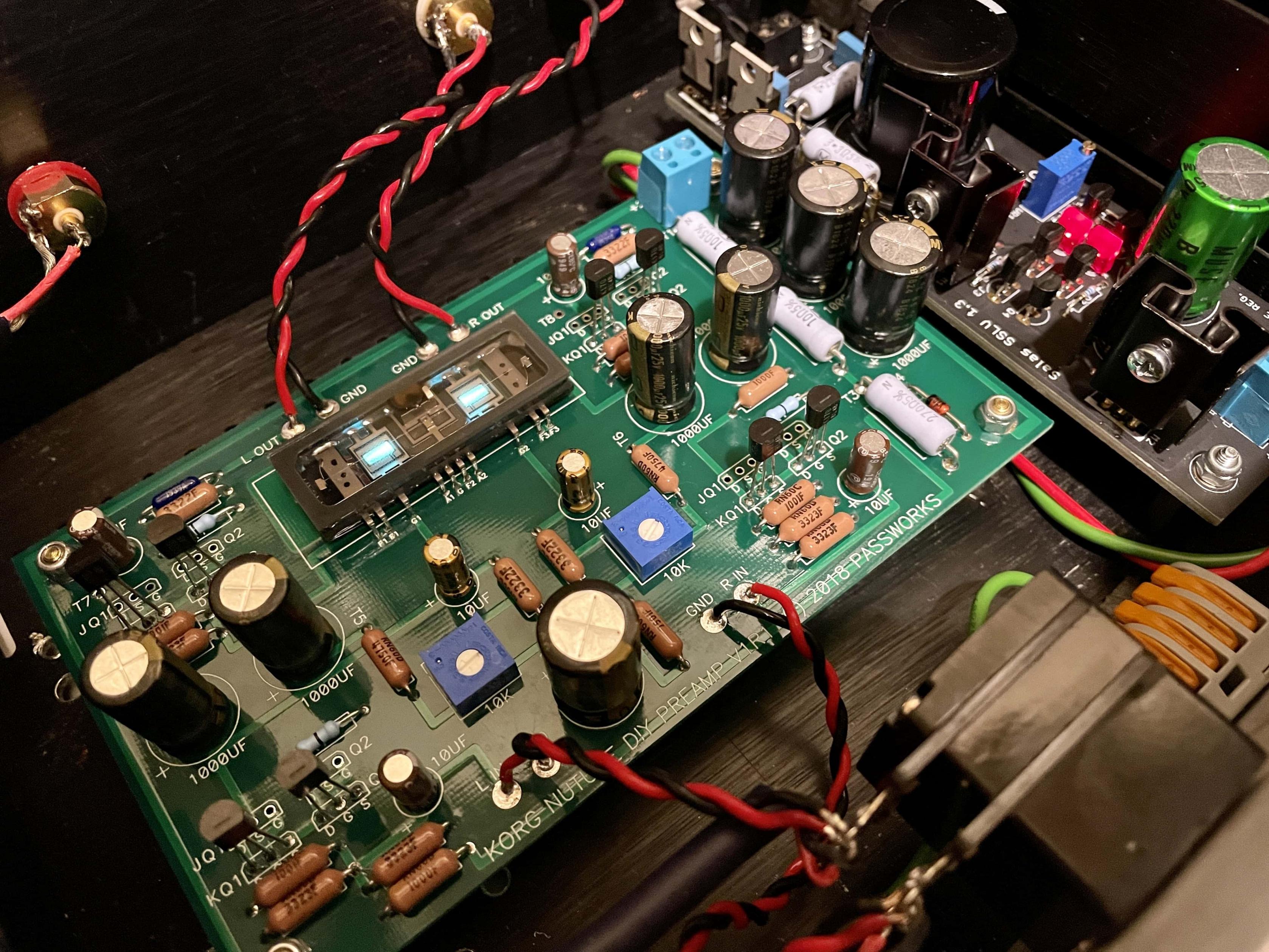

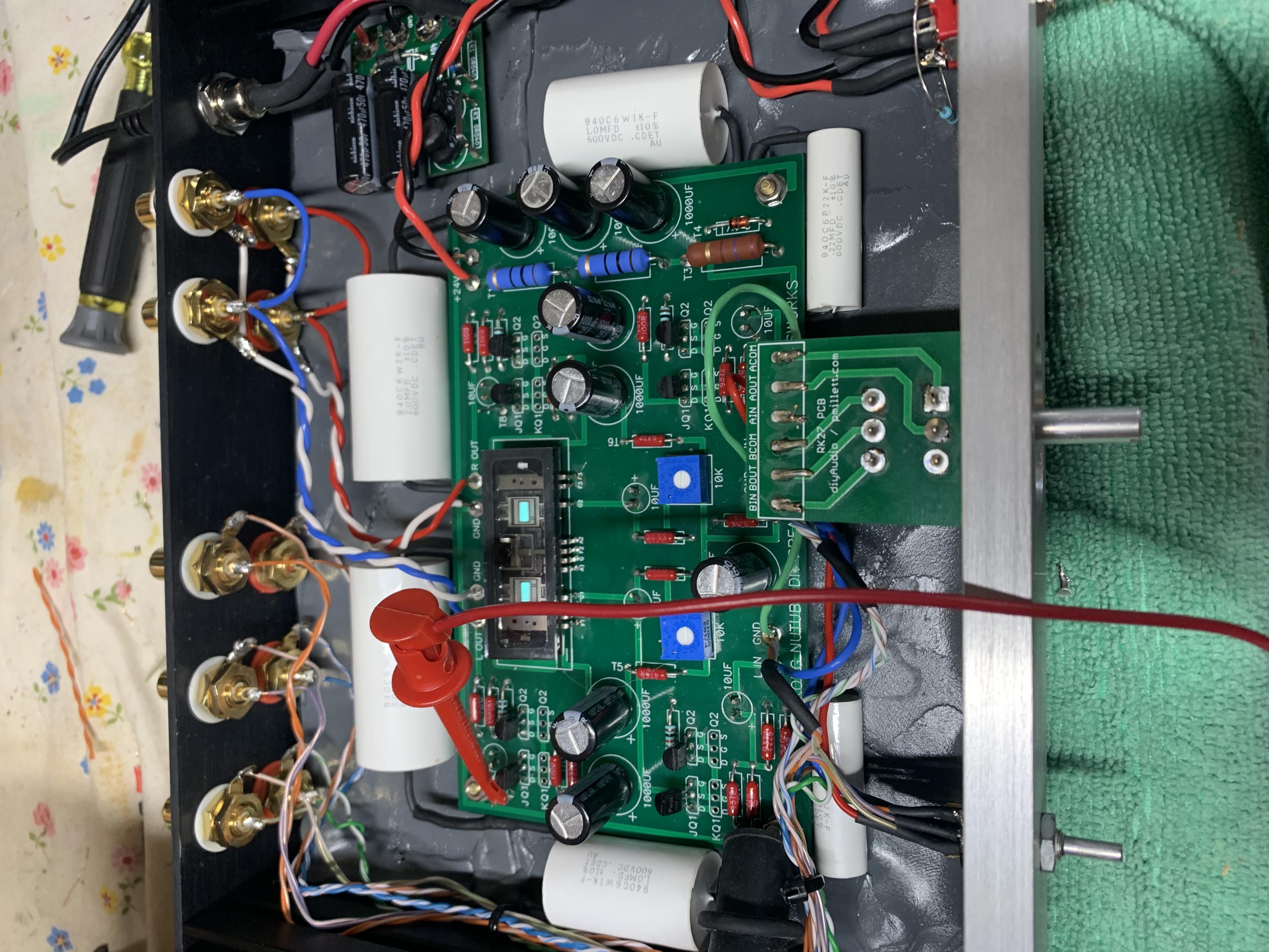

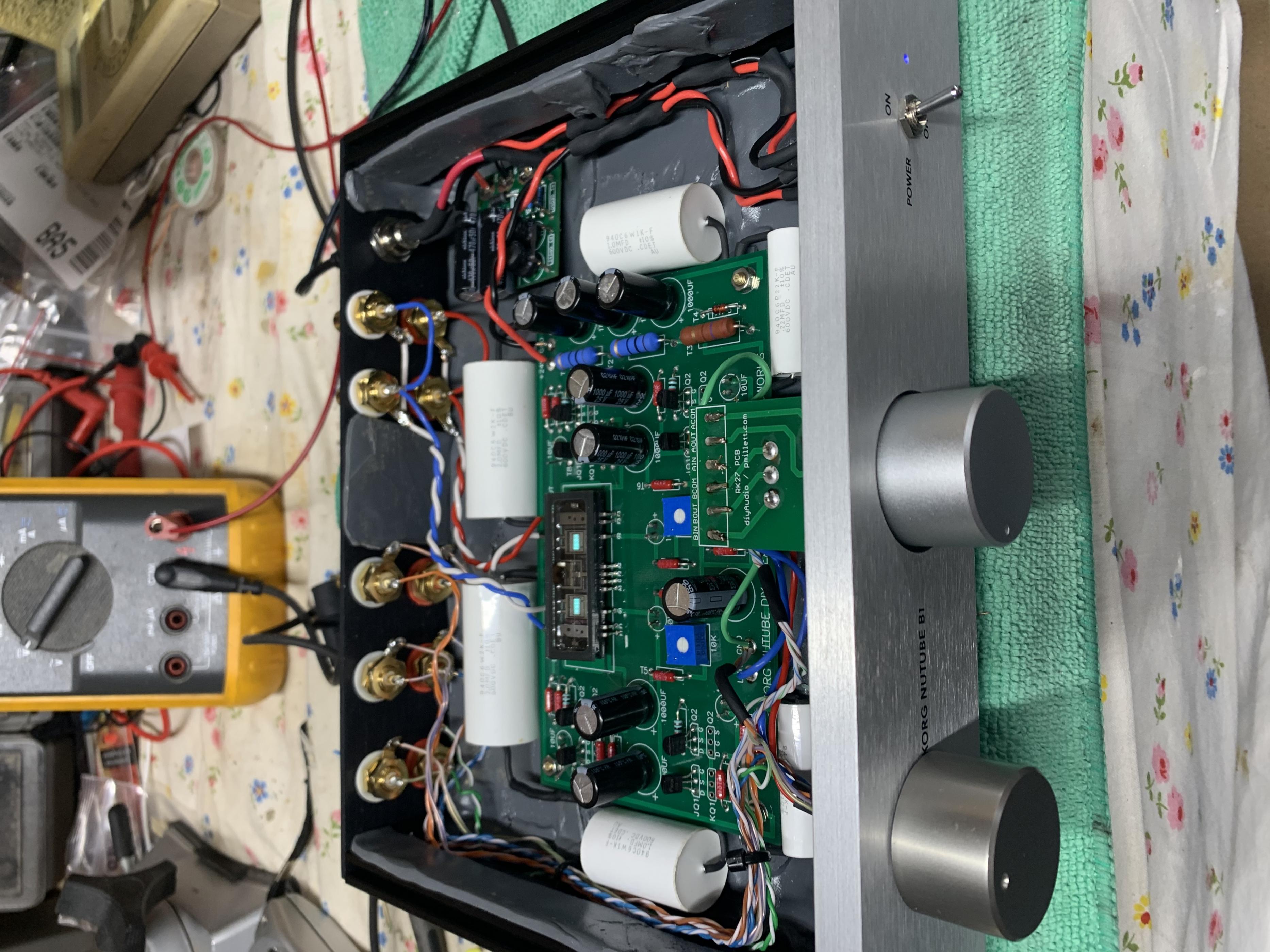

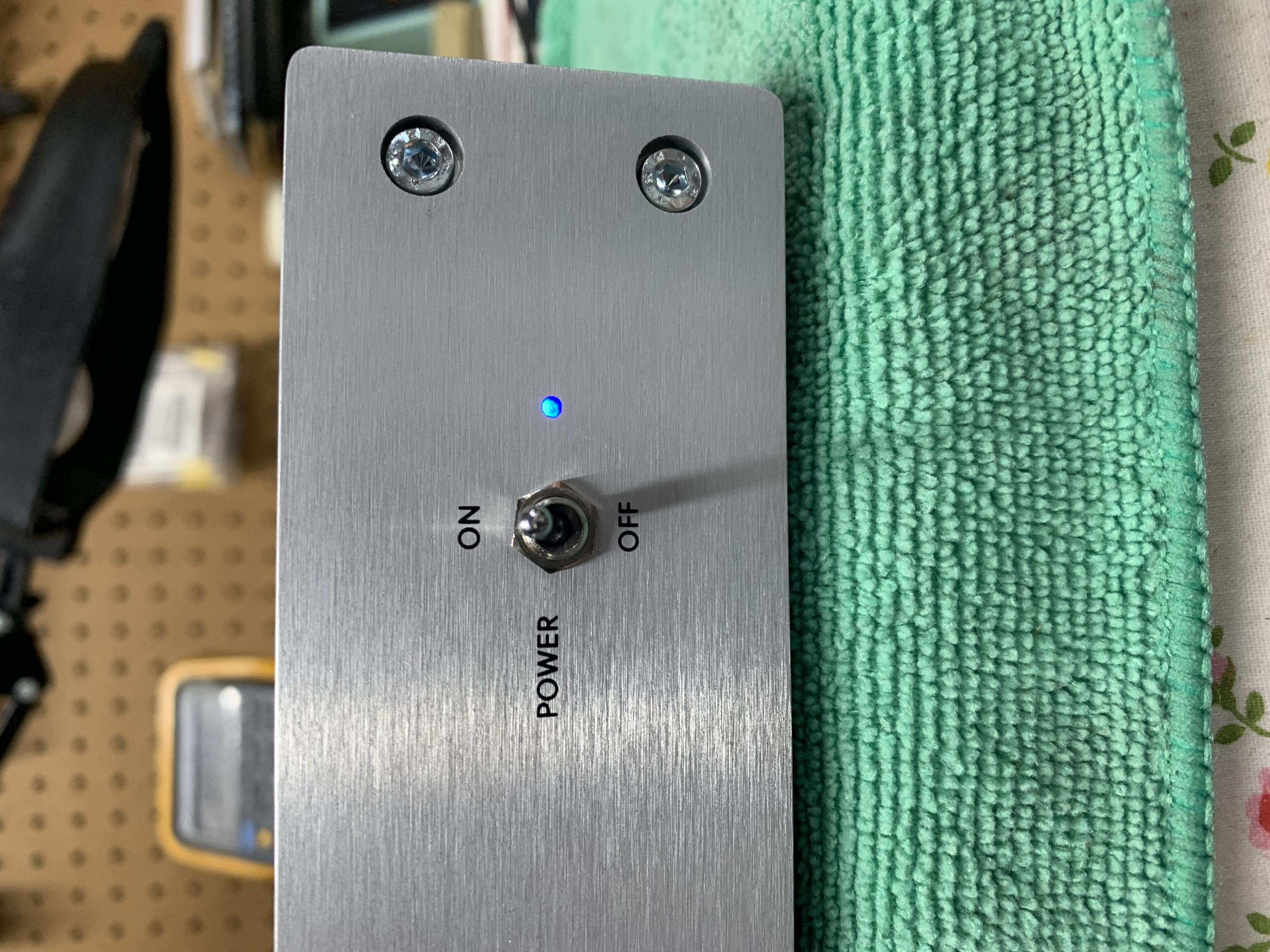

Just finished my Korg. 😀
All voltages are good and adjusted to 9.5v
Is there anything else I should be checking ?

I see you did not apply any anti-vibration materials to dampen microphonics. I'd reconsider that. Also when you first fire it up, keep your finger on the volume control because the microphonics are a form of feedback which can grow out of control (loud) pretty quickly. Turn things up slowly, test on different material, rinse and repeat until you've convinced yourself that at reasonable listening levels all is well.
Next, I seen that you've settled on 9.5v for the bias setting. I'd really encourage you to play around with the settings both above and below that while doing some listening tests. The holographic results are really striking while at the same time will really show you the practical affects. You never know, you might like 8.5v or 10v - depends on your personal setup, situation and preferences but thats half the magic of the DIY!

Before I buttoned it up I put the eraser on the tube, but I just set it there.
Should I use some type of adhesive ?
I have lined the case with "duct seal" to help deaden the box.
Music sounds great so far. Tried different music and all different volume levels with no ringing at all.
The only time I get "ringing" is when I switch sources and even then it only lasts for about 3-5 seconds. Is there anything I can do to prevent this ?

OK, OK...perhaps try to see if it is the cables that transmit the bad vibs from the selector or if it is the casing that transmits to the PCB.
I had a problem on the bench with a plastic on/off power switch, something I expected to be no issue and if ever then less brutal than the traditional metal toggle switches. I was wrong, made the Korg vibrate each time for a few sec, whereas the toggle switch helped getting rid of that... and it was just the power switch. Transmitted bad vibs through the tiny power cables.
Be it cables or casing, both can be damped... try putting your finger on either when selecting sources to see what affects what...
I hope this helps

That sounds similar to what I was experiencing - the board is coupled to the chassis. My chassis and amp are located a couple of feet from the speakers in my office. When you flip the switch, it vibrates the chassis, and in turn the circuit board and in turn the NuTube. Any vibrations induced into the chassis seem to be able to excite the NuTube, at least certain runs of it. The NuTube itself is physically coupled to the main board being soldered directly to it, and that board to the chassis via the stand-offs. The only way I was able to dampen the microphonics completely was through a combination of padding both above and below the NuTube as well as replacing the solid metal standoffs with the rubber ones I mentioned in a post above.
--Tom
I do have some of the rubber stand-off's coming so I will try that for sure.
How should I secure the eraser to the tube ?

To test it, painter's tape seems best so you can remote it. I used
use liquid silicone when you are satisfied and want a more permanent option, but 2-sided tape works too. Others have used foam that has sticky tape on one or both sides (i.e.: like door/window gasket foam).

I have the window seal foam between the board and the tube now
"Be it cables or casing, both can be damped"
How would i dampen the cables ?
I had no issues once I isolated the NuTube and main board (i.e.: did not have to dampen anything else).

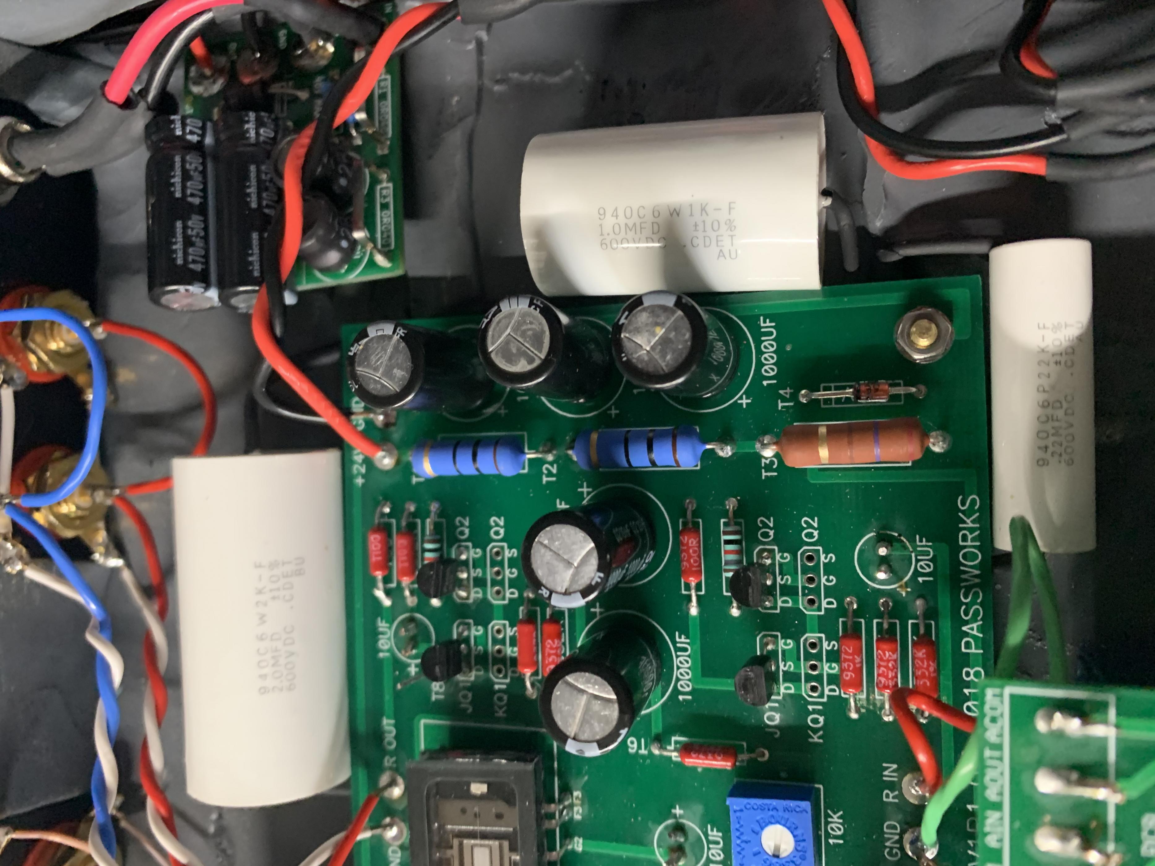

Congratulations Rtate enjoy the music
what checking..well the sound..
I am curious about reverse speakers phase effect
and after week or two maybe do simple experiment
and bypass all polypros caps with polarised 10uF Silmic II..
do You like it better bass without or with ?

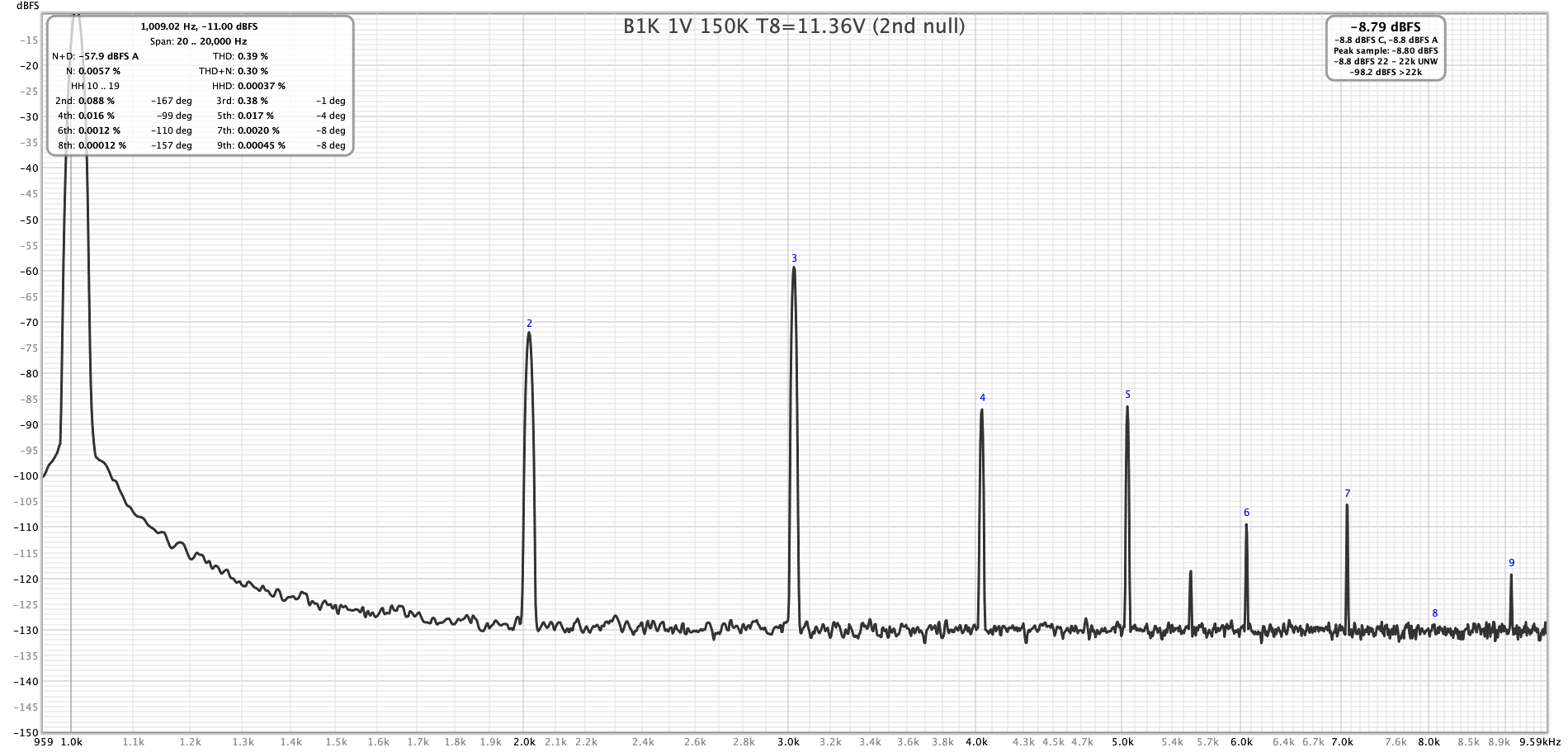

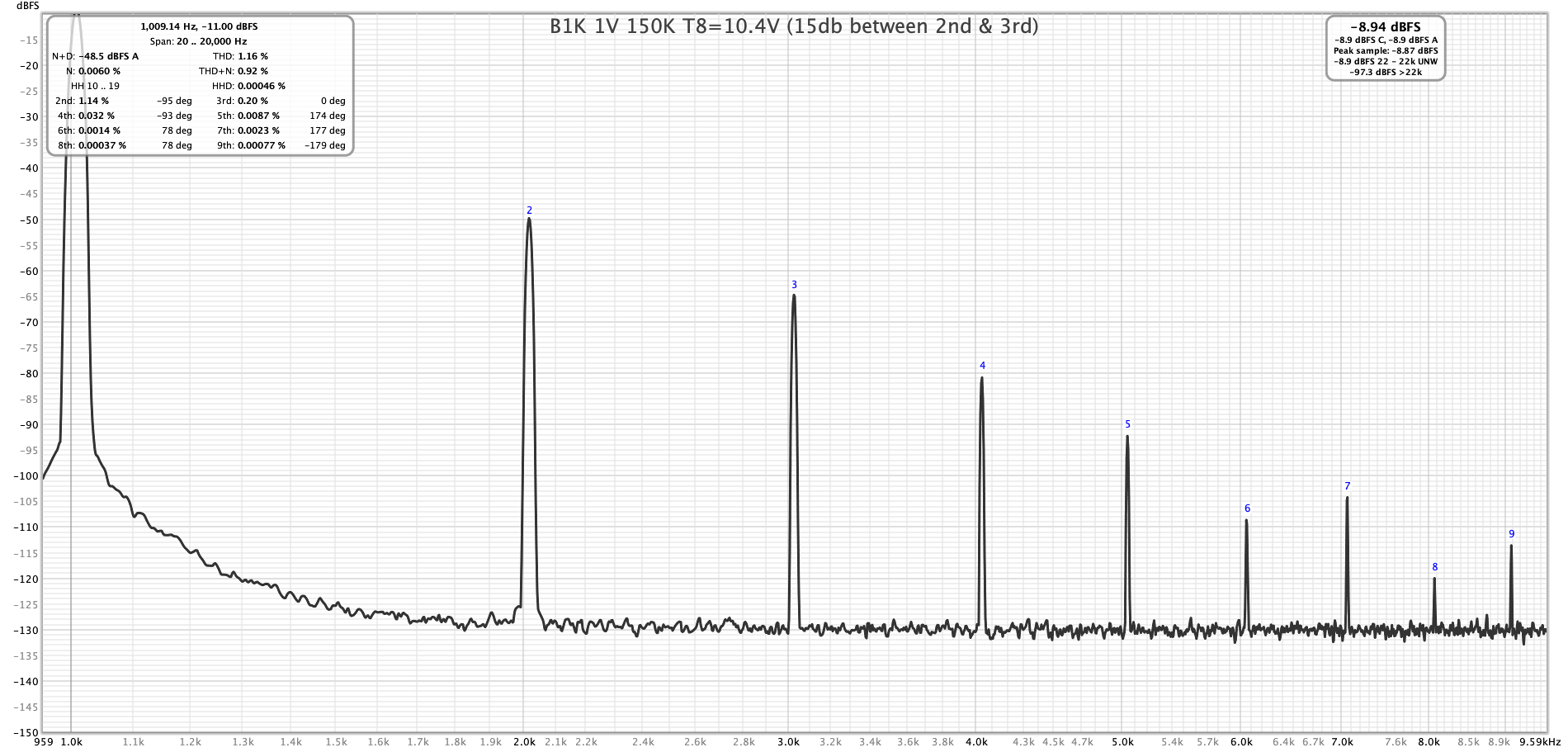

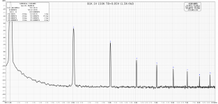

I finally got around to building the B1K. I'm really impressed! Most of my other preamp builds are in the .0X-.00X% thd range, so I was expecting the 1.5% B1K to be over the top. Not so. I played around with a few different distortion levels, but keep coming back to Nelson's prescribed settings (go figure 😀) I started out using the standard wallwart, but did see a noticeable improvement when I swapped it out for the Salas UltraBiB.
Attached are a few measurements – details are at top of images.

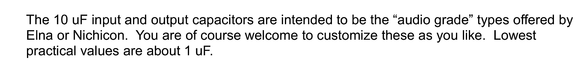

ok, so I have a question about the coupling film cap "break-in"
Can I just leave the preamp on for 100 hours or so to burn the caps in or do I have to have a source in putting a signal the entire time ?
Do I need the output connected as well ?
I could just leave a cd on repeat for days with the amp turned off if that would work ?
Honestly, if you probably just left it on (no signal) and connected to an amp you could probably break them in that way. If it's a film cap, likely less break in needed than an electrolytic. Or at least, less change in sound. There are some capacitor "break-in" devices that simply deliver AC through the cap and the voltage does not vary. So, it would be similar to this.
