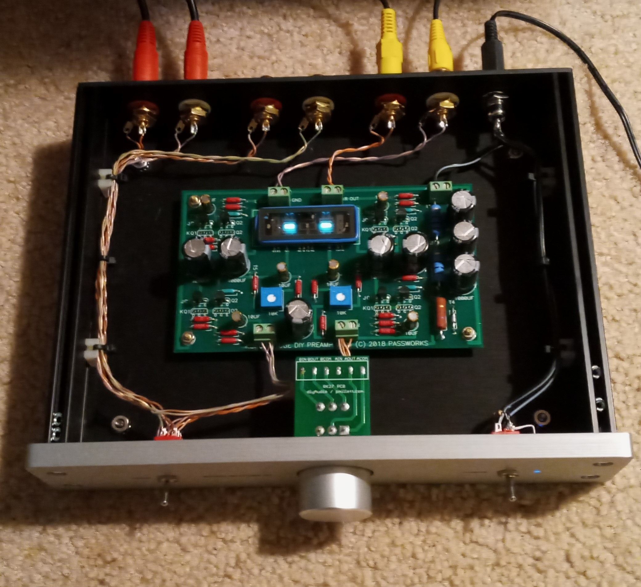

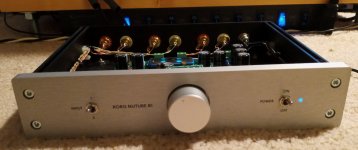

I bought the B1 Korg PCB and nutube a little while back not wanting to miss out on this little gem. When the Completer kit and chassis became available in the store again I said, "Why not? It'll be my birthday soon."
It was an absolute joy to build this kit. Thanks for the build guide 6L6!
So easy compared to all the design-the-case-from-scratch stuff I've done before this. Didn't even have to trouble-shoot, just checked voltages and was up and running. Got lucky and gain matches pretty well between channels. Tube is only slightly micro-phonic, mine only rings if chassis is bumped and damps out within a few seconds.
The only modifications I made to the kit where:
* Used terminal blocks to ease future mods.
* Used different 1000uF caps I had on hand.
* Deviated from the wiring diagram with twisted ground on each signal and starring the grounds at the board using my own teflon insulated cat5 and used larger gauge power wiring.
(I'm working on a wiring diagram of what I did if anyone is interested. Way easier to hook up than to to draw though. 🙄)
* And of coarse a blue LED with 2.2Mohm limiting resistor.
This amp is just what the M2 needed to attain a more balance tone.
I always loved the mids of the M2 but the B1K beefed up the low end and sweetened the sound.
I don't say where's the bass anymore. 🙂
Finding I prefer the negative phase H2. Still playing with how much H2, now at 1%.
This little amp is so cool. Thanks Pa and everyone at diyA that helped make this kit happen. I'm really happy with the results and enjoying the music it makes. 😀
