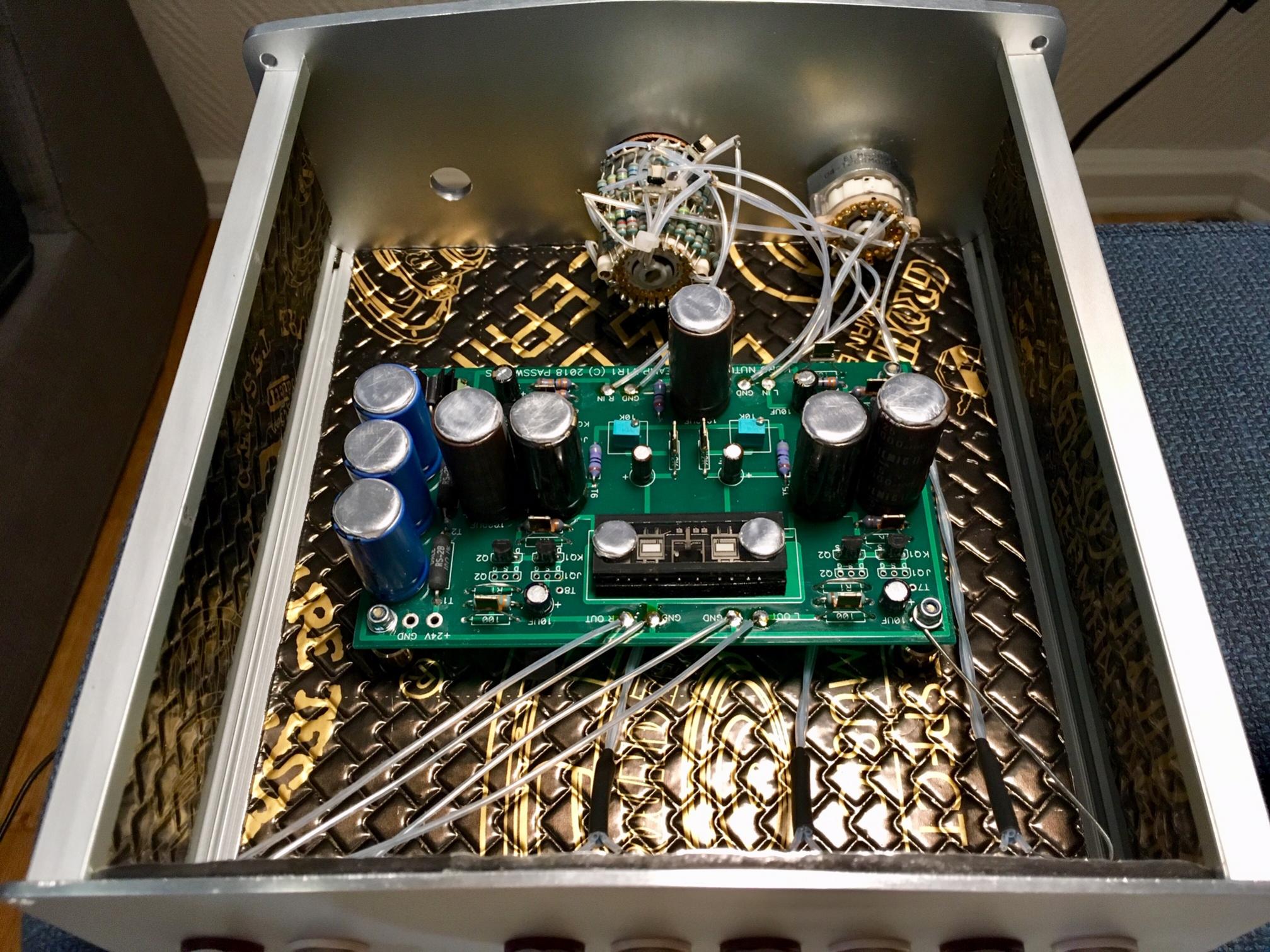

I used gorilla sticky double sided, to board then to ( I sliced the piece of foam the tube came with in half) foam, then used pressure to indent the tube into the foam and slobbered. Took additional piece of two faced and attached other side of tube. I also have, stud-1/2" sticky rubber-stud, for mounting to chassis.....chassis will be lined with dynOmat.
I solved all my microphonic issues and sudden bursts of noise by sandwiching the tube between pieces of "anti-slip" silicone pads sold as "earthquake" resistant slip mats from Daiso. I originally slipped a piece of this pad underneath the tube. It did not really stop the noise bursts. As a last ditch attempt I added a piece of the material to completely cover the glass upper surface of the tube. I have had no issues since. The Korg tube runs cool so the pad on the top surface will not result in an overheated device. I leave the preamp all the time.
I also made isolated nylon standoffs by cutting each in half and gluing a small piece of the earthquake resistant pad between the two halves. This is more complaint than using regular rubber isolating bushes.
You can source similar in your country. Cutting the material is a PIA.
google daiso earthquake resistant mat

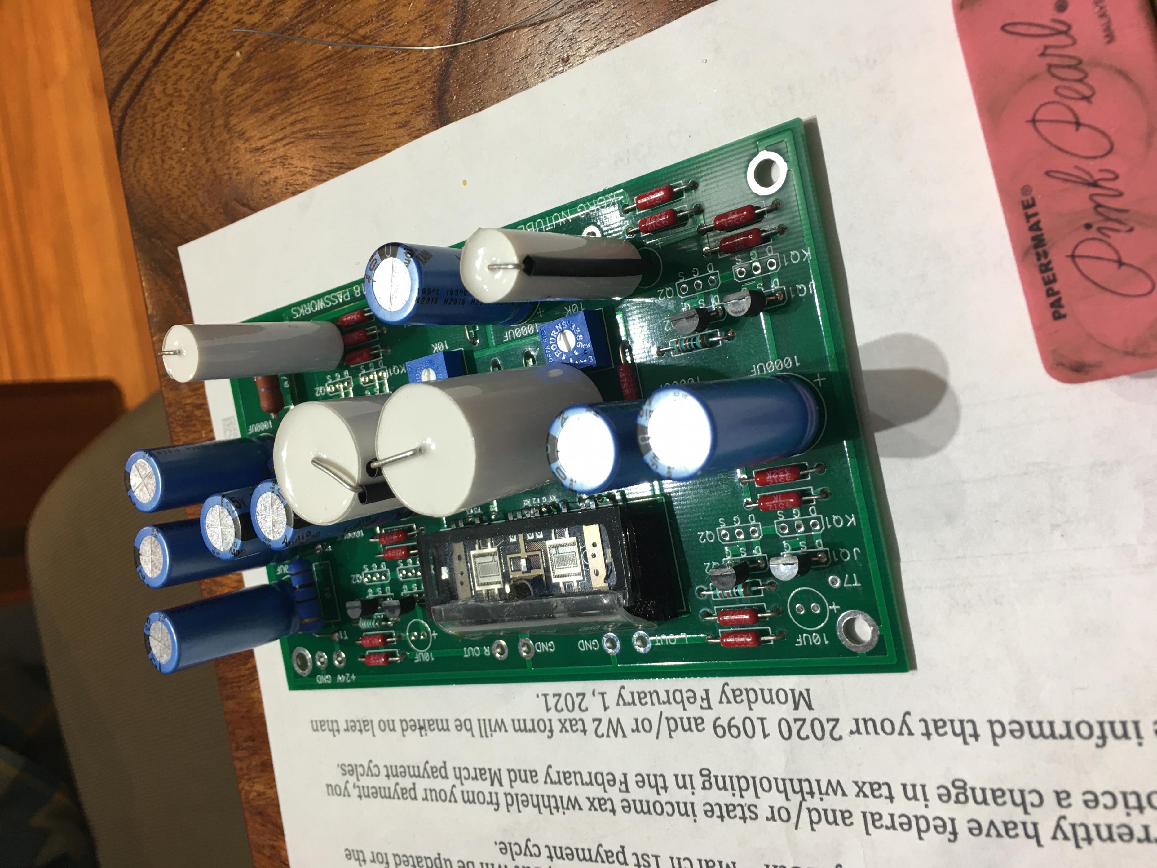

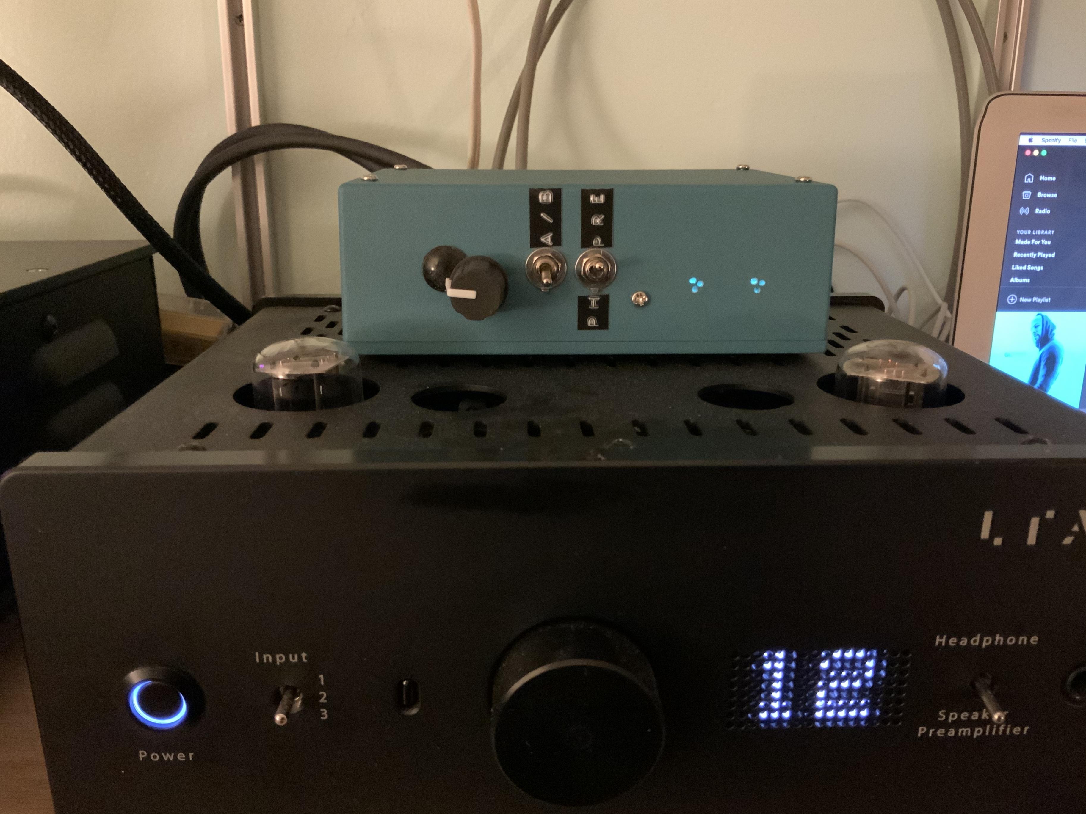

First diy build completed today.
I completed the build today, I was trying to fit it into a Hammond 1590J guitar pedal box, so it will go with my small system. The tube was lifted and facing the front, the six small holes let the light shines through, so I don't need a bright LED. Turned it on and it worked! This is my first diy project and it was easy enough to build and it sounds quite good compare to my other tube preamps. This can be my summer preamp when it's too hot to use real tubes. Very happy with the outcome! 🙂
Thinking about trying better components like potentiometer, capacitors and power supply later. I am thinking about trying the F6 build, but not sure how to figure out the psu.

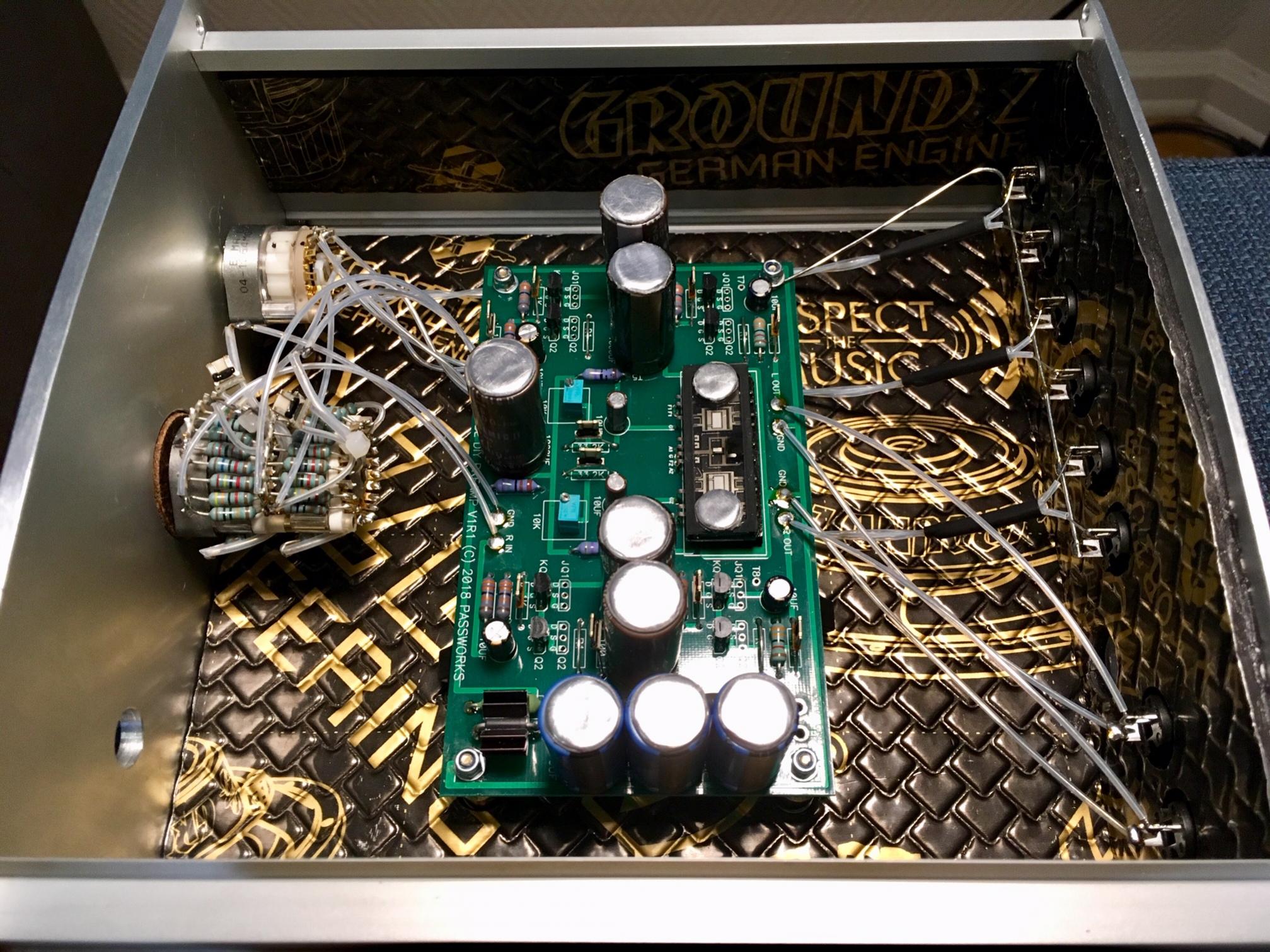

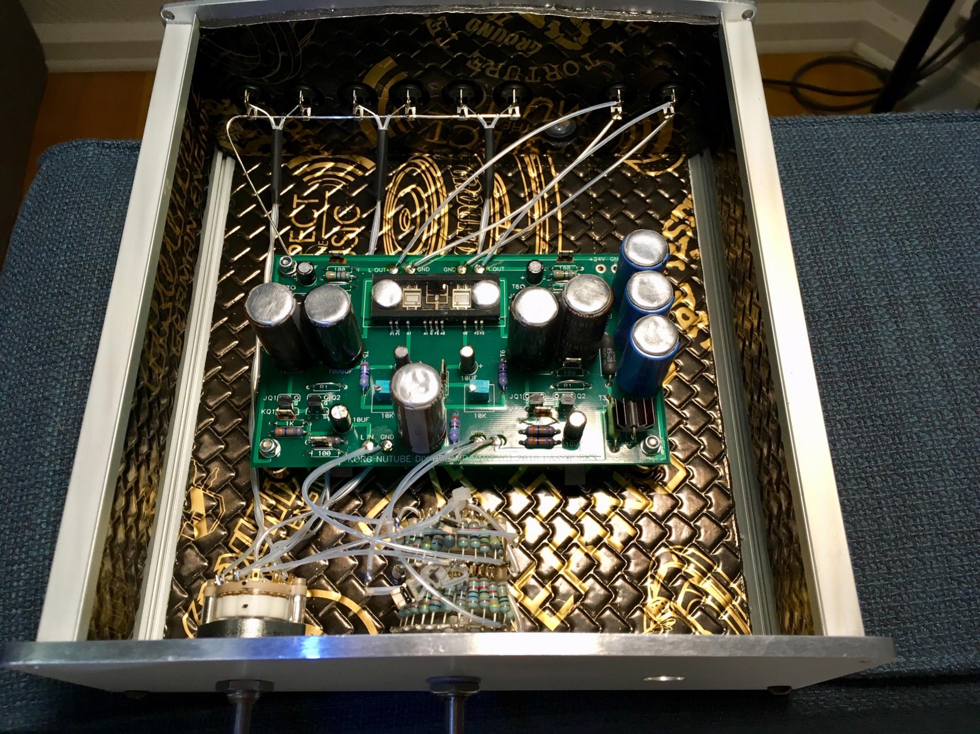

Sagen - Beautiful. Love the matting idea. Nice!
