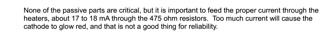

I could use a little help. The 270 ohm 3W watt resistor is hot to touch after 30 seconds. None of the other components are a little warm. After about 30 minutes, the Zener Diode is getting a little warm.
I am listening to the B1K four about 45 minutes, and both channels sound great! Here are the measurements:
T1 = 23.88v
T2 = 23.06v
T3 = 22.24v
T4 = 8.69v (should be closer to 9.1v ?)
T5 = 0.564v (should this be closer to 0.6v, like the other channel T6?)
T6 = 0.602v
T7 = 10.01v (after adjusting the 10k trimmer)
T8 = 10.02v (after adjusting the 10k trimmer)
The PCB is drawing 82.16 mA and is stable. Measured is without the power LED in the circuit.
The voltage across the 270 ohm 3W resistor is 13.57v
I lifted one end of the 270 ohm 3W resistor and measured 268.4 ohms
The current going into the PCB without 270-ohm resister is 31.33 mV
My first thought was one of the capacitors had its polarity reversed, but they all visually check out OK with the black stripe being opposite + sign on the PCB. I had also double checked them before soldering.
I took multiple resistance measurements between the left and the right channel with the power disconnected, and they appear to match. I am just trying to find out in one channel is different than the other.
I ran a 1 kHz sine wave through each channel, and on a pocket digital oscilloscope, the wave looks smooth and symmetric.
I did try to follow the build guide. For Step 43 PSU test, I got about 8.8v (sorry did write it down at the time). I noticed 207ohm 3W resister was warm then, but I thought it was because there was no load on the Zener Diode.
Then I check the BOM versus the parts I received from Digikey, and all of them matched. I also checked the resistors being the correct location vs. Nelson's document. For my 1000uf caps, I am using Nichicon UKA1E102MPD1TD (Digikey 493-4648-1-ND). I read somewhere on DIYAudio.com they were a better grade for audio and had the 5.0mm lead spacing.
FYI, I order my parts from Digikey rather than buying the completion kit. I had many parts (switches, RCA jacks, power supply, ALPs pot, standoff, etc.). I have made mistakes building stuff before, but this is the first time I haven't been able to find my mistake.
I will order a new Zener and 270 ohm 3W resistor and see if I can get closer to 9.1.
Any ideas on what to check?
Thanks, Tom

I will order a new Zener and 270 ohm 3W resistor..
If you can buy similar size 270R resistor then 5 Watts run cooler.
All voltages with - or + 0.5V tolerance are OK.
Best way to get close the same voltages values is precisely matched, tested the same resistors values on both channels.
🙂Just for perfectionist better sleep.
With use of 1% resistors tolerance you are good anyways without matching.
Edit: From Mr. Pass article the most important is 475R pair
with this two resistors heaters current adjustement is possible.
Have a nice day

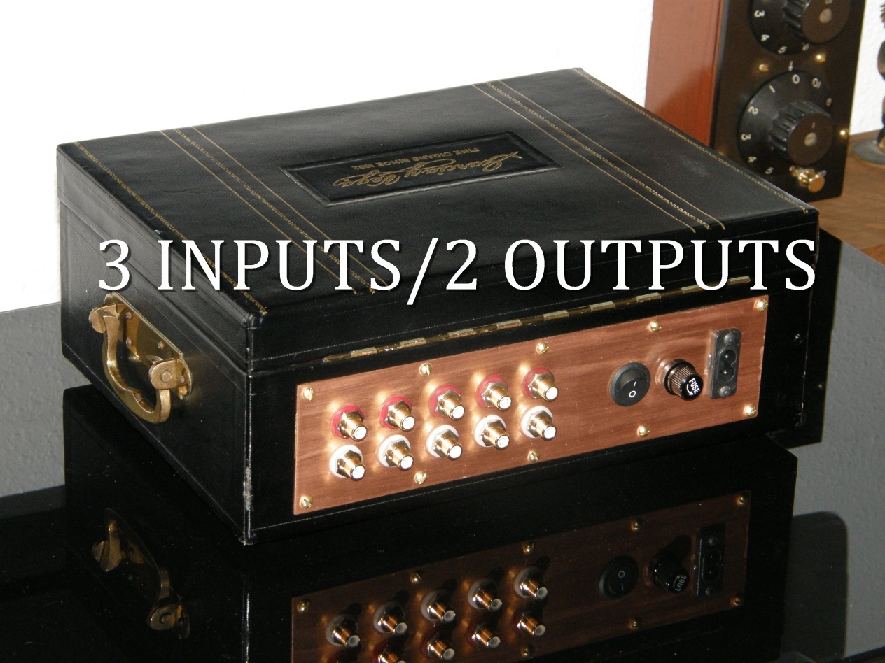

If I am lucky, I will successfully load a photo of my Korg project. The installation process was challenging since I am using an expensive cigar box that is covered in black leather.

That is totally awesome!!! I’m inspired.
