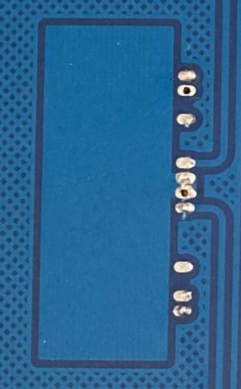

good eye, but that back photo I just took when the tube is desoldered. All solder joints are ok for sure, for me soldering itself is kinda OCD process 🙂. At least something I know how to do in our hobby hehe.
I thought that it was just me but YAH, I have some doubts about at least two of the pins shown. In my project, I soldered every pin through and through.
The tube could also be defective when talking about the micro-phonics. I know that this seems counterintuitive, yet I wonder if all that isolation padding is too much. I have made a few of these projects, and have tried different isolation. I found that the double stick tape is hard to beat.
Lastly, I can understand the frustration that you may have with what seemed to be a straightforward project. I still have an old project on the shelf that didn't obey.

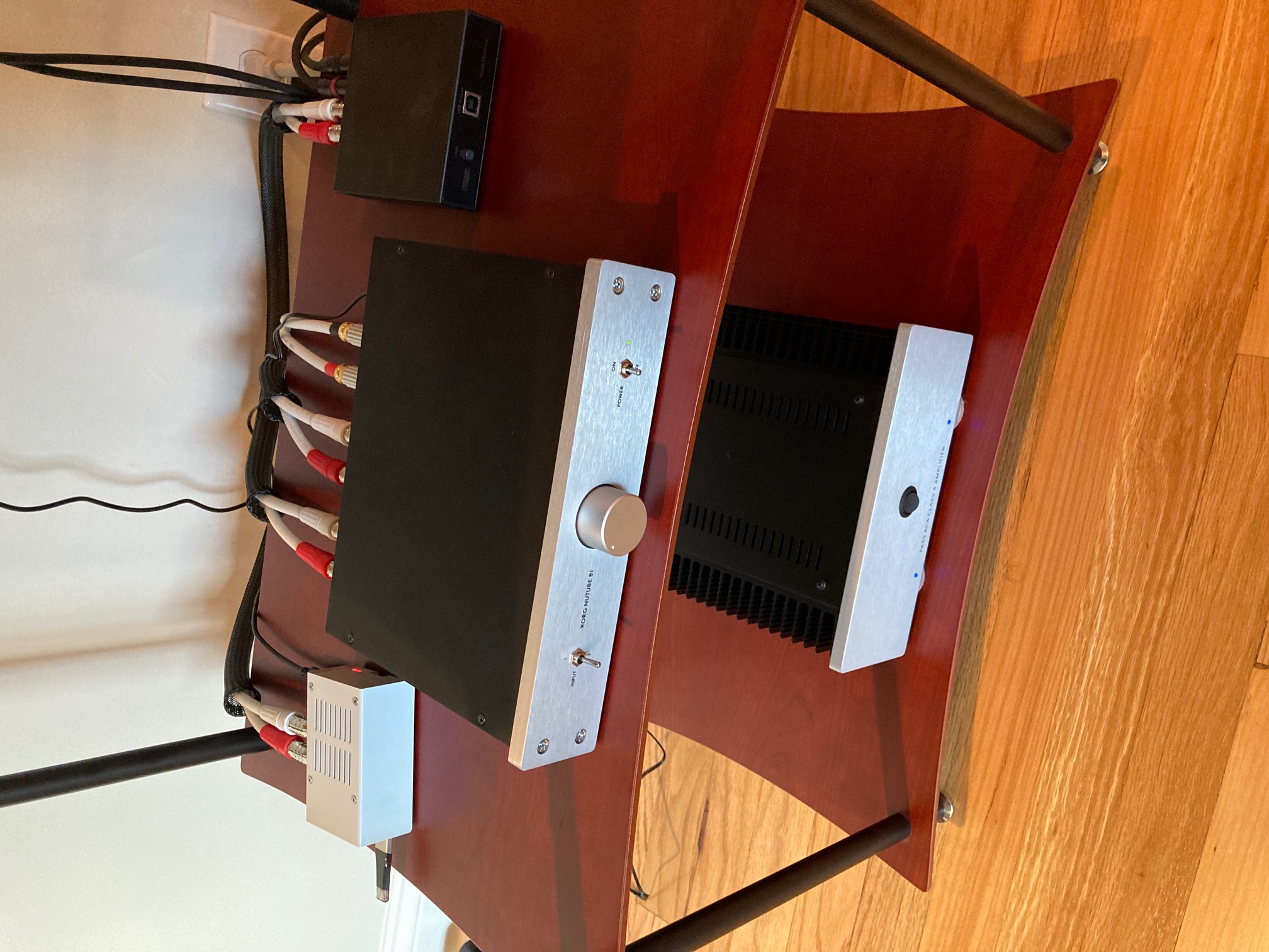

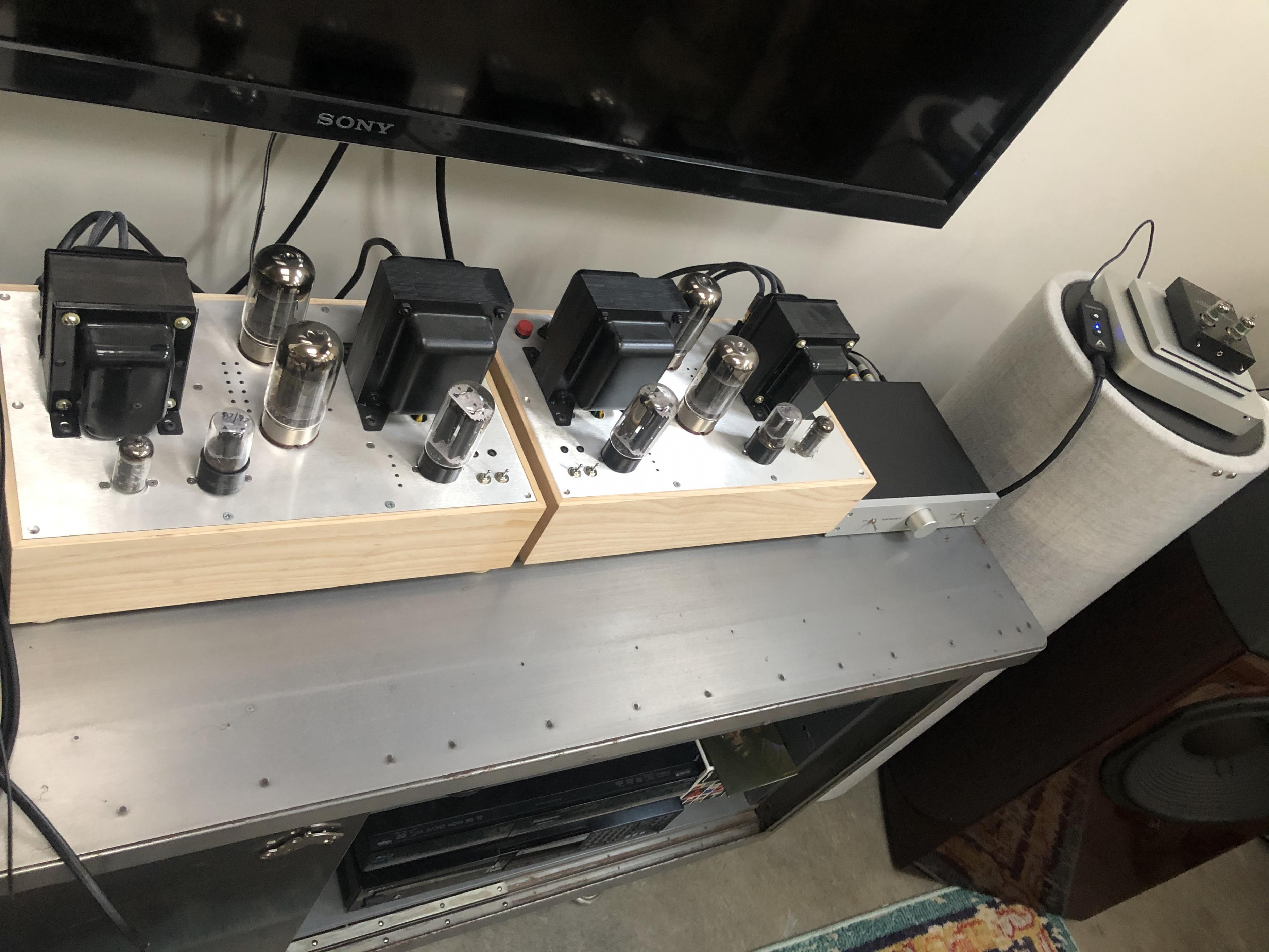

Hi Folks, long time reader--first time poster. Just jumping in to report another successful Nutube B1 Buffer completion kit is in the books:
Here it is with the most recent power amps I built, the Randall Museum 6550 DIY monoblocks that are driving the JBL Array 1400's just out of sight. My initial bias setting on T7 and T8 is rock solid at 9.5v and I love what I'm hearing! I'll try my ACA monoblocks next as well as a higher-powered Sony N80es solid state amp that's waiting in the wings.
I initially had a nasty hum with the Mac Mini as the digital source. I traced the problem to the HDMI output to the flat panel display. Removal of the HDMI cable solved this issue. All hum is gone. Who needs a screen when it sounds this good! I set up remote access to control the mini so I don't need the HDMI cable while cranking up the tunes.
Thank you DIY Audio community. Thank you for the build guide 6L6. Last but not least... Thank you Nelson Pass!

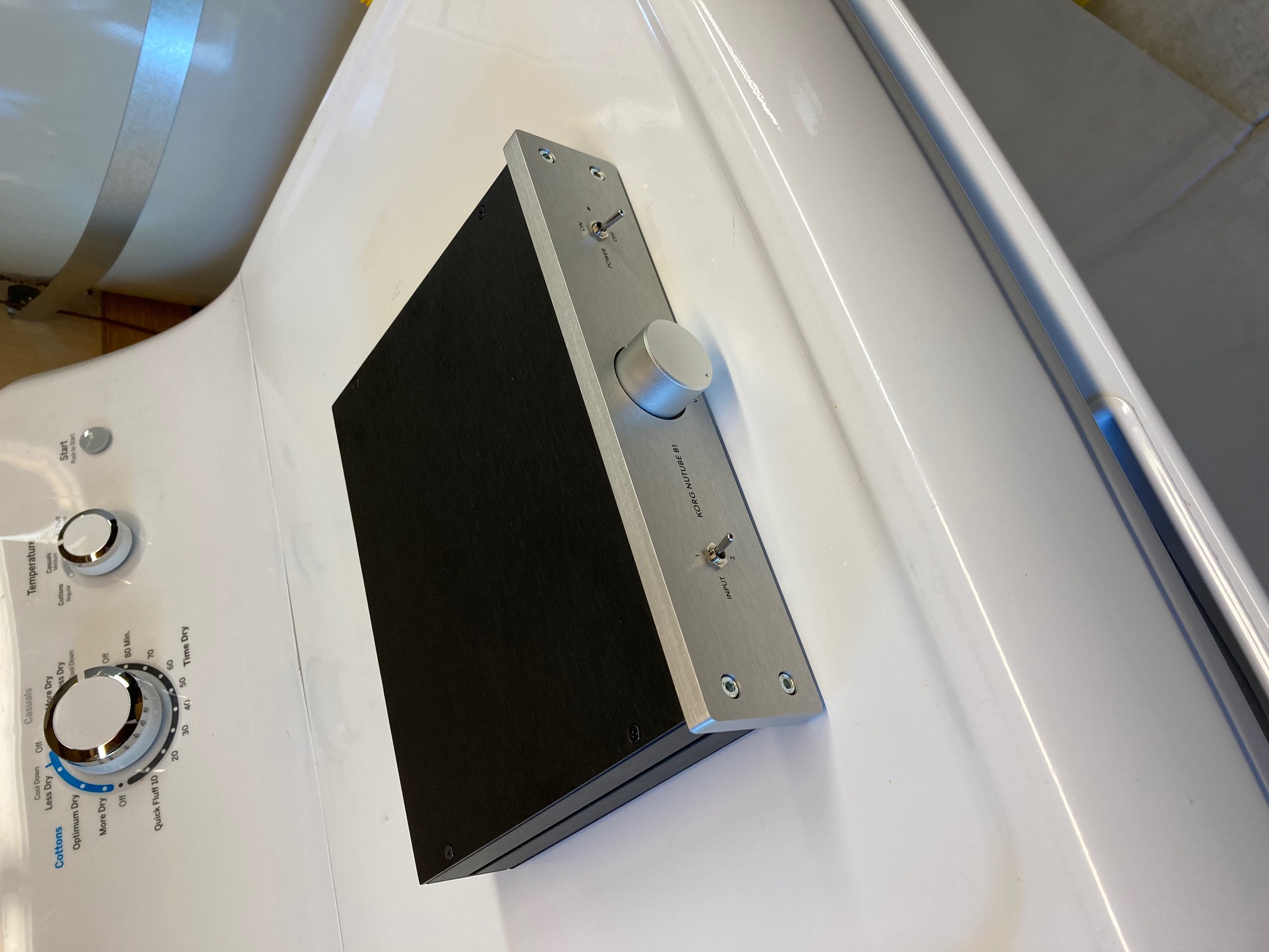

Another brand new B1k
Another brand new B1k working fine.
Thank you everybody and Mr Pass in particular.
The online guide works great; I did the job without any doubt.
I think the added gain also helps my ACA amp: I got improved bass extension from my small monitors with Fostex 85wk!

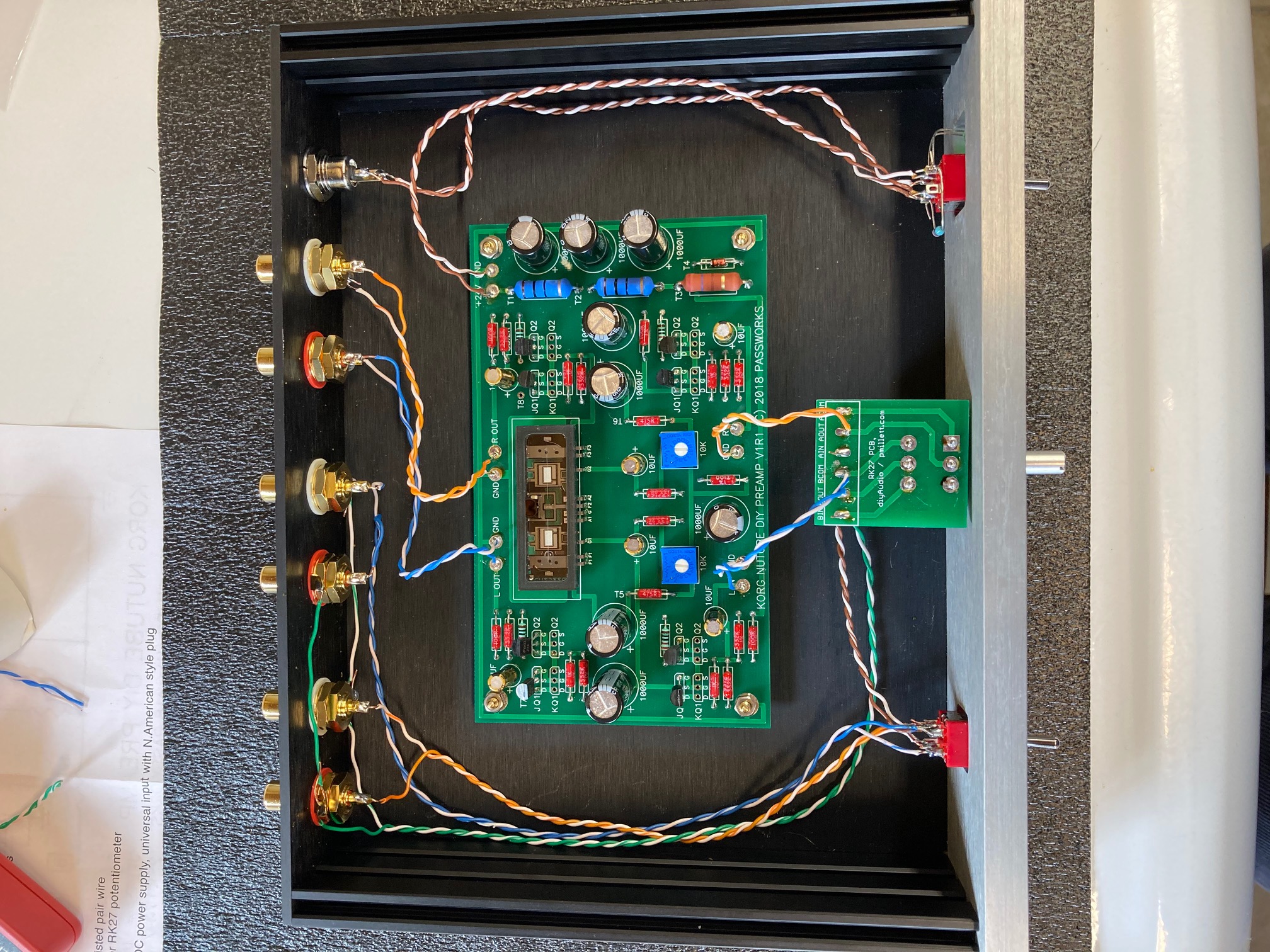

Hi, happy to report yet another successful Korg NuTube B1 build from the diyAudio kit. Thank you 6L6 for the build guide, and Mr. Pass for the wonderful design! It's in my system now being fed by a Raspberry Pi with a HiFiBerry DAC and in turn feeding an ACA and Klipsch RP 150M speakers. If anything it seems brighter, maybe deeper and more precise soundstage than without a preamp? I wouldn't have thought that possible in this system but the ACA may have been a bit starved. No microphonics either except when flipping the input source switch.
