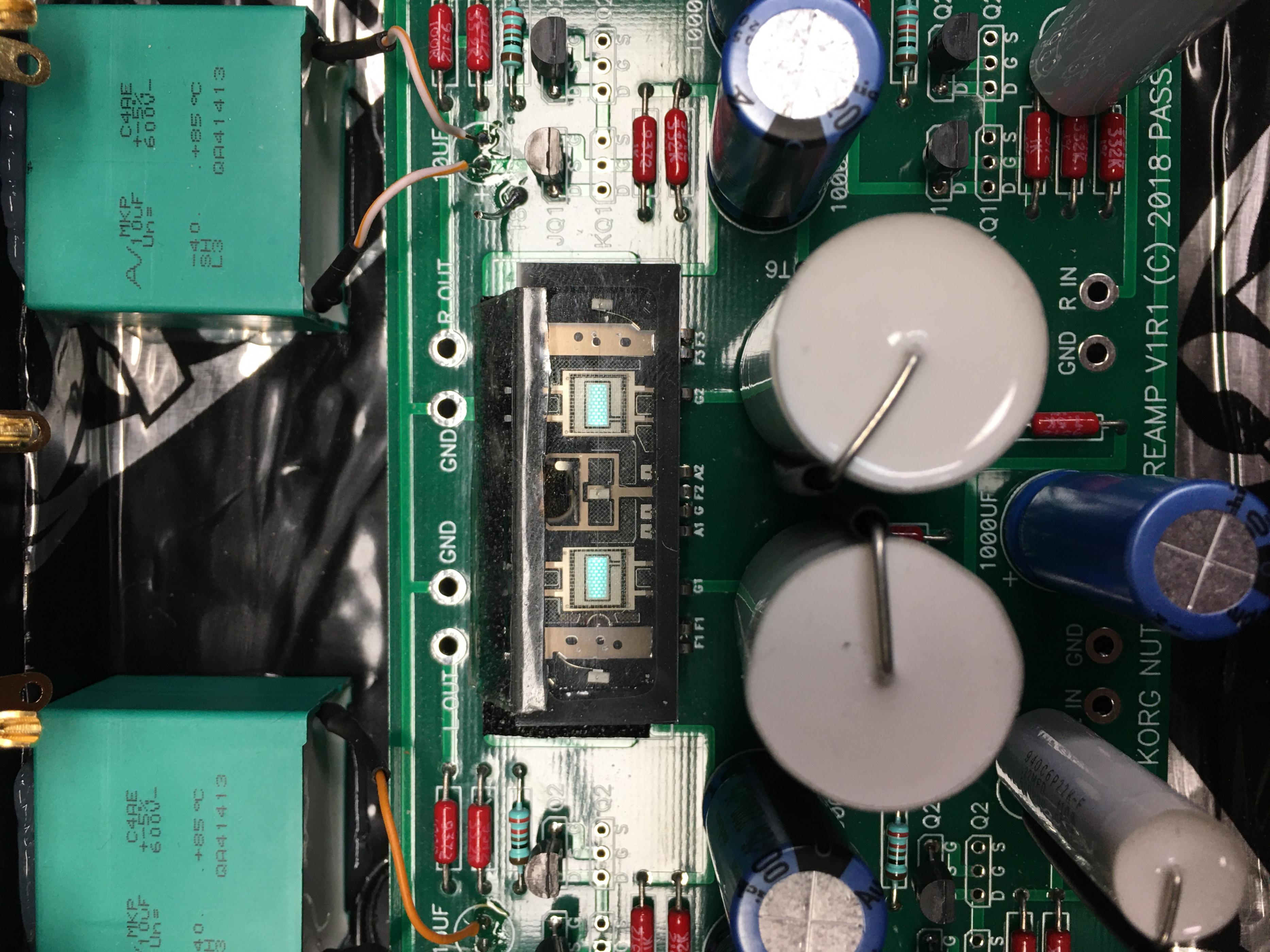

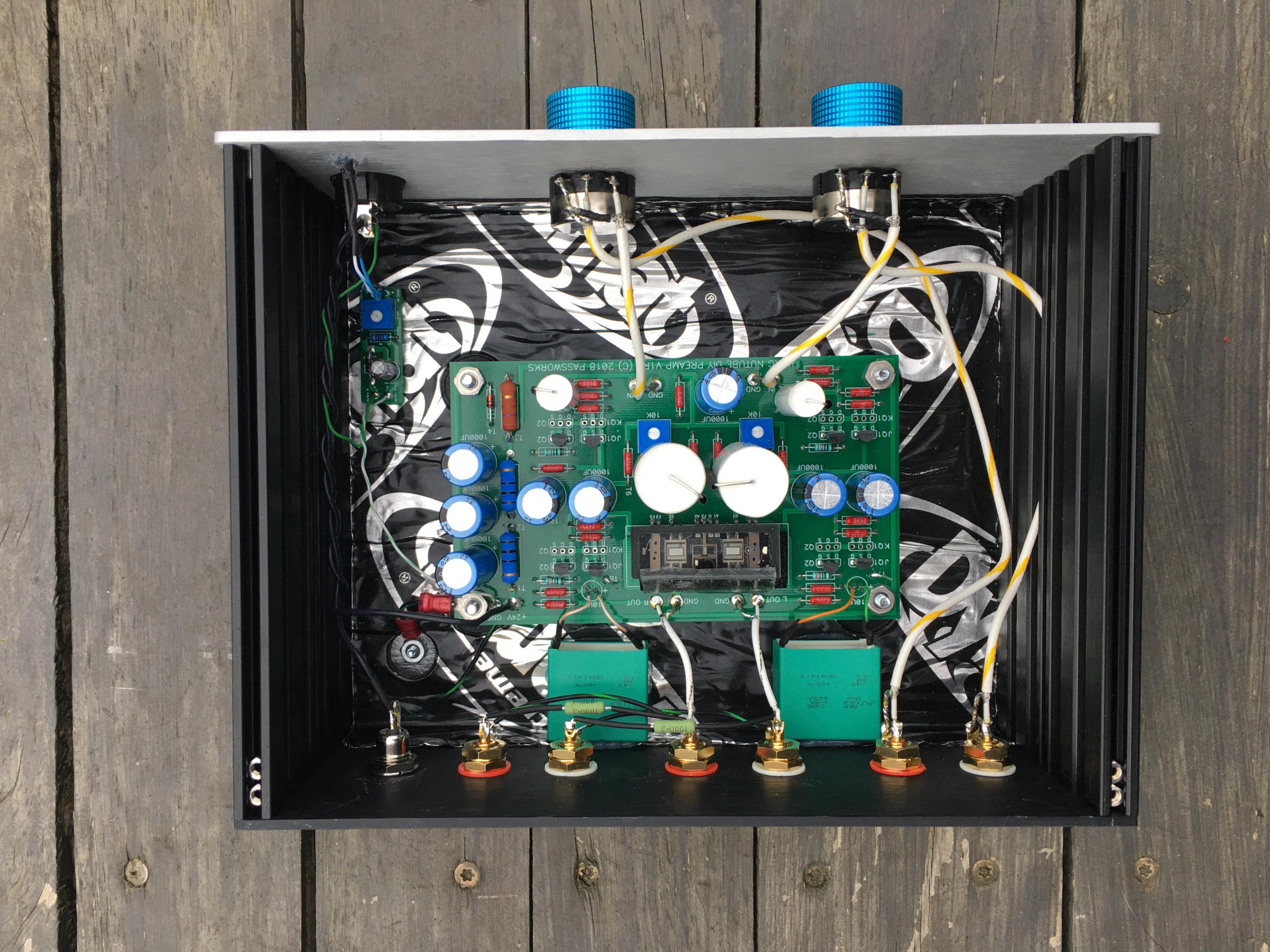

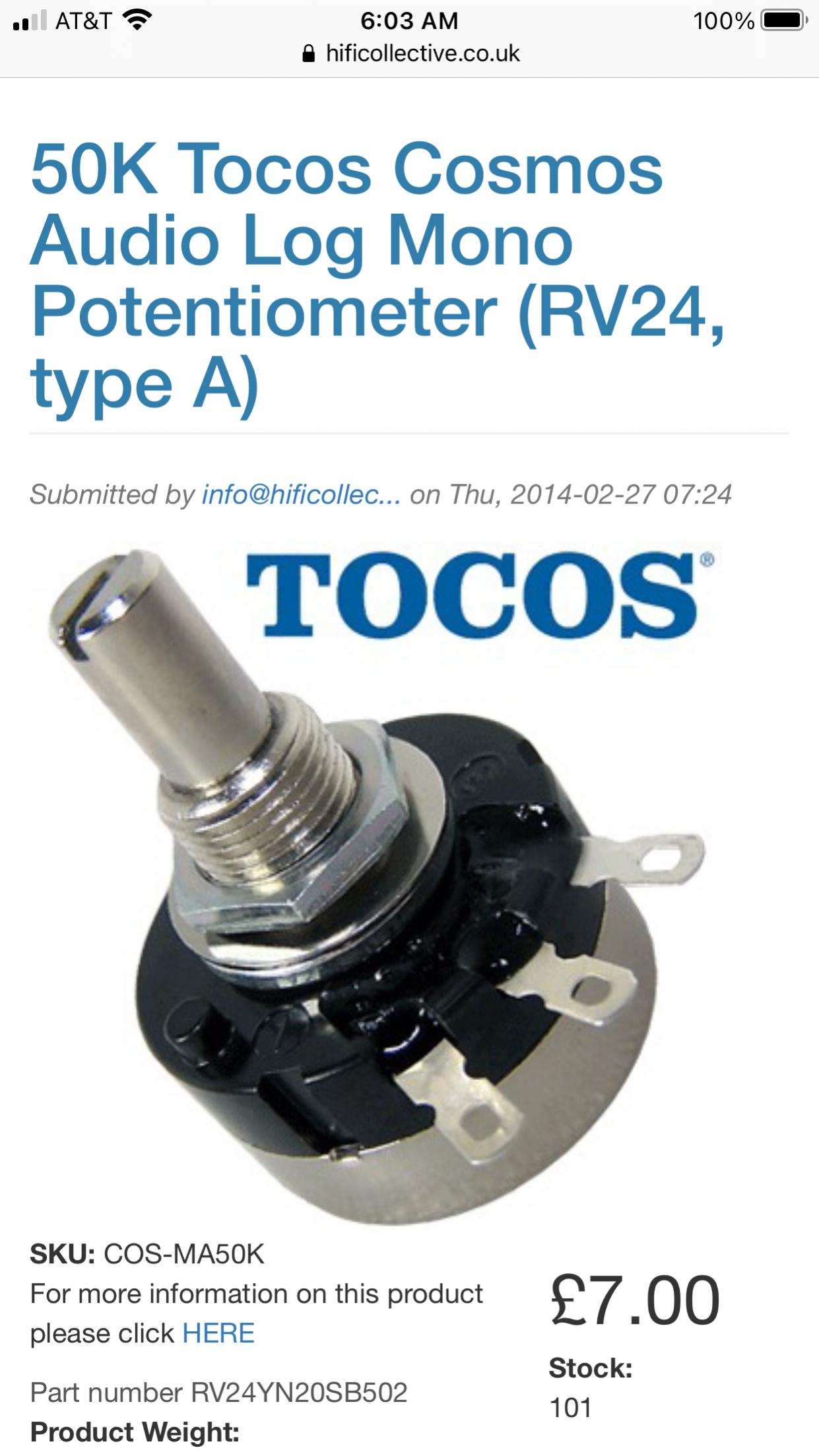

The B1 sprung to life....with force! All voltages were spot on. Quiet as a mouse..the only issue is you just barely turn the potentiometer and POW..way to much volume....but it sounds good. I gotta start reading about what it takes to change this sensitive pot. I’m open to any suggestions.
Good grief. I went all over that page and overlooked the numbers every time. Thank you for pointing out the obvious.
Monk55
If your pots are linear taper they will be too hot in the first part of their rotation.
Congratulations 🙂The B1 sprung to life....I’m open to any suggestions.

Monk55
I thought about that but I remember ordering Log pots specifically. I’m checking now. Thanks for the reply’s!!
