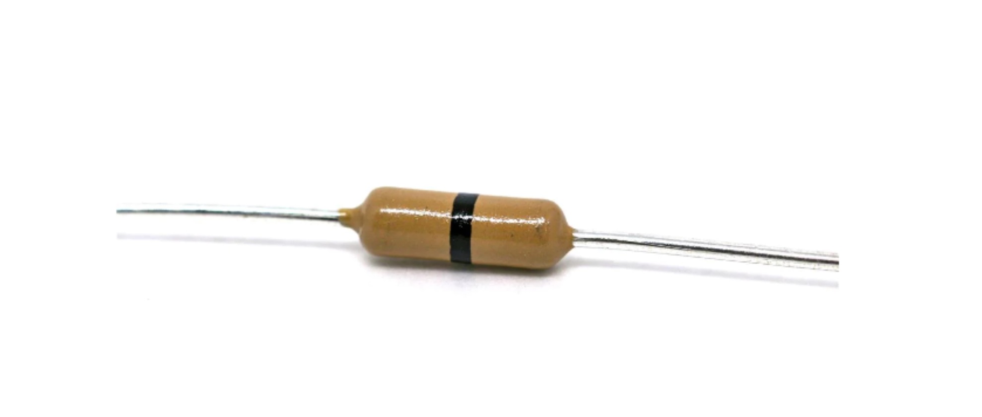

GLOL!
Didn't know such thing would exist!!!
You made my day
@ ClaudeG
In the past I repair music synthetizer rack and find on the pcb this type of enigmatic components.
Lesson lear this was 0 Ohms resistors.
Some time if current is high , ceramic around wire dissipate portion of the heat.
B1 K current is tiny..

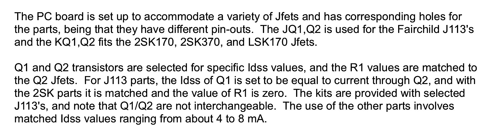

See inside of the extract from original Mr. Pass article :)
