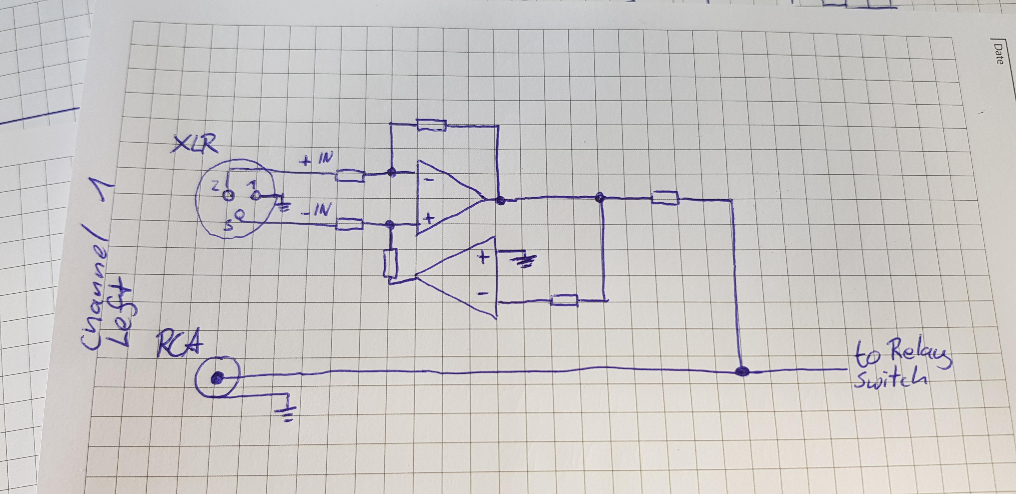

two-way local selector per each input (choosing either Bal or SE) , then main SE 5way selector, feeding KB1?
yes
If I got you right you mean I need to have a physical switch to select between SE and BAL and so my actual idea would not work?
I made a quick handdrawn schematic for clarification below. Again all the credits for this circuit go to Rod Elliott as linked in the last post.

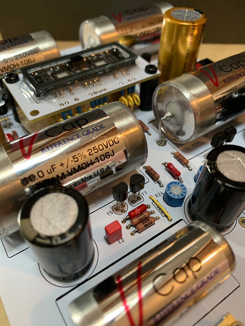

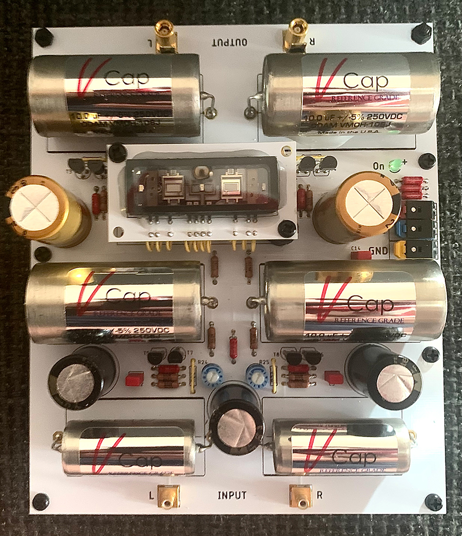

my new nutube preamp
Hello,
my first nutube i built has based on the original board from diy audio shop.
I have also presented the preamp here, with chassis and external power supply.
you can see in posts #4833, #4874 and #4878

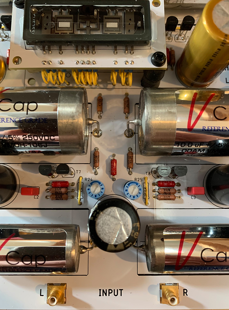

The good result has made me think about a new, own construction.

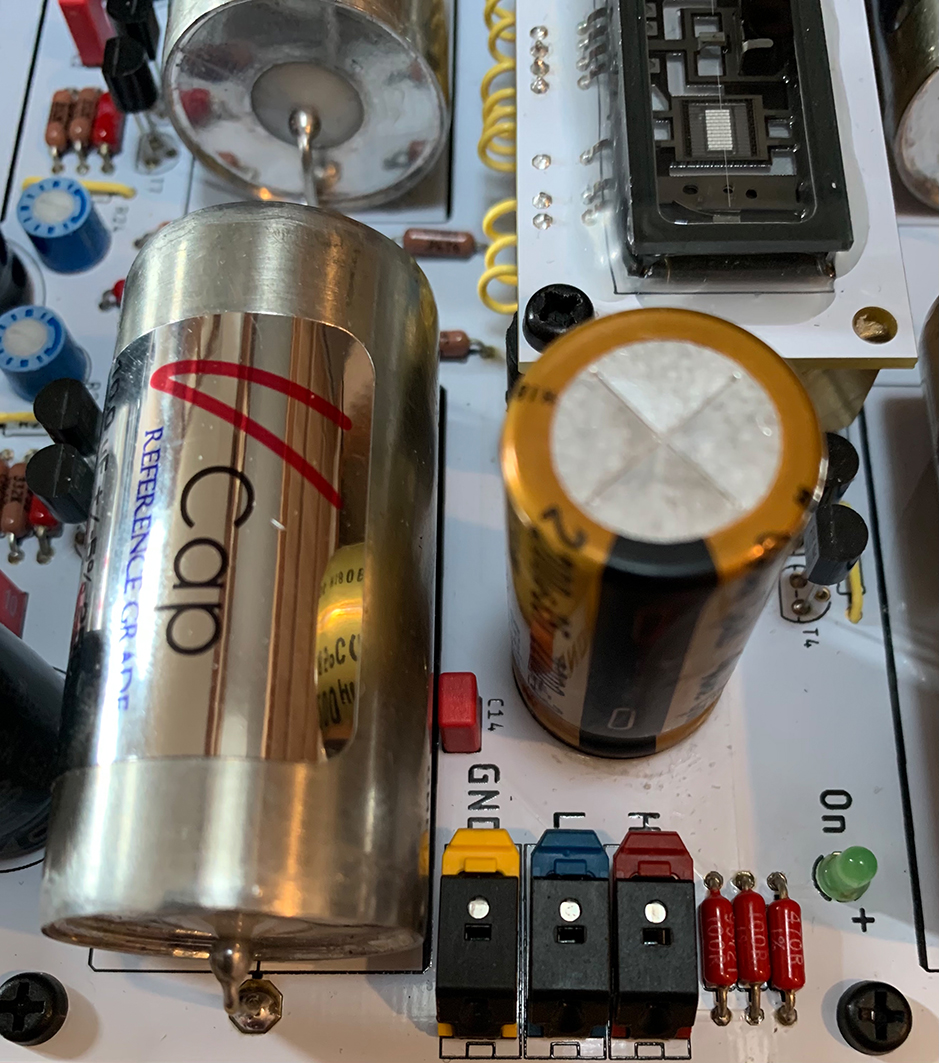

Matched 2sk170 jfets should be used, as well as better capacitors (V-Cap Odam many thanks to chris venhaus for the good advice and the ingenious capacitors, also Black Gate Capacitors), a vibration-optimized installation of the nutube, and an even better power supply, for 24V and 9.1V version as shunt power supply and adjustable. My friend marc then converted my ideas and component specifications into a very nice circuit board. He also planned the shunt power supply for me and designed the boards. thank you for that.

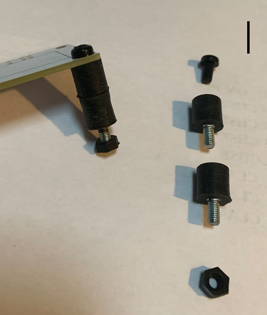

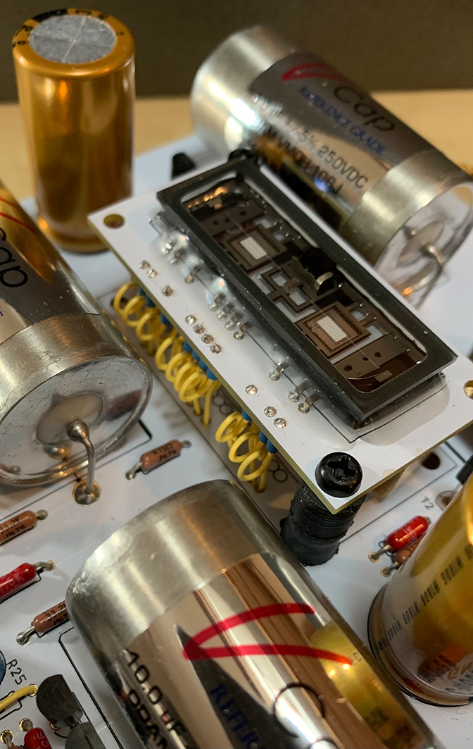

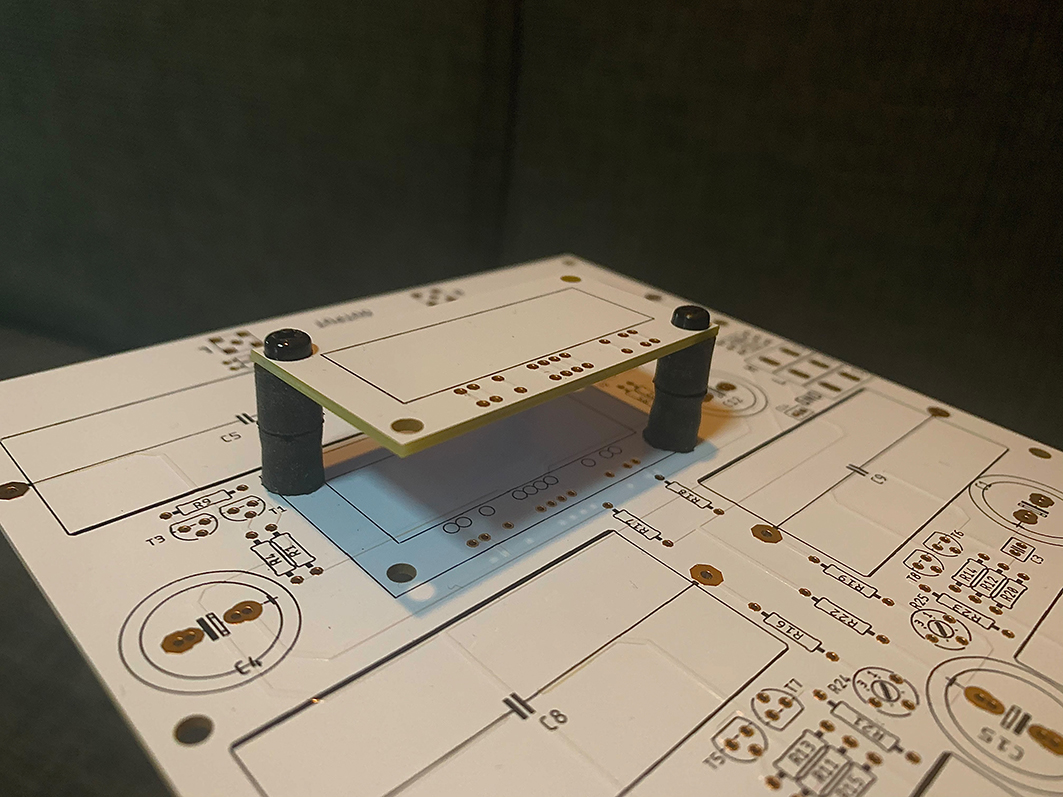

The vibration-technical processing of the nutube has occupied me for a while and I have made several tests and measured the vibrations. I realized the result on a new nutube board with stand off board and a few other things. I present the result and solution here to you. The biggest problem is, that the nutube has too little mass and can be very easily stimulated to swing. the nutube with the stand-off board weights 14,2g. I have the nutube firmly glued to the stand off board. the board is then screwed on 2 corners with m3 rubber dampers to the base board.
to achieve a higher mass of the nutube with the stand-off-board, i glued a piece of brass 1,5x1,5x5,0 cm under the stand-off-board. now the whole unit has a mass of 140g. that's more manageable. I have bent the connecting wires like a coil spring, so that no vibrations are transmitted, but are even more damped.
I have presented the new board with some photos and videos here.

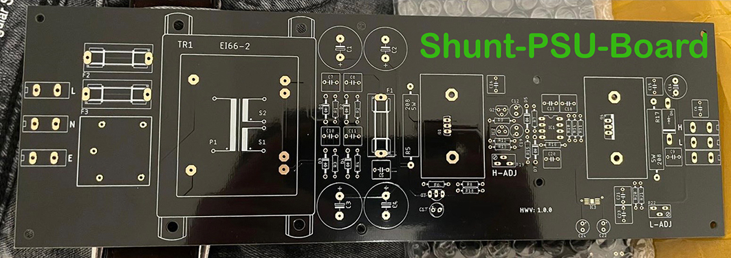

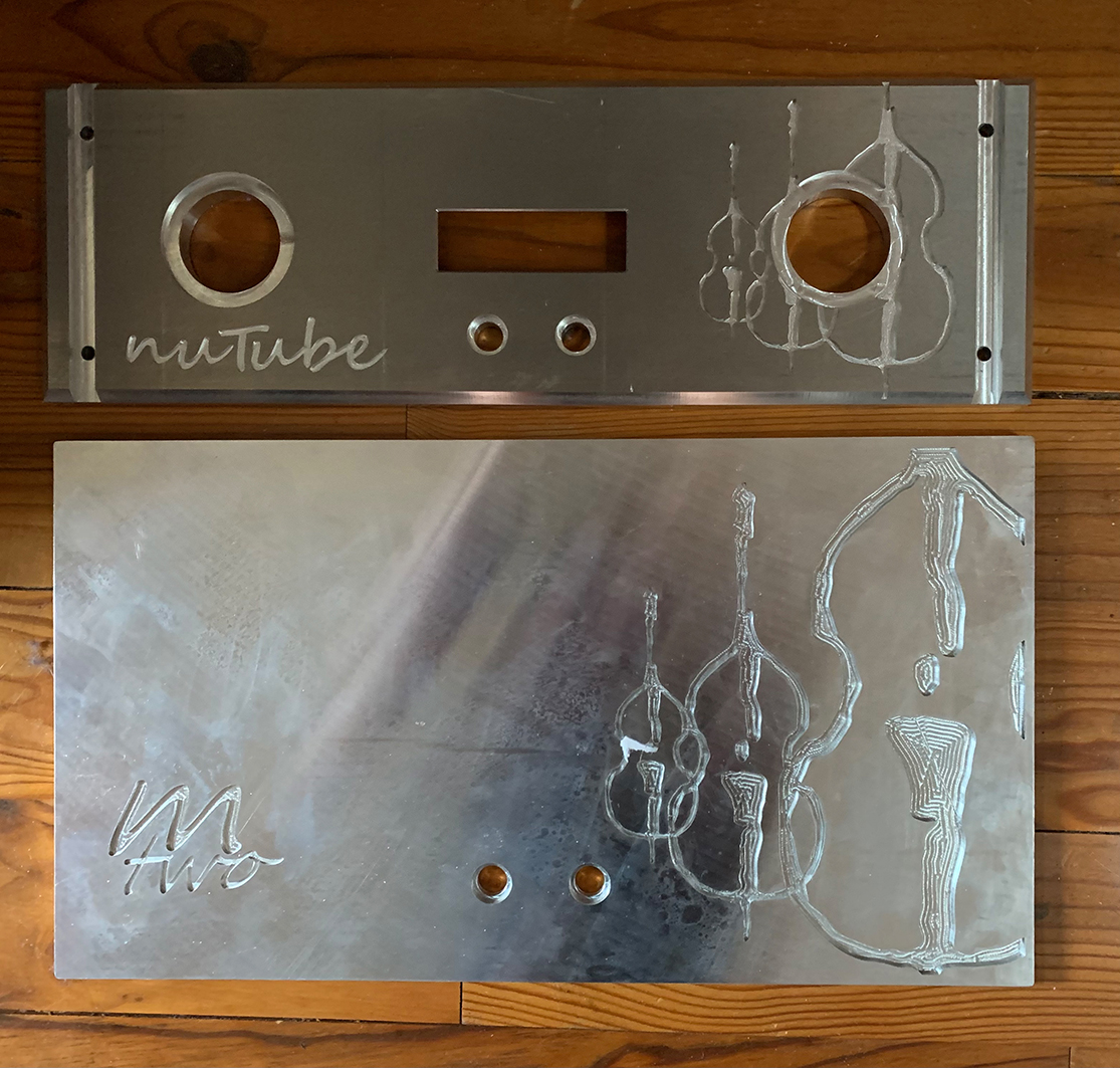

Since i expect this preamp to stay in my system for a longer time, i also thought a bit more about a fine chassis.
the power supply will still come in an external chassis, because i need beside the 24V and 9,1V also a power supply with +/- 15 V for my PCU (preampcontrolunit).
The front of the new nutube is already pre-milled, has to be ground, then bead blasted and then anodized. On the photo you see the front for the nutube and the front for the M2.
Hello,

I'm waiting for parts to arrive from dyaudio store (delayed by weather), and doing some reading. It looks like microphonics are a problem for some people, and I'm trying to think how to minimize the problem with minimum effort, trying to understand how the vibrations reach the tube.
I gather that it can happen through the air, but the new version of the chassis without ventilation holes pretty much solves that so, the transmission to worry about is physical transmission.
What I'm wondering is this: can the Nutube be supported entirely by its pins soldered to the pcb (which I gather are only on one side of the tube) and, if yes, would it be enough to dampen them where they attach to the tube -- i.e., would a bead of silicone sealer surrounding each pin be adequate for the job? It could be applied and allowed to dry before soldering to the pcb, with perhaps, a small dot or two of sealer somewhere near the other side if needed to support the tube. Sealer stays flexible so should be a good vibration barrier.
Has anyone tried this?

I just finished my kit yesterday. My nurture came with 2 adhesive squares that I placed between the nurture and the PCB before soldering. I tapped lightly on the case a few times while it was playing and didn’t hear anything. Only been a day though.
