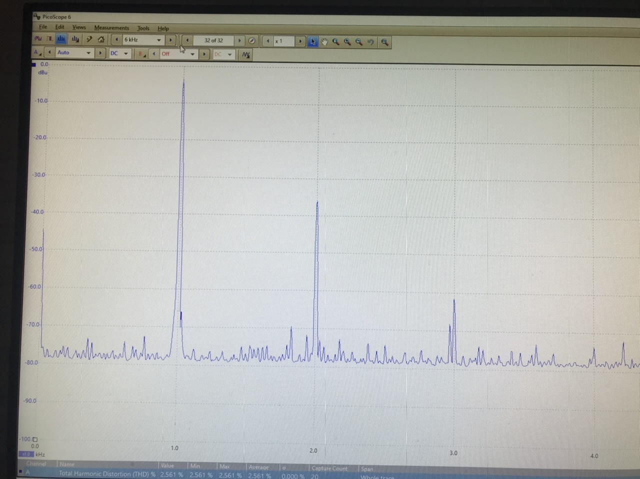

But this psu has excellent noise and ripple values , which is a good thing for a preamp.
The other good choice may be a battery psu , but that is often a pain to maintain it charged .
- B1 with Korg Triode
