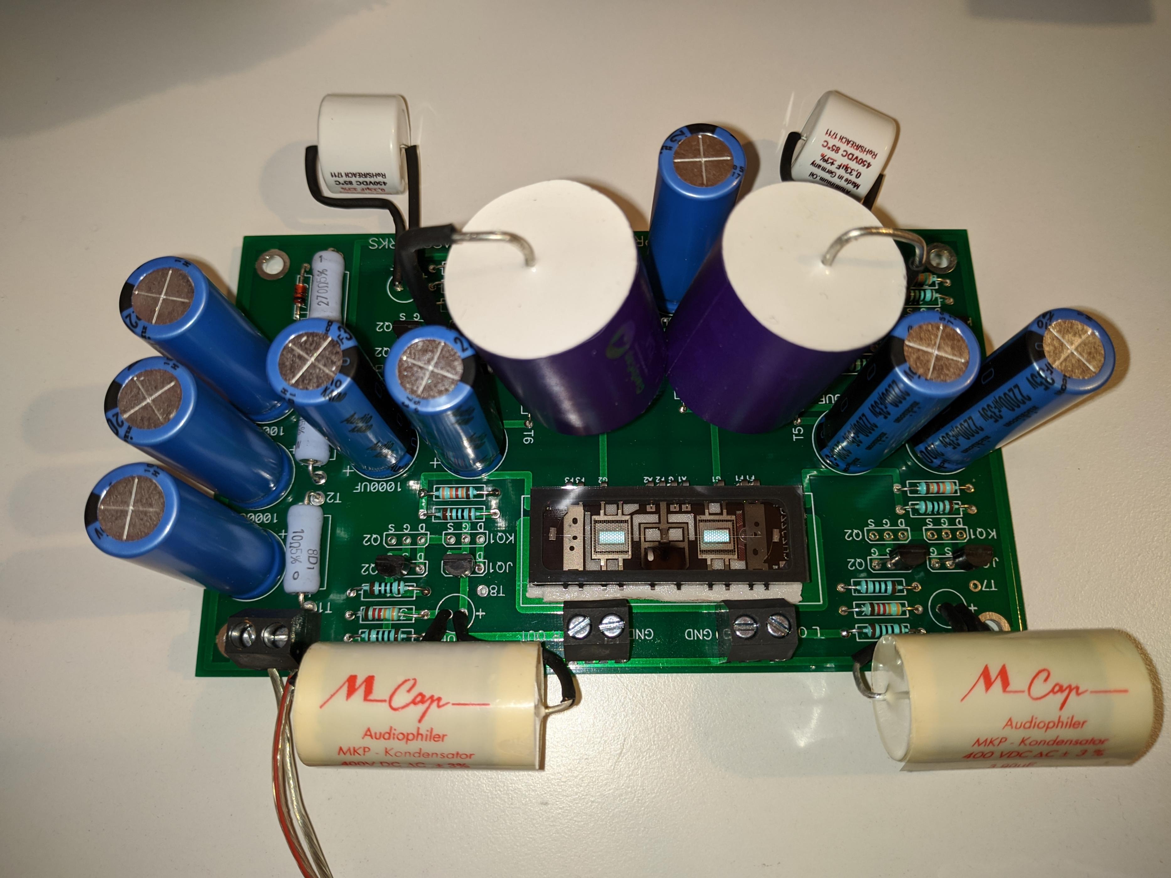

View attachment 826387So, after three days of pleasant work, my Nutube B1 has born. I don't believe I put it together in the best way, with the best parts or using the best solder, but finally I'm getting the first notes out of its board. My first impression is of a good, deeper sound stage with good detail, it seems that now music almost "comes alive". There is just a little hum, but I can slightly hear it only turning the volume knob to maximum and besides, at its minimum position also a little hiss is audible, but only placing my hear close to the tweeter. I almost solved the ringing issue (which clearly affects my sample of Nutube) following Jim 6l6 advise and placing, but not glueing, two pencil erasers on the Nutube, one upon the other. Weak ringing still appears only if I rub the upper cover of the chassis, but I believe that if I'll make it deaf to vibrations, things would go better. By the way, it's a spare chassis, which I recovered from another building, I'm planning to buy a new one, smaller, from Hifi2000. I'm waiting also for a regulated PS from China. Now I'm using a 24v SMPS, bought from Digikey, I will see if there'll be a sound improvement. My B1 Nutube drives a diy amp made by Hypex ucd700/SMPS1200 modules and SVS Prime Pinnacle loudspeakers. I'm, for now, well enough satisfied with the results and I have to say that, with regard to the other preamp I was using, the B1 Nutube represents a great improvement for my audio chain.
Thank you Mr Pass and best wishes!
Gaetano.View attachment 826366View attachment 826375View attachment 826387
ghitus,
Well done! I’m glad it’s working well and that you have the microphony under control. It’s a wonderful circuit, enjoy!!
So, after three days of pleasant work, my Nutube B1 has born..
the B1 Nutube represents a great improvement for my audio chain..

One more thing: I'm keeping T7/T8 at 14V. Is it safe?
Thank you,
Gaetano.
It's safe but definitely try 9.7V with loudspeaker leads connected in reverse polarity. If unsure of final polarity of signal chain, check with a smart phone app like Audio Control Mobile Tools (iOS) or Polarity Checker (Android). You want positive final polarity at the loudspeakers.
I know this preamp is phase inverting, so I've already connected my loudspeaker in reverse polarity. But actually I think I've not well understood facts about the T7/T8 voltage. Do you think 9.7V is the value which obtains the best sound? I read that varying the voltage on the 10k trim pots can vary the relative content of 2nd and 3rd harmonic distorsion. How can I maximize one over the other? And how does this affect sound?It's safe but definitely try 9.7V with loudspeaker leads connected in reverse polarity. If unsure of final polarity of signal chain, check with a smart phone app like Audio Control Mobile Tools (iOS) or Polarity Checker (Android). You want positive final polarity at the loudspeakers.
Thank you, Gaetano.
I prefer my system at 9.7V. Others like 9.5, some like 14V or anything in between. To quote Mr. Pass:
"Voltage at 12 VDC is approximately the 2nd harmonic null point where we get about .3 % distortion in 3rd harmonics. As we go lower we start getting positive phase 2nd harmonic, and it will hit 1.5% at 1 volt AC output with about 9.5 VDC on the T7 or T8 test points. Voltages higher will give negative phase second harmonic."

Hi Gaetano, you may want to use the search function and see what I posted re sound and voltage. I do'nt know if you are running at over 12V, but of so then it is very likely that inverting the LS cables indeed helped getting back the correct phase BUT at that voltage while inverting cables you are likely to run in 'normal' positive H2, hence not using the B1 Korg like most of us with negative H2. You could prefer it that way though... if not, run below 12V.
Note that at the cost of the absolute phase impact, something you may or may not be sensitive to, you could easily figure out if you prefer negative or positive H2 by simply keeping your 14V or so setting... and inverting (getting back to normal) your LS cables.
More confused? Normal... LOL!
Claude
Claude
Question for the crowd: does the positive phase 2nd harmonic generated in the Korg at plate voltages below 12V, in effect, become negative phase 2nd harmonic when the loudspeaker polarity is reversed?
WITHOUT inverting the LS cables, so at the cost of absolute polarity (as the B1 Korg is inherently phase inverting):
- between 9V and 12V or so, positive (classic) H2, the lower the voltage, the more of it
- between 12V (or so) and 15V, negative H2, the higher the voltage, the more of it.
- Around 12V likely to be your H2 null point.
Now, inverting the LS cables, as suggested by Papa, brings back the absolute polarity. Doing so, it also inverts the H2 sign, so we now have:
- between 9V and 12V or so, negative H2, the lower the voltage, the more of it
- between 12V (or so) and 15V, positive H2, the higher the voltage, the more of it.
That gives you all combinations, hopefully it helps you and future builders

So, that being said and more clear, the one million euro question I can ask: why most of B1 Nutube owners prefer negative phase second harmonic?
Gaetano
Gaetano
Best answer: listen to it, you will know 🙂
It is also the purpose of this little gem: not only being able to adjust H2 level, but also enabling adjusting the H2 phase - all these parameters to YOUR taste.
Claude
PS: spoiler, I found negative H2 sounded exactly as Papa described.
