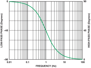

The formula for the -3dB Low Frequency rolloff is: f = 1/(2piR*C)
R will be the input impedance of the following stage. Or the power amplifier following the preamplifier. You should at least design for 10 kOhms. A few inverting amplifiers have very low input impedance like the original Electrocompanier. I do not remember the number though.
Yes, may I add that for full range speakers you want to chose 5Hz as cut off frequency, so not to have to much loss at 20Hz...

I believe a speaker company, B&W probably, DSPed a high pass phase response. The subjective (listening) test showed a preference for the corrected phase response. (I think the -3 dB points were identical.) An argument for a low cutoff => larger capacitors.

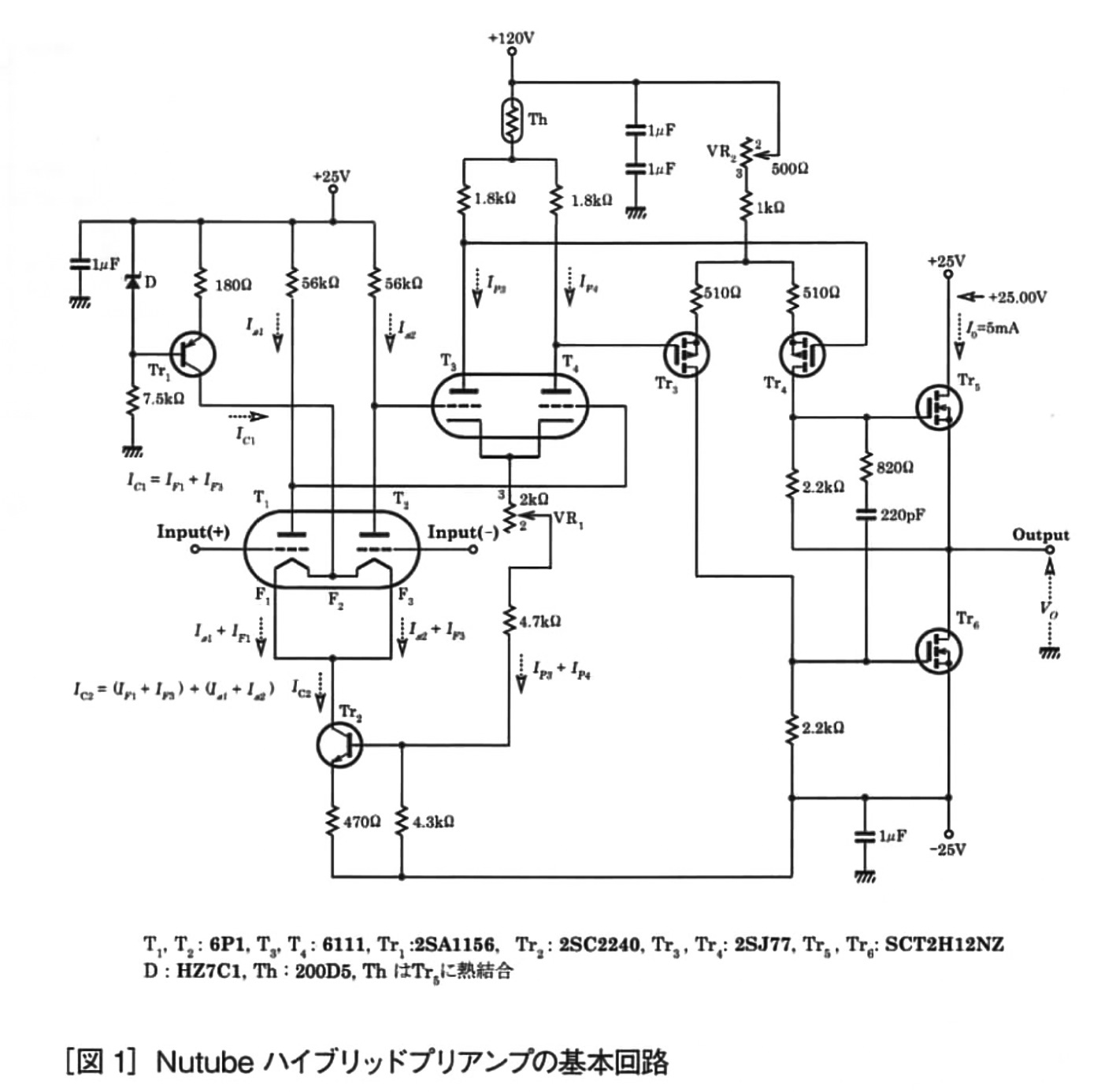

I am not qualify expert but cap's block DC if 2SJ74/2SK170 have none but AC only
( tighty matched jfet's or adjusted by trimmer offset ) at his output, then logically no need 10uF capacitor at the buffer output.
DIY entusiast Professor Akihiko Kaneta use a lot bipolar supply's and avoid caps if possible
despite more complicated design and complex builds.
Korg triode is very popular in Japan two examples : MC phono and Headphone amp
MJ1904_(05)Nutube-hyhbrid-MC-preamp_KanedaA.pdf - Google Drive
MJ1905_(06)Nutube-hyhbrid-MC-preamp_KanedaA.pdf - Google Drive
MJ1611_(04)Nutube-6P1-headphone-amp_NagashimaK.pdf - Google Drive
Pictures show Korg Nutube with Silicon Carbide Mosfets power amplifier
video : DC amp No.262 NuTube Hybrid Batterydrive Power IVC2
I am not qualify expert but cap's block DC if 2SJ74/2SK170 have none but AC only (tighty matched jfet's or adjusted by trimmer offset) at his output, then logically no need 10uF capacitor at the buffer output.
DC from the buffer can be eliminated using this configuration, however you still have DC from the Nutube plate to deal with. So a blocking cap is still needed.
Same for the input. The DC for the grid bias needs to be blocked.
And if the source has any DC, then this needs to be blocked as well using a third cap to avoid a noisy volume pot.
Therefore, this design needs a minimum of two caps if your source is AC coupled. Or three to play it on the safe side.

Complementary jfet's buffer logically bring radical changes in bias circuit as well plate etc.Therefore, this design needs a minimum of two caps if your source is AC coupled. Or three to play it on the safe side.
My post was about others Korg audio circuit with bipolar psu and is show less capacitors use is possible
