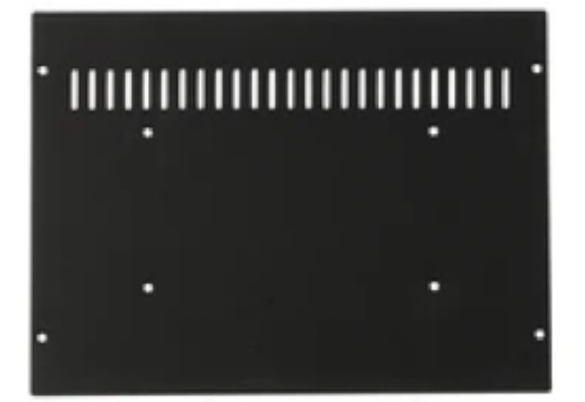

I have a perforated lid on my case and even that seems to have curtailed the self-started ringing. The bottom chassis without lid was horrendous. I mounted my standoffs on rubber washers and did a bunch of experimenting to see if they helped more between board/standoffs or standoffs/case... and washers everywhere. In truth, I am not sure that the rubber washers are doing a ton. If I tap my case the tube still rings, just less (I think). Tapping the tube will get a ring no matter what, oddly it usually doesn't sustain though.
The real issue was the self started ringing. That would sustain and keep increasing; I became a believer in the Mythbusters' earthquake machine. Again, the lid on seems to have helped with this issue, though I haven't been playing music loud. If I clap, Lurch always appears and I pray that he goes away. My build has a definite downside, as it's a hybrid power amplifier--no matter what volume I have the music at, the ringing is full volume.

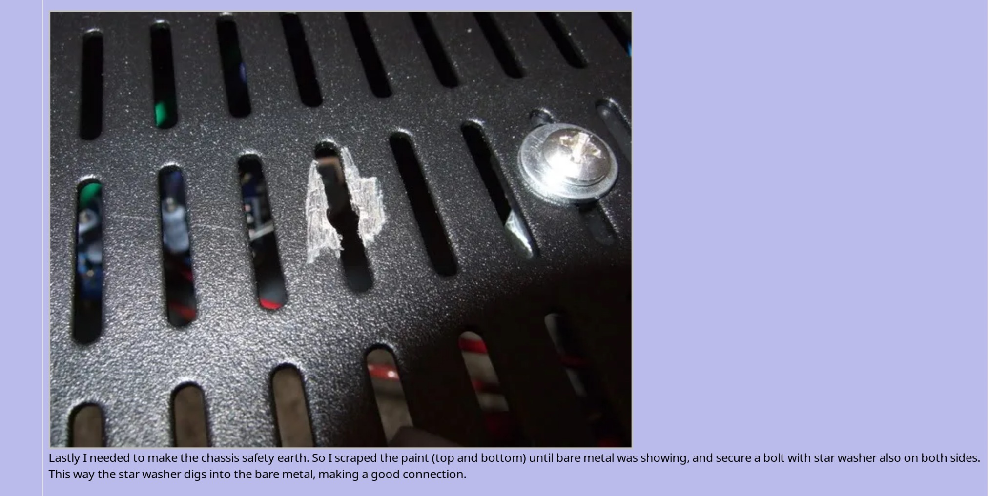

Do Your chassis is gray painted? Probably ground's are not connected together?It positively is not a grounding issue or a ground loop, if that is what you are getting at. I've tested various grounding..
Only metal standoff's with metal screws and washers can connect the PCB ground path to the chassis
without painting, so we need "naked" metal to "naked" metal physical and electrical contact's.
Top cover with chassis bottom included (metal with metal)
Rubber with rubber, painting with painting don't work IMHO.
Your top cover style is great for class A power amplifier heat dissipation
but for B1K pre is way too much open & airy ( bunch of holes ) so not protect agains microphony.

but B1K pcb need to be tighty connected with 4 metal standoffs, metal screws, metal washers ( without rubber or plastic )
to " naked " metal of the chassis box so ground path is OK.

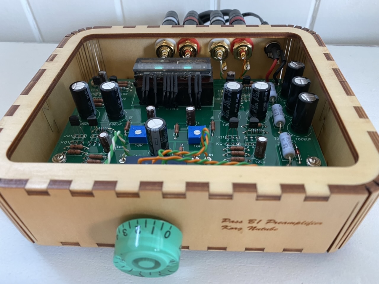

I fired up my B1 for the first time and want to confirm the voltages. I'm using a regulated linear supply (AMB s11), and the output from that is 23.97V. The output on the s11 is determined by a Zener diode and a ratio of 2 resistors, so the tolerance of those 3 components will determine the end-result voltage.
With this, everything is pretty much up to spec except T3 which I have 22.44V.
Now, this does seem very marginal, but the guide says that values should fall within 0.5V, and in this case I'm slightly out of spec. I think the build is fine as all other test points are exact.
Would you leave this as-is, or perhaps try a slightly lower value resistor on the CRC to drop less voltage?
So something weird is going on... earlier, besides T3 being on the slightly low side, all the other voltages were spot on.
I haven't changed anything on the board itself, and now I have quite a few deviations.
First, it seems like my mains flucuates a bit, since now my PSU is outputting slightly more than before, a steady 24.11V.
T3 now measures withing spec at 22.7V.
BUT, T4 is now 11V (it was around 9.2V), which has a cascading effect that T6 and T5 are 0.9V.
T7 and T8 went down to 6.2V, they were at 9.6V beforehand.
Any ideas how this could have suddenly changed?
