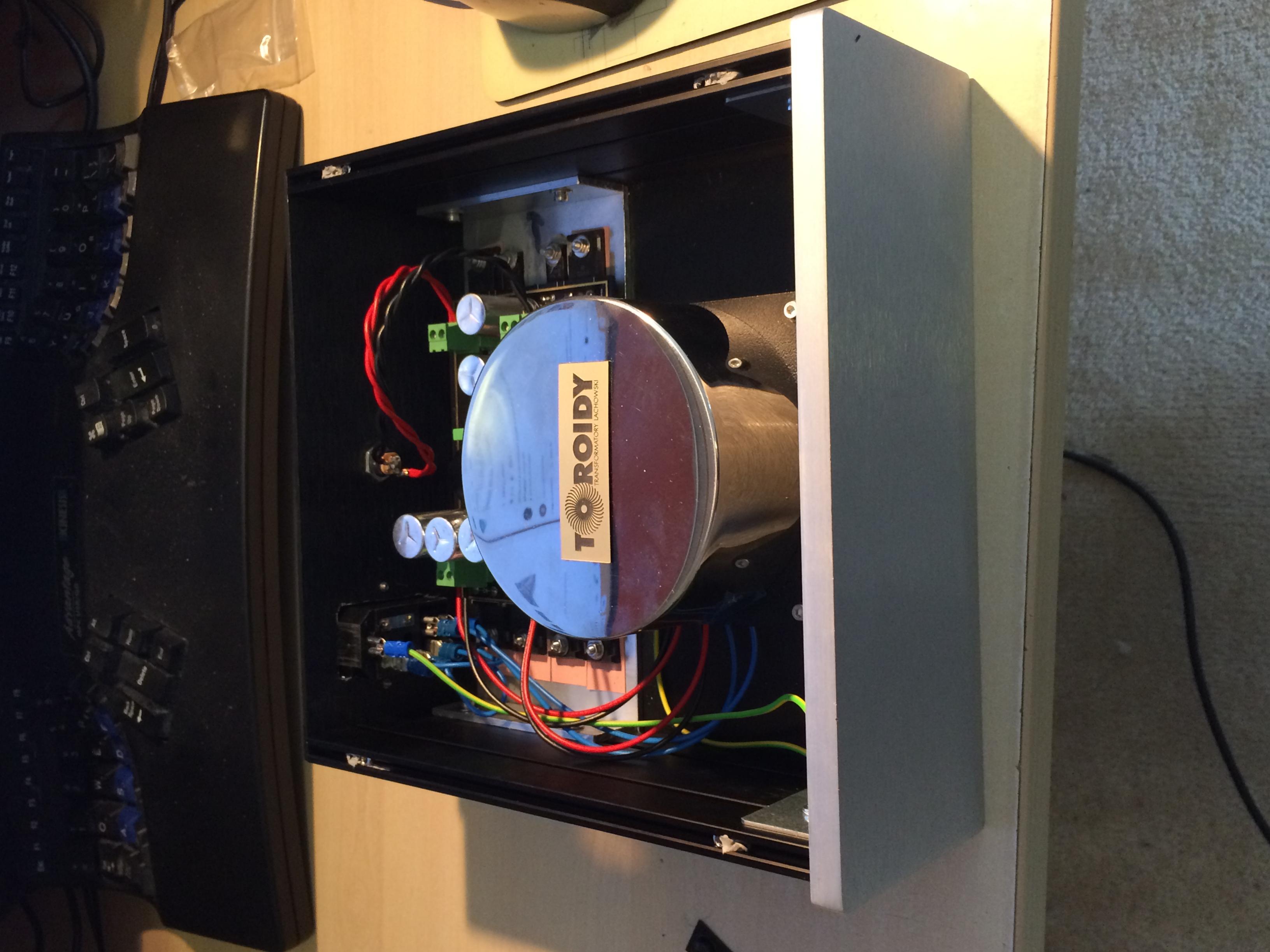

Finished my power supply for the Korg today. I had the 24V volt regulated supply board spare so just a few bits where needed to complete the job. I'm a sucker for shiny so the Toroidy was a must have. No blown fuses and no magic smoke - I must be getting better at this. Too early to review the sound yet I'm short one DC- DC cable that's overdue in the post, it's replacement that was ordered is slow arriving too.
I think he said he is using the Amb Sigma 11 (correct me if I'm wrong).
In that case, it is providing up to 1A so plenty of current available (Korg requires 60mA).
I would check the Zener. I went through a pack of diodes to find one that was even close to the 9.1v spec.
I would pull a leg each of the 7k5 and the 2x 475R resistors to disconnect point H (refer to the schematic) and test T4 to see what the unloaded voltage is.
But do whatever is within your comfort zone / capability.
Yes. σ11 has no current limiter on-board. On a different project, I measured current draw and mistakenly connected my DMM in parallel... it read 8A before smoke started. Surprisingly, the σ11 survived that episode of abuse.
I'm using a 25VA transformer don't think that is a concern here as mentioned.
T1=~24V
T3=22.62V
T4=10.93V, which is the same as the leg of the 270R resistor.
I don't know how Zener's work, but it seems like in this case Vin=Vout.
I ordered a few 9.1V Zener which should arrive on Monday.
EDIT: OK confirmed it is the Zener... I pulled it out and it looks to be open.
Triode need to be heated for 15 minutes , half hours or more before T7, T8 precise voltage adjustements .
Read voltages differences in cold and hot temperature triode state is normal
Perhaps, although up until a few days ago, at turn on I would get around 9.2V at T4 and around 9.6V at T7/T8 which would slowly move towards 9.5V after the time you mention. The values now are totally off.
0.2V of little difference at the psu output in day & night time is normal..nothing to be worried 🙂

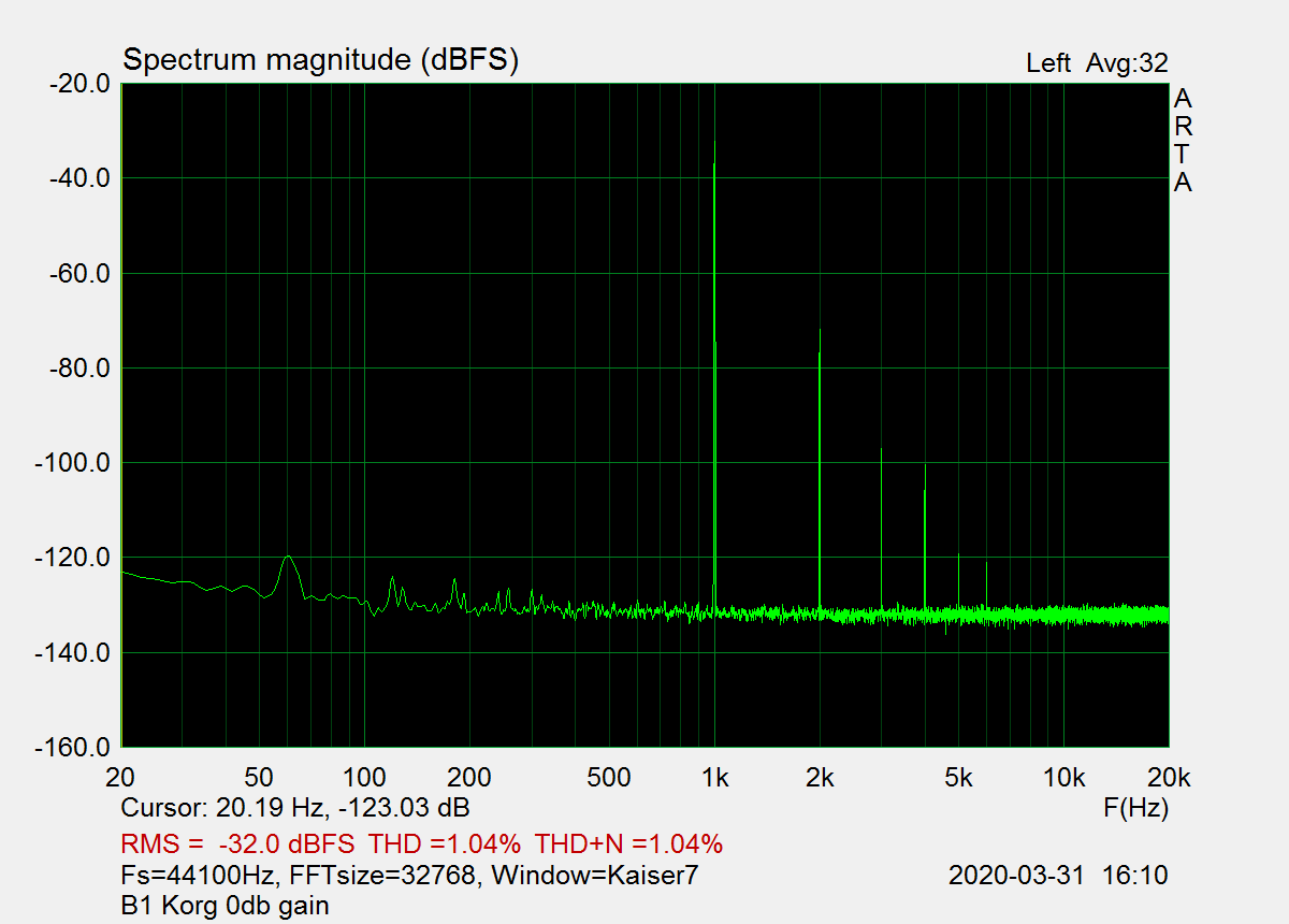

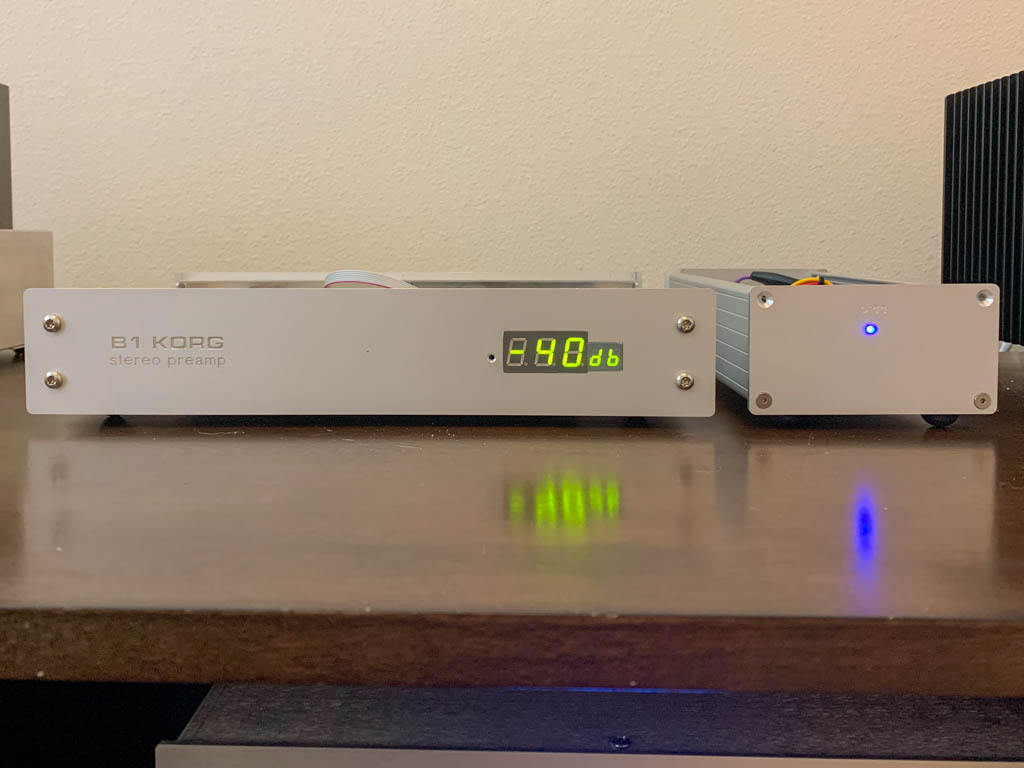

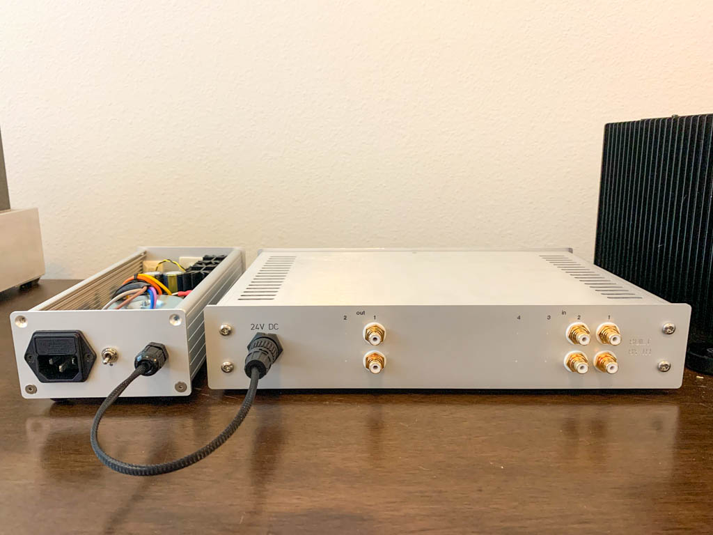

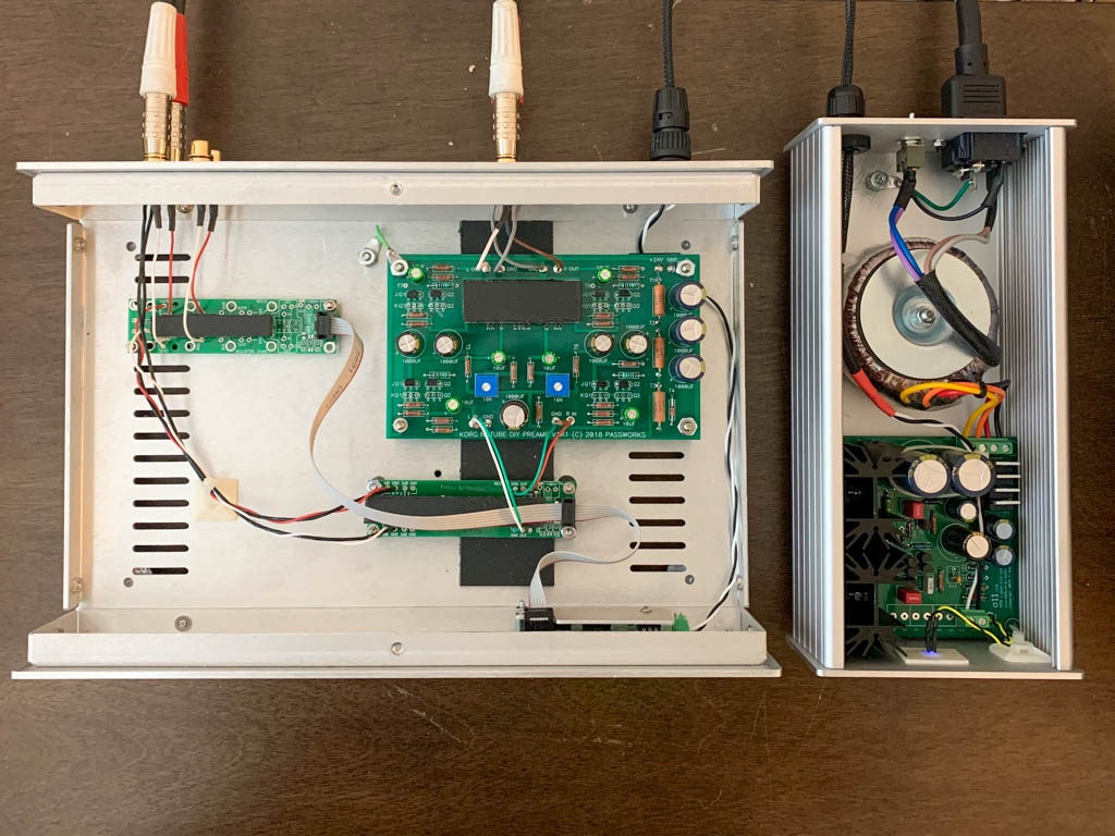

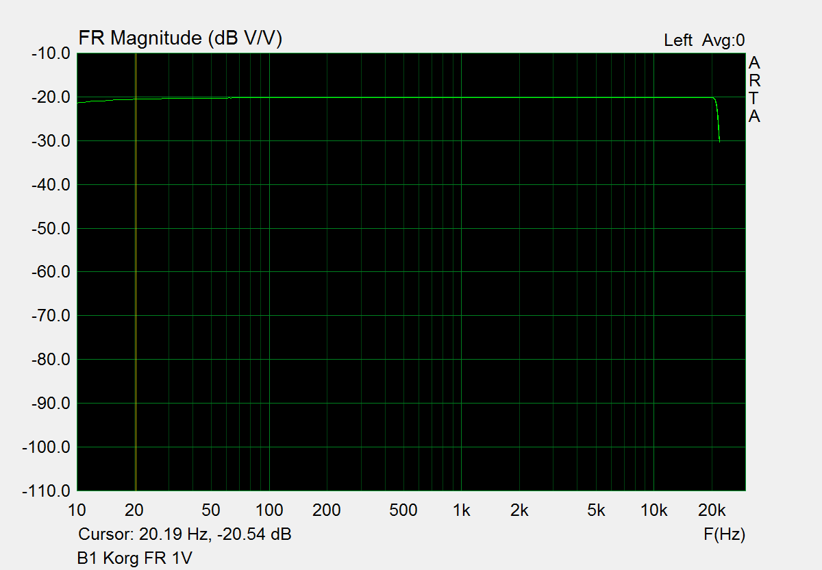

The new zeners arrived along with various damping materials. I replaced the parts and everything is looking good now. I went overboard with damping and there is no ringing now on volume change. I still think my Nutube is overly microphonic, as moving my finger gently on the top of the damping material will cause low (but audible) ringing.
I also had the chance to measure it with my amateur test suite (ARTA+pmillett SCI+EMU soundcard). In my setup, it's measuring ~1% THD with 1V output at the 9.5V bias point. FR is pretty flat, which is nice. If I ever swap in film caps for coupling, atleast I have a good baseline on what sufficient capacitance should look like.
One nice bonus is that the volume display shows -16db at 0db gain (1V in 1V out).. I thought that was cool since the circuit has about 16db of gain.
Really happy with how this came out.. Thanks Nelson!!!
