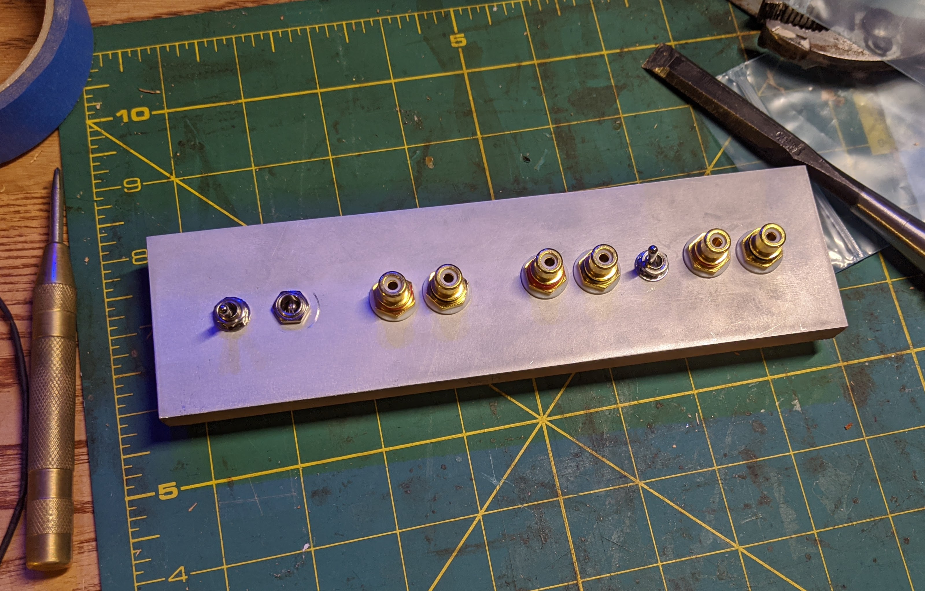

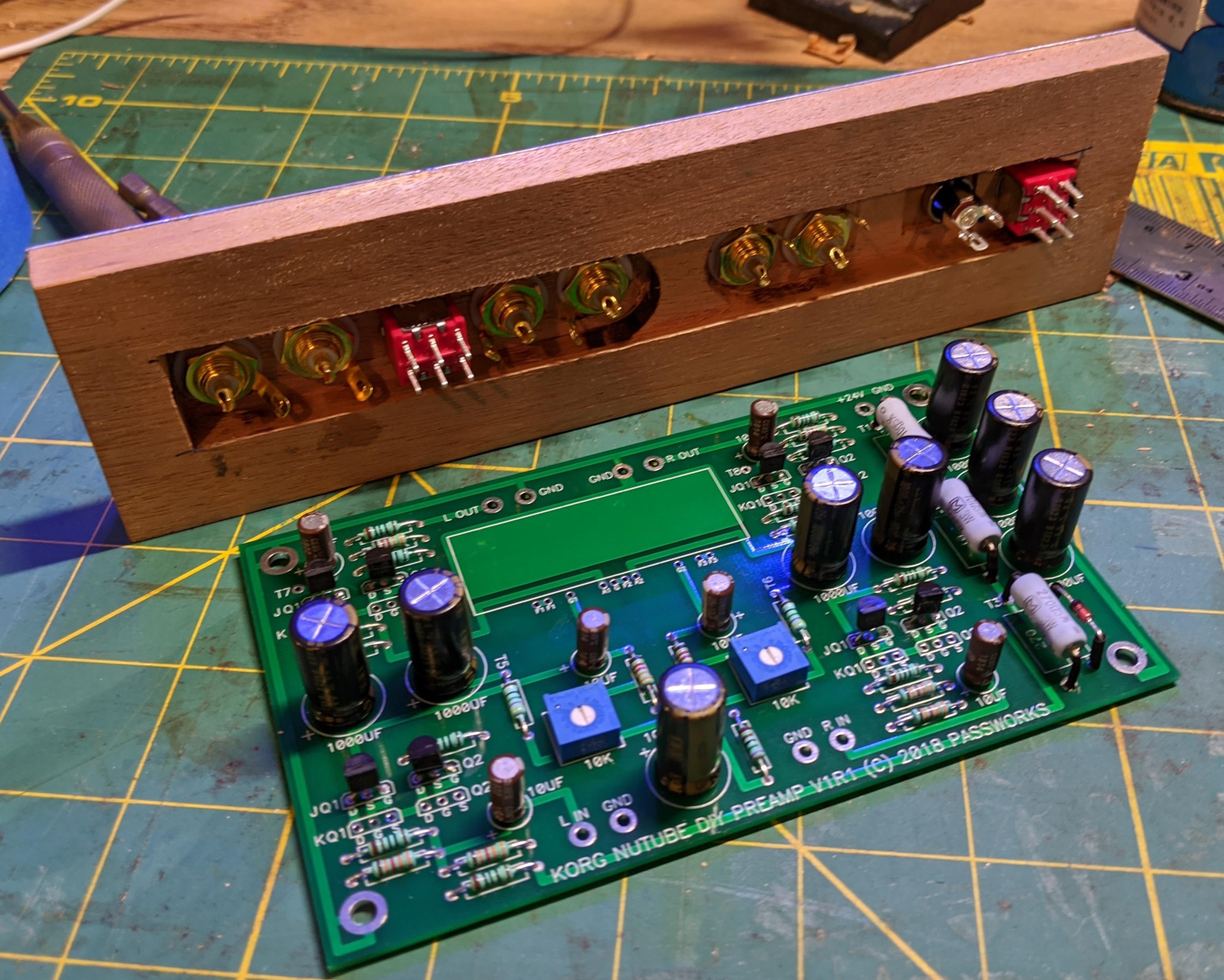

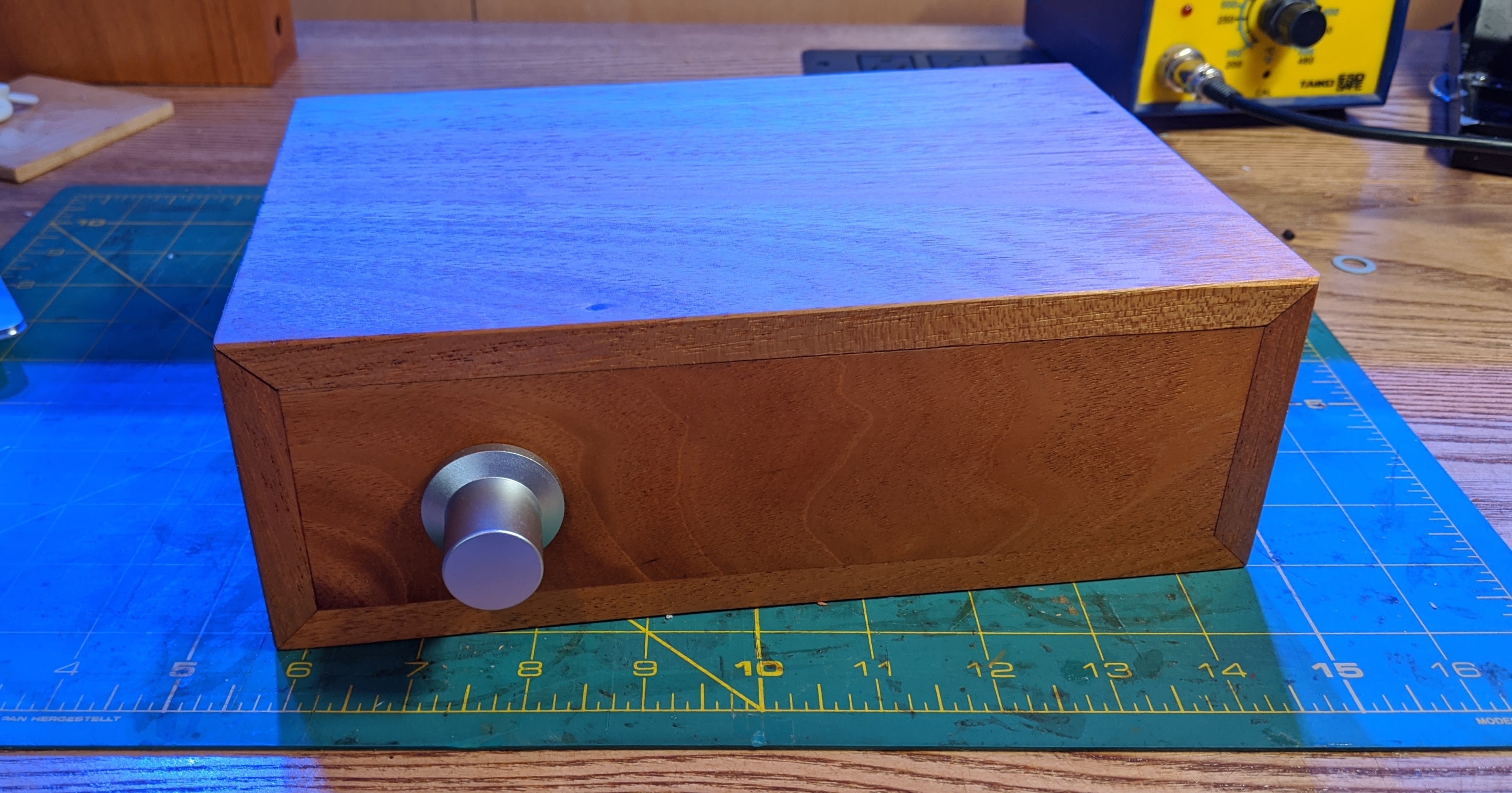

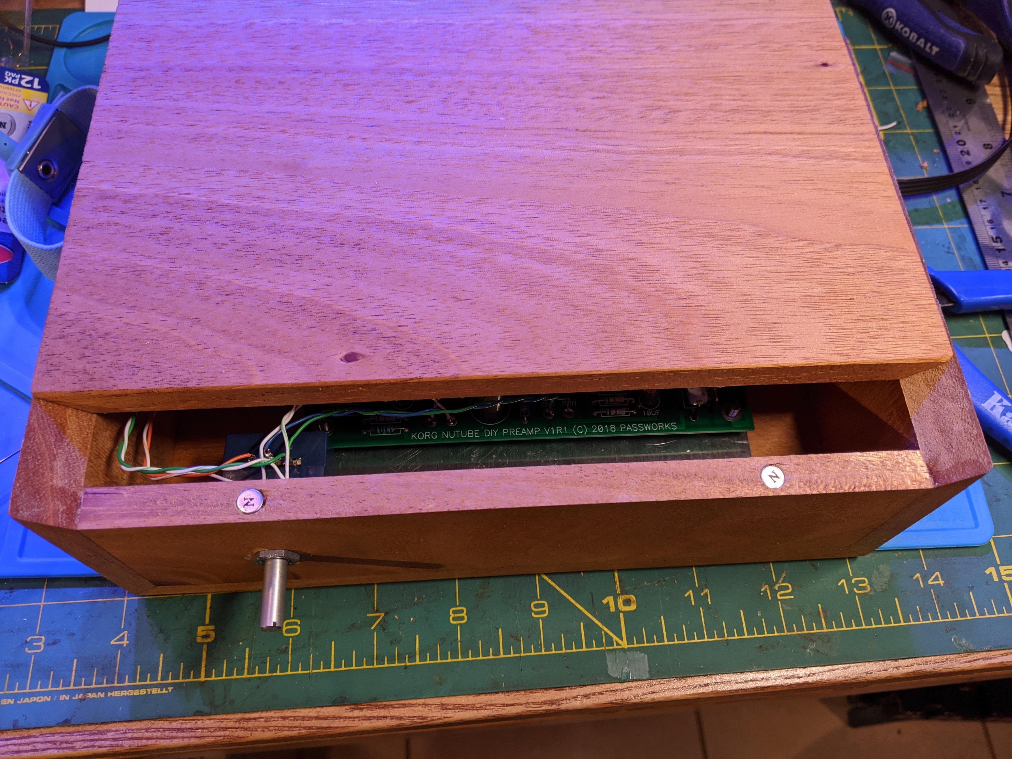

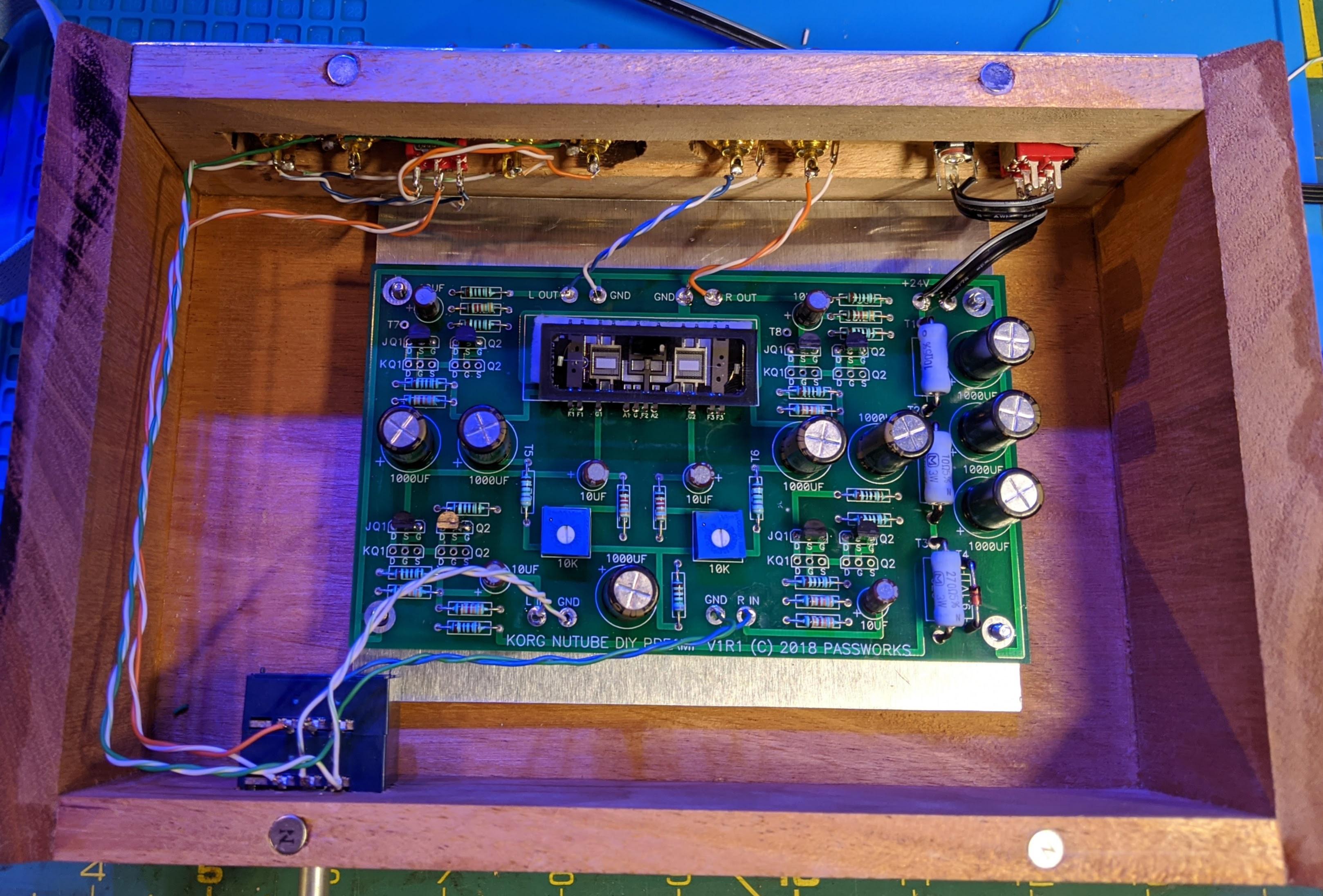

Finished my build last week. Case of Spanish Cedar (ode to Dylan). Tung oil finish. Rear panel has 1 mm aluminum laminated to it and all switches are back there to keep the front cleaner and have less internal wiring. I polished the aluminum to 800 grit to leave a matte finish to match the volume knob I wish had a replacement for. Lid is held on with 4 very small magnets that work very well - strong enough to lift the whole thing up with the lid. Sounds excellent in front of the F5s. No microphonics, thankfully. Sealed wooden case might have helped with that and I cut a block of Magic Eraser for under the NuTube. Thanks to all of you for contributing your insights; Mr Pass, Jim, et all. I liked how the case turned out so I'm making a few more, one for an analog active crossover and another for a Bugle 3 phono stage.
