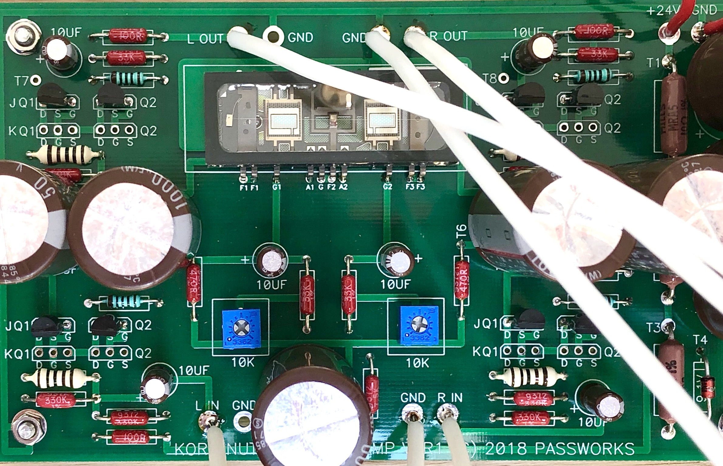

Hi again
Here is a picture of my board, I triple checked but I can’t see any mistake that would explain why I can’t Bias the tubes propperly.
T5/6 won’t go higher than 0.5V and T7/8 won’t go lower than 15V.
Replacing the Bias Resistors by lower values ?
Thanks for your help !

Bias resistor unless have diff voltage
Looks fine.. And correct Your pcb. Bottom pics?
Report on all test point voltage.. What type supply maybe the smarties will be tempted to comment.

Thank you Anthony
Everything else measure as it should.
I use a low noise LPS, 24V sharp....
I will lower the Bias resistor values and see what happens.
