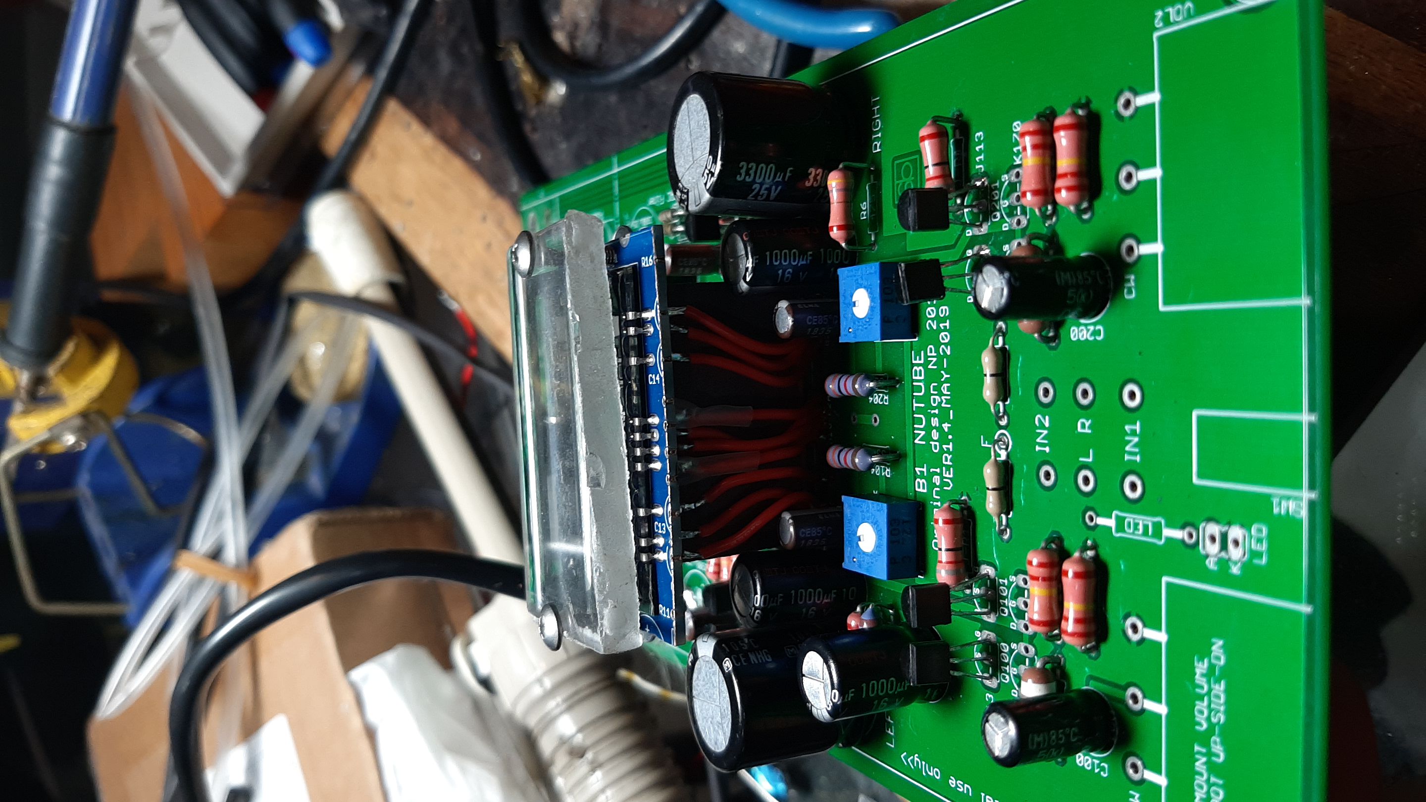

Just had an "accident" on my B1 Korg,
I had a little hum problem, so decided to do some adjustment on wiring. Once finish, turned it on, immediately I saw issues 1)The NuTube didn't light up 2)the PS (SSLV1.1) measured only 12V. It took me about 2-3 minutes finally realize the ps input on B1 board is reversed.
Corrected and nervously turned on again, it appears OK. All the check points still get desired number, no pop or any kind of broken sound when playing the music. And the hum is gone.
Still wonder anything could have been damaged?

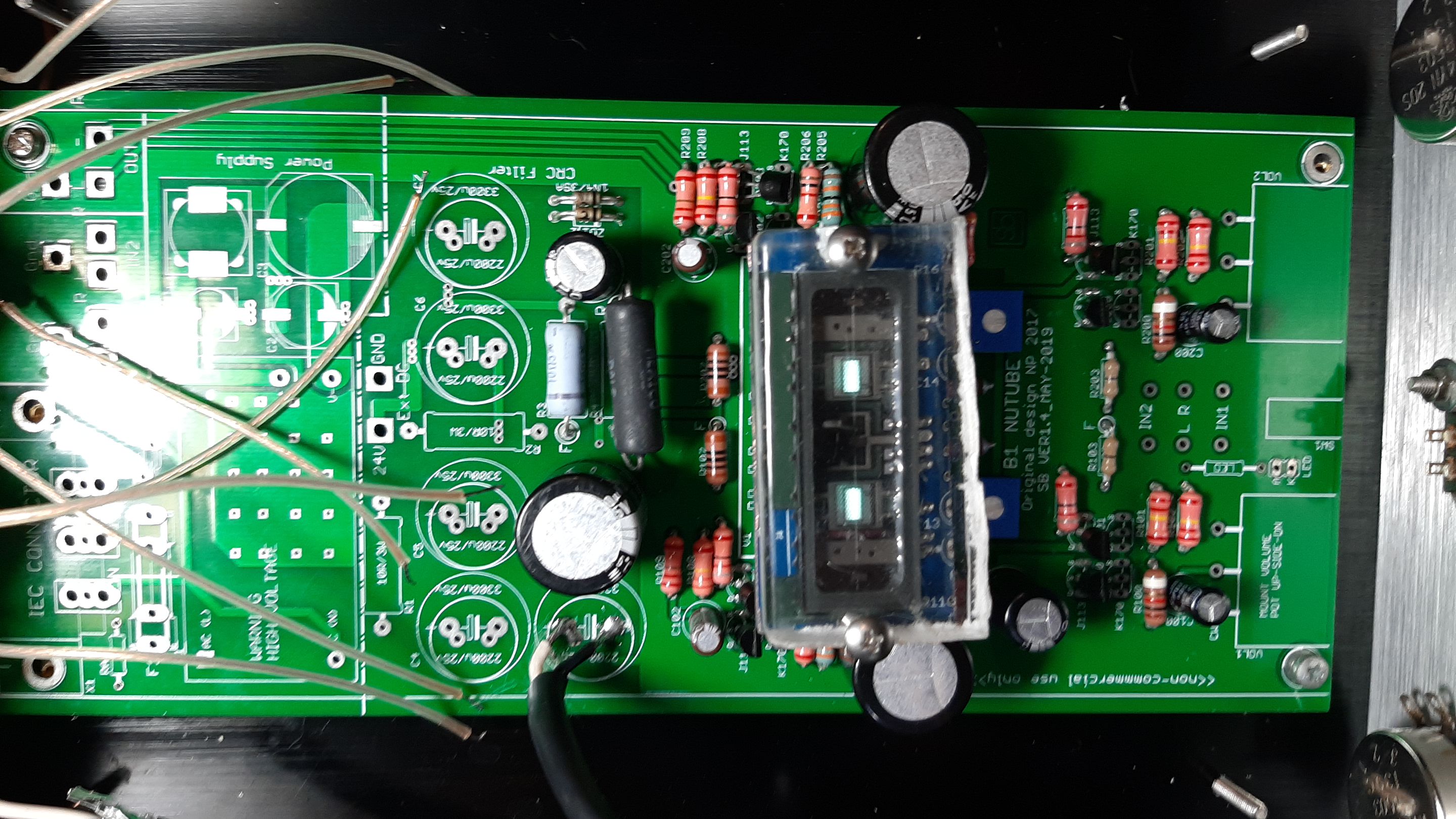

A new B1K is alive in France ... I just finished building it this afternoon .
Everything did start well and all the voltage are good given that the Meanwell psu I am using is outputing 24.4V instead of 24.0 ( Cathode Heater voltage is safe at 0.64V)
Tomorrow I will start the listening test .
If you are wondering why the white piece of paper on the picture , it is to leave space for a sigma 11 power regulation board and for the remote control for a motorised potentiometer .
If the listening test are satisfactorily I will go for a TKD motorised potentiometer .
Thank's to Nelson Pass for all his support and also to Claude and all as I went through all the 466 pages on the forum before starting my project !
