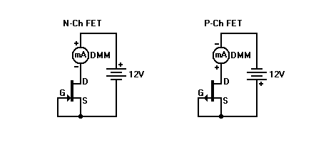

time to pull them out and do matching/comparison
you an use 9V battery as PSU
btw. trimpots are being effective on tube , JFet matching is completely separate issue
