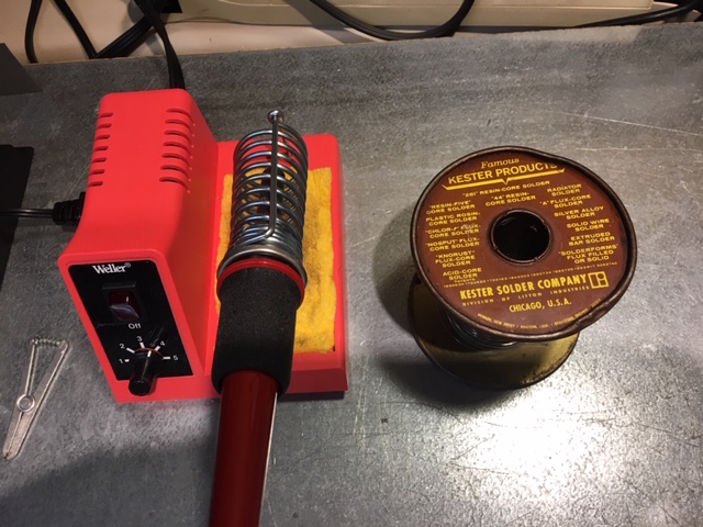

I won this roll of Kester solder in 1971 at an ARRL event for new General class of HAM license. I've never soldered anything without using this roll and my trusty Weller solder station (my forth one so far).
