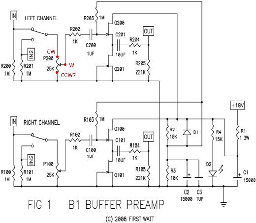

My phono preamp is a Boozhound (a simple Jfet design based on the Pacific preamp).
I don't wish to add gain as I'm afraid to have problems with volume setting as I had with all my previous amps. Unity gain is OK for me.
The thing I don't understand is how a B1 can solve my impedance mismatch as the phono pre will still see a 10kOhms pot.
I had a strange idea during the night (night ideas are often strange😉). What I'm trying to do is to lower the output impedance of my phono pre so it could drive the 10k potentiometer.
So why not put a buffer before the pot?
It could be a B1 with no potentiometer nor selector, placed in my phono pre chassis and powered by the regulated 24V PSU the pre uses. I presume the B1 pot must be replaced by a loading resistor (50 or 100k should be ok, no?).
Could it work like this or is it just a stupid idea?

What are "W" and "CW"?

No. Those 1M resistance R201 and R101 are doing that job.Thanks. Something like this, I presume (see attached file).
If shorting CW and C, don't we need to put a load resistor between CW and CCW to replace the impedance of the pot?

a Buffer is only needed where a Source is not capable of driving the cable+parallel Receiver impedances.
Put the Buffer inside the Turntable along side the phono pre with it's ultra short phono to pre cablesI had a strange idea during the night (night ideas are often strange😉). What I'm trying to do is to lower the output impedance of my phono pre so it could drive the 10k potentiometer.
You increase the signal as early as possible and make the output capable of driving the next cable.
All you need is a very basic CCS loaded jFET Follower. Just 2 transistors per channel.It could be a B1 with no potentiometer nor selector, placed in my phono pre chassis and powered by the regulated 24V PSU the pre uses. I presume the B1 pot must be replaced by a loading resistor (50 or 100k should be ok, no?).
You can go more complicated, eg Calvin, or Salas, or Juma, but these are just the same jFET followers.
The Salas RIAA is a RIAA amplifier with a jFET Follower tacked on the end to drive the next cable. Have a look Just 2Q added @ the right hand end.
Thanks Andrew.Put the Buffer inside the Turntable along side the phono pre with it's ultra short phono to pre cables.
Inside the turntable, it won't be possible as my plinth is not "hollow". But I'm plannig to put the buffer inside the phono pre, so cables will be very short (no more than 10cm).
Like a B1?😉 Or is there other examples. Being a newbie in DIY, I prefer to work with a PCB rather than point to point wiring.All you need is a very basic CCS loaded jFET Follower. Just 2 transistors per channel.
Sent from my E6 using Tapatalk
In the article on Passdiy, it's said that the input impedance is the one of the pot although the 1Mohms resistors are here. So I wonder what happens if you remove the load of the pot...
