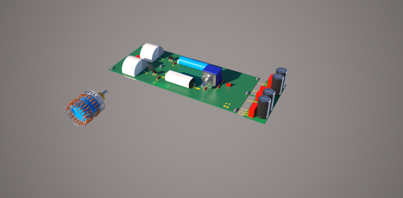

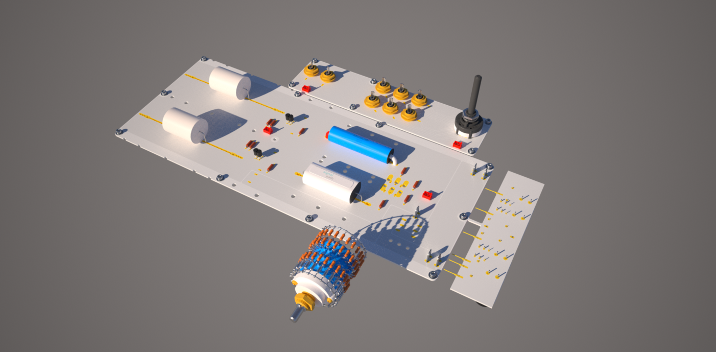

Like this virgin white!
Volume: attenuator, TKD, ALPS...
Coupling capacitors: all (Leclanché, MusiCap and Mundorf in the image)...
Footprint for ELMA switch (2 circuits 12 positions) in process...
Missing charger/batteries switch NE1848, also in process...
--> simplest interconnection!
