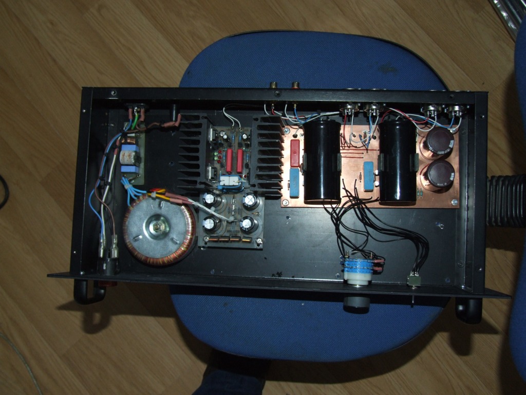

Mine is full B1 clone, not the minaturised version.
The Salas reg. is a very highly acclaimed shunt reg.
No doubt the laptop supply was appalling, the original B1 was supplied with a wall brick (not SMPS).
That's not original B-1, that appears to be DCB1? With no coupling caps? Your B-1 board appears to be a diy effort of the original B-1? Seems I do see the coupling caps, and not the circuit of the DCB1 type units...
Here's Pass B-1: FIRST WATT B1 This is "Full B-1" from Papa. No Salas power supply, like you said, wall wart.
Mine is built from this set:
B1 PCB and matched J fets https://www.passdiy.com/store
The version you are showing isn't a Pass item per se, but a no coupling cap version, hot-rodded inspired by Pass B-1. Or did you just graft partial Salas power supply to a standard B-1 circuit? I have assembled boards for Mezmorize and Hypnotize with the Salas power supply. Lost interest when need for gain arose and BA-3 pre sounded so much better for those purposes, in my systems. Did think about using power supply part on a BA-3 pre....others said it was no improvement in that particular application than 317 based regulator. For the DCB1 I have no doubt, but I wanted the gain...
