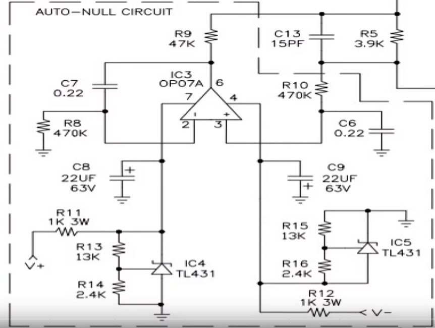

Thanks for the link. 138 pages ??? !!! I prefer for such very low symmetrical consumption the above approach (it is NOT MY my own design). VERY low noise.
Elias
Exactly srian.

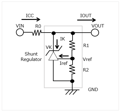

In the that thread I see huge pcbs and you don't need the 1A current that LM317/337 can supply. For the 2SK170 10mA is the upper limit. How many mA coursing/sinking this circuit ? 2~3 mA ? even LM317L/337L (100mA) are too much but I prefer TL431 because it is a "shunt regulator" and you can adjust the output voltage very easy, almost no noise output and it is in TO-92 and very cheap and RELIABLE (almost ALL SMPS use it for output voltage adjustment).
Elias
P.S. If you have time have a look at that

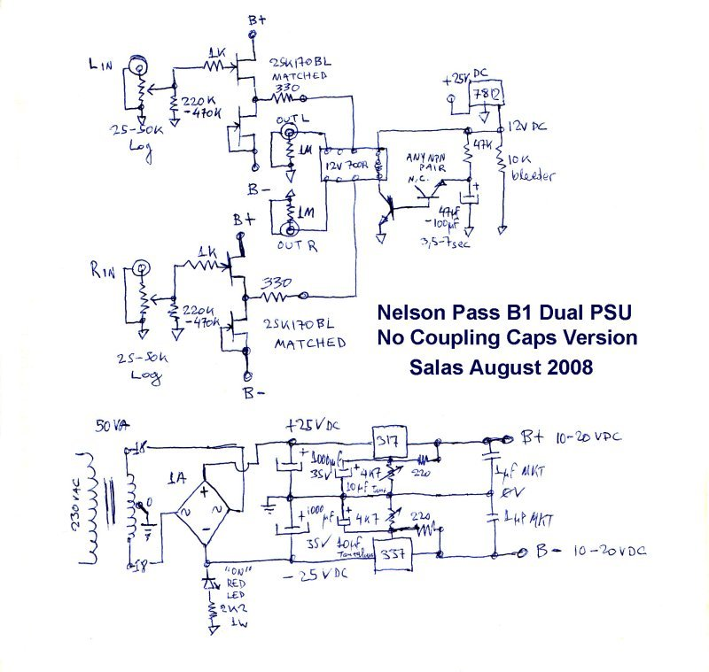

Salas
The load is about 20mA stereo plus what the relays consume
So in my (professional) opinion a piece of "perforated veroboard" is enough (but I like that part without the HUGE 7812. The LM7812L is more than enough.) supplied by a "THAI LIN Mod. TL30D-120-088(N)" or equal transformer.
I don't hire an all bus to transfer just myself from "Koliatsou to Pagrati". My scooter suits me better.
Elias
P.S. I like read-relays. They are extremely reliable if you don't exceed their specs.
LM317 used in audio power supplys are very quiet. In addition it is followed by LM 317 current regulator for the + supply and LM 337 is used in same way for _ supply. This gives a low impedance ± supplies which do not need heat sinks (due to low current needs).
Resulting in an Extremely quiet. Extremely tranparent DC B1.
(The buss will take you to your destination very safely and very comfortably than the scooty).
Srian.
