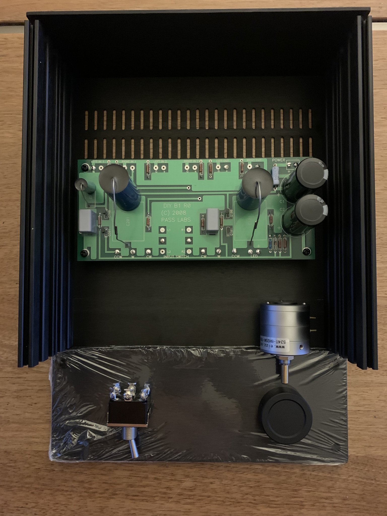

Hello again.
Almost all of the parts for my B1 are here.
I’m not happy with one component though and I hope someone can help…
Ideally I’m looking at a design almost like in the first post. Just two round knobs. But I couldn’t find a two position rotary selector. Instead I got a rather big switch which I, now that I have it here, don’t like at all….and it is not black nor could I find a nice black one.
I’d rather have two black knobs, one for input and one for volume.
For volume I got the EIZZ 24 pos. step attenuator.
Does anyone know of a nice two position rotary switch OR is it possible to block one position from the 3-pos rotary switch from EIZZ???
Please, I do not want more than two positions!!
Thank you

Lorlin 2 section/6 positions, shorting type
ask in Iron Pre thread for exact type No.
it can be limited (indentation set/inherent toothed washer) to any number of positions
of course, if you insist on kosher, search for anything Elma or Switchcraft .... or whatever
Thank you
CK1040 would be the desired type then.
Since not available I’ll get CK1060, a little harder to solder but otherwise same

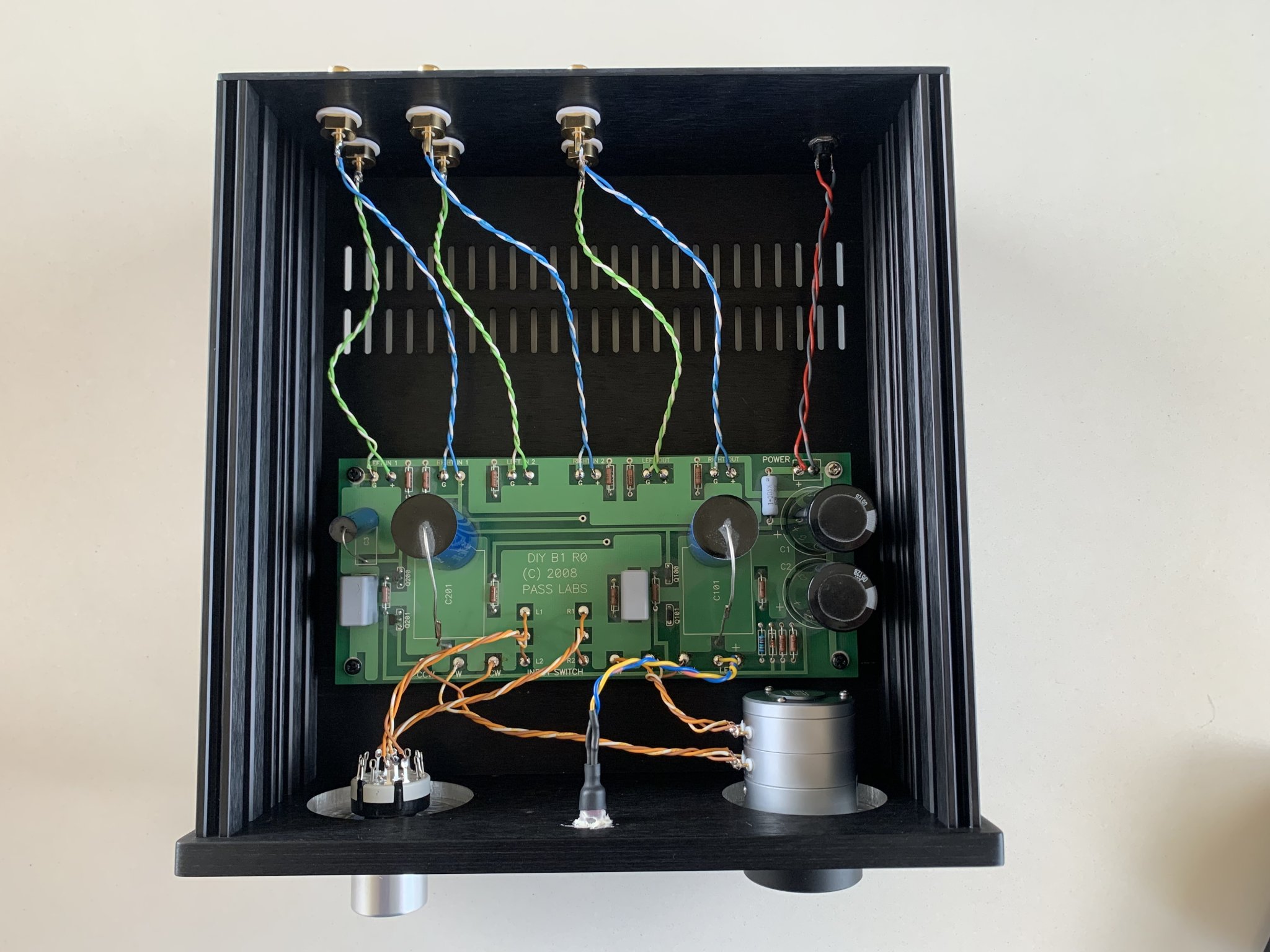

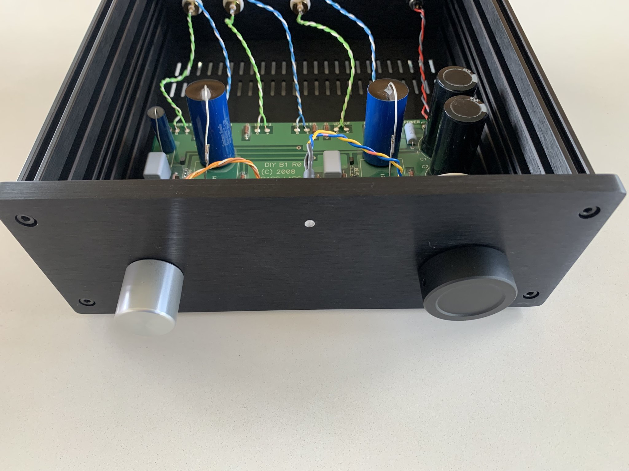

Hello!!
One knob is still missing and I’m thinking about making some kind of description on the panels, but other than that I’m quite happy.😊
The RCA are sh*t and the log pot is not ideal at the top end but very nice at my usual listening volumes.
One one side there is a phono tube pre from project, on the oder side a digital streamer. Output into active transmission line speakers.
What I find especially pleasing is, if I switch from analog to digital, the volume level is exactly the same. But I guess that’s not the achievement of the buffer.

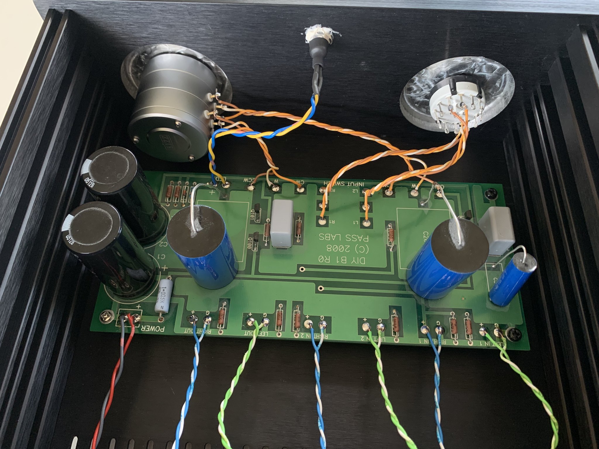

Me again,
I do experience a little but annoying humm sound, what I think is the 50Hz from mains.
Anyone any advice on how to find that and how to get rid of?

for start, confirm with ohmmeter that entire case (including front) is in contact with GND of power supply
Yes, every panel and the housing of the pot is connected to „-„ of the power supply.
The noise gets introduced when I connect the „-„ pole with the power supply and stays after pushing the plug in completely.
Are there any requirements to the power supply? Reading Mr. Pass file on the B1 almost anything should go, right?
UPDATE:
I connected my adjustable power supply from my workstation @ 24V and … no hum…
guess I have to update my wall adapter…can someone recommend a decent one? But not the overpriced ifi please.
