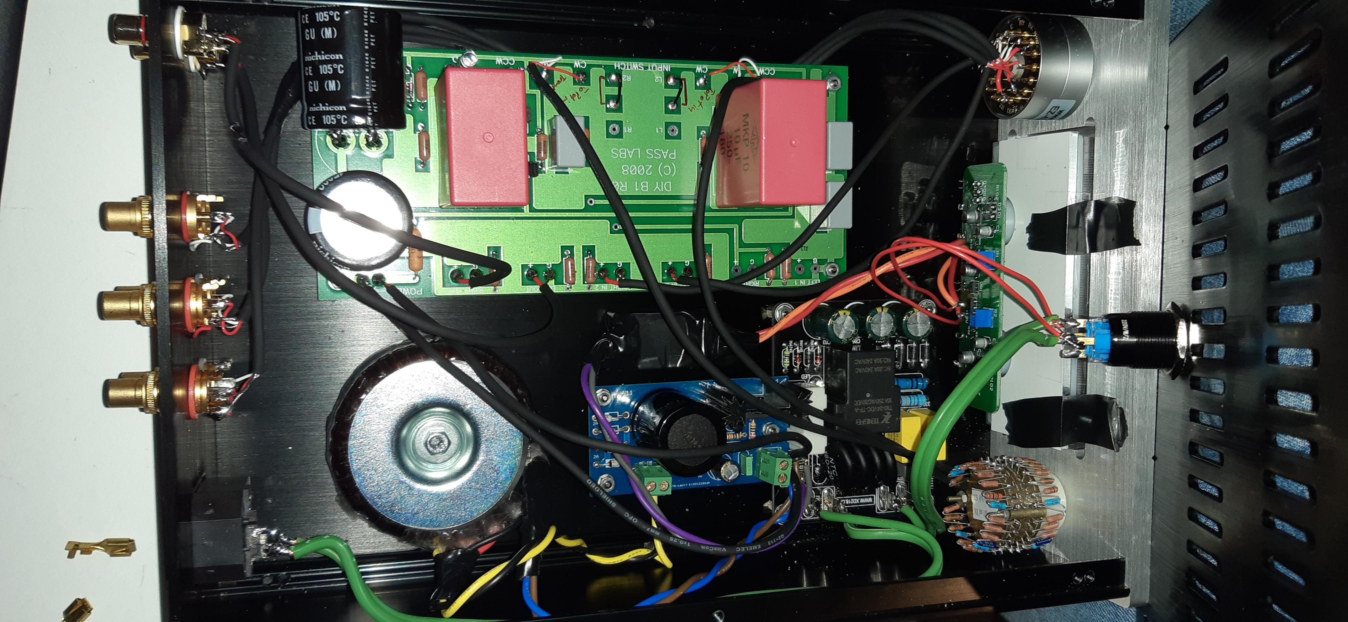

Hello all !!!
Finally I build the B1 buffer, now its "ready" but I want to check one thing. CW is the wire have to go to the potentiometer IN and the W is the wire have to come from potentiometer to the pcb... I think is that, but for be sure....
Miguel
Thanks !!! Running now!!
After two hours and a half, I have to recognize that sound good, the stage is well define and 3d feeling is good, some bells and details sound rear me..... for say something maybe a little bit dark compares with the 10k pot alone.... in the future I'll try to mount mundorf evo oil and left the Wima and Vishay. I think it can improve a little bit bit very happy !!
Thanks again for all!!
