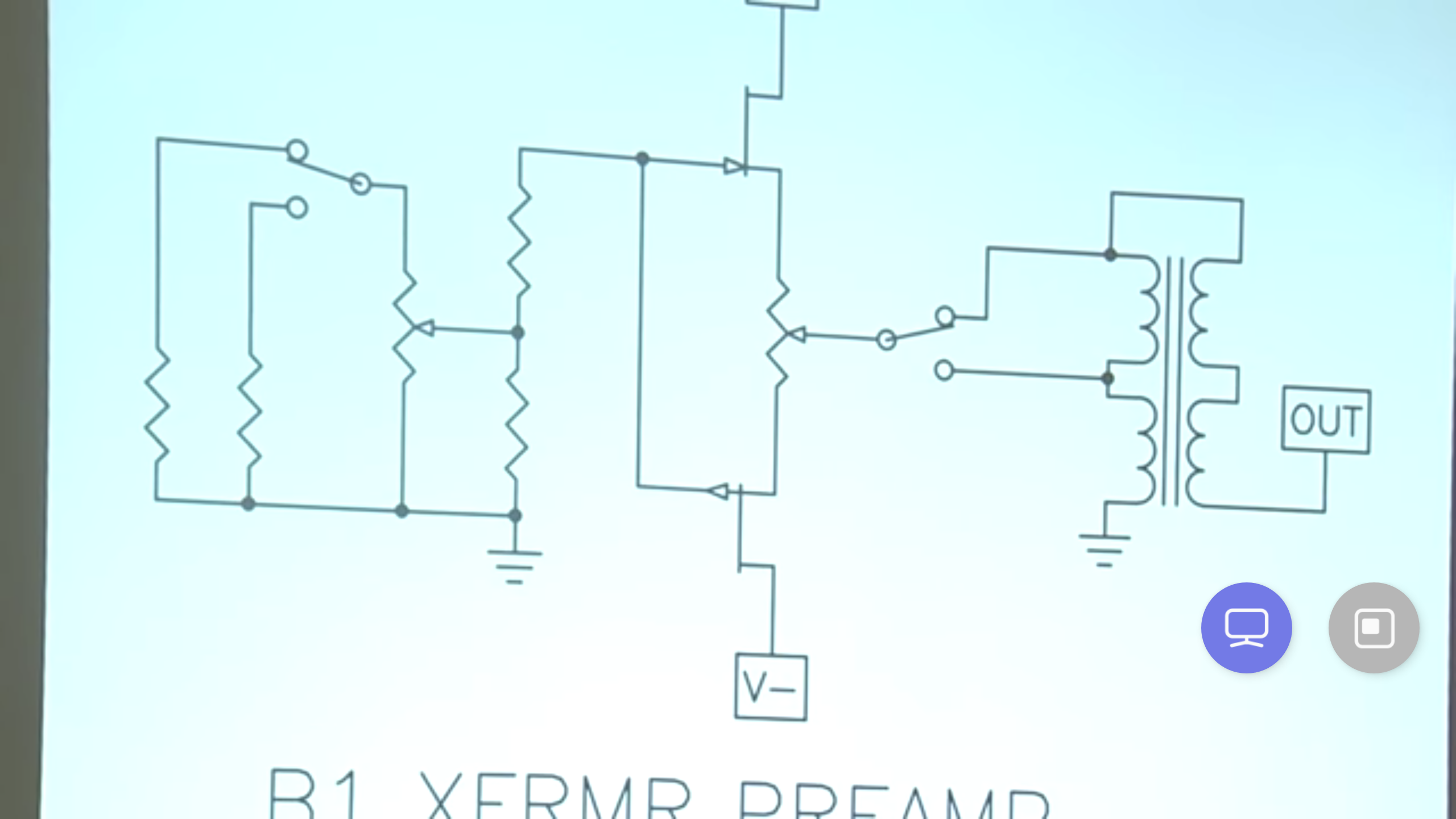

Attenuator for the B1 as suggested by Doctor Pass.
The link I have given in a previous post close to this #.

My B1 journey experience according to best sonics
1. 25k vol pot at input. Good.
2. 25k ladder attenuator at input. Better.
3. No control at the input, only 1k and a 25k resistors as explained above.
But my own tvc volume control at the output. Best sonics.
Better bass. Also have gain from the tvc. 100r resistor used at the input of tvc to
prevent loading the fets.

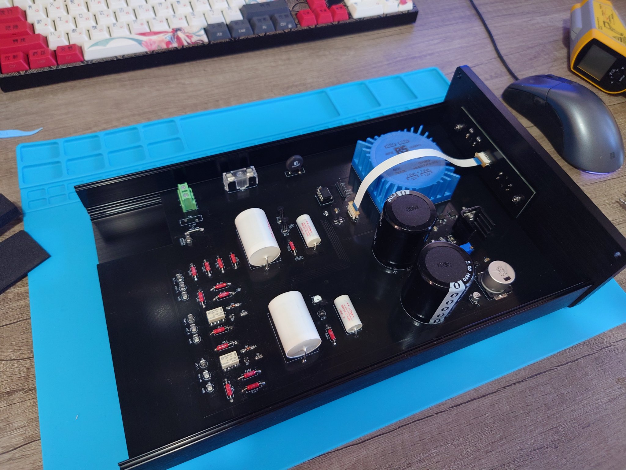

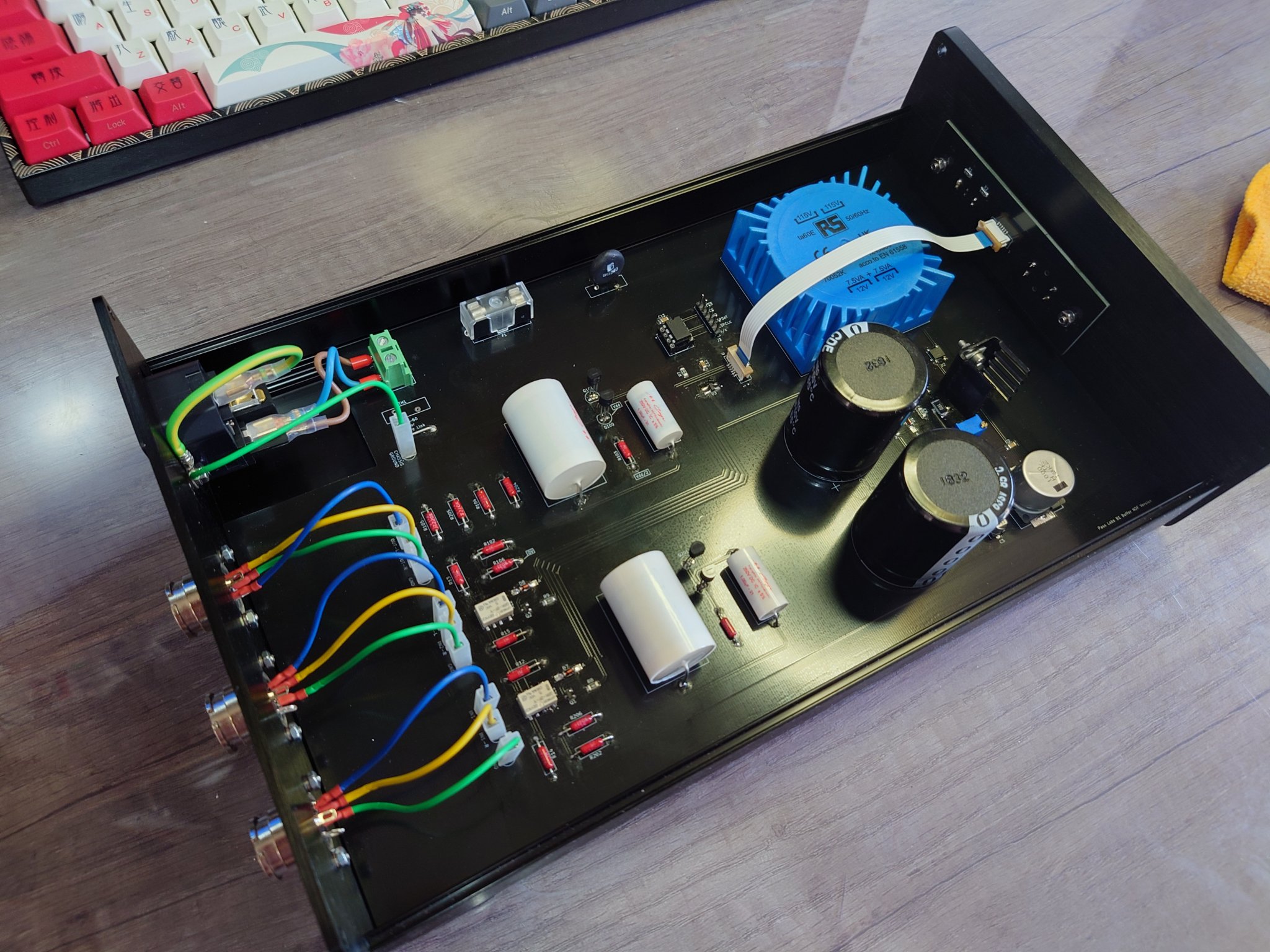

I recently completed my version of the the B1 buffer. I wanted a two channel buffer without volume control. But I wanted to switch the inputs via a tacticle switch on the front panel. I added a 5V supply to the build which powers a PIC. The PIC handles switch debouncing, front panel LED indicators and input switching via 5V relays. The build sits in a Breeze 1907 enclosure from AliExpress, PCS are from Seeed studio, and panel machining/engraving by Shaeffer AG in Berlin.
