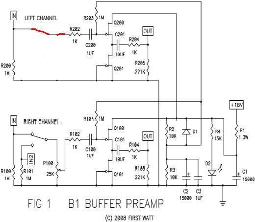

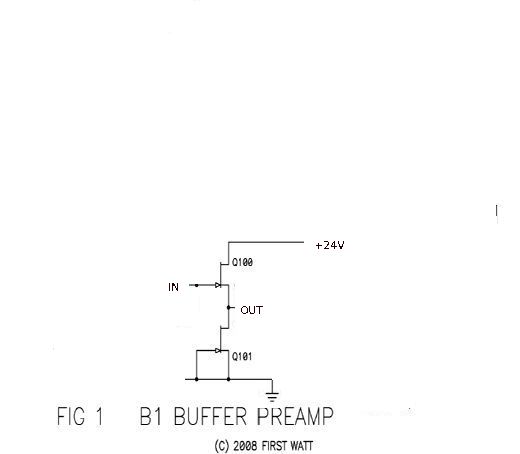

Ok. So, your B1 is now as on this schematic (I modified only one channel):
But there's the pot on the original B1 (or 1M resistor on Omishra's circuit) that lower this enormous impedance, isn't it.the input impedance of a jFET Follower is very approximately 1Tohm||a few pF
1M should be OK given that the output impedance of the phono pre is 3K.

Yes that was source side buffer whose output fed to volume pot.Ok. So, your B1 is now as on this schematic (I modified only one channel):
Sent from my E6 using Tapatalk
the Buffer is NOT a volume control.
The Buffer is added to enable an inadequate Source to drive the next cable.
Phono cart >> cable >> Pre-amp >> RIAA >> Pre-amp >> cable >> control switching >> vol pot >> cable >> power amp.
Notice there is a minimum of three cables in that arrangement.
Each Source must be cable of driving the subsequent cable.
Your 300ohms source should be good, your 3000ohms sources is potentially a problem , the pre-amp after the RIAA. It appears to have an amplifier as the final output and typical of amplifiers it has a high output impedance. All this needs is to add a follower (Buffer) to the output. Did you look at the Salas RIAA?

I thought it should be more simple (and cheaper) for me to just add a buffer board in my existing phono pre, rather than starting from zero with a brand new project (new psu, new pre...).
If I take a "no volume control B1", I just have to put it in the case, solder it to the output of the RIAA board then to output's RCA and power it with the 24V psu. It can't be more simple.
If it's possible according to you.
Just ADD a 2transistor jFET Follower to the output of your RIAA.
If you use a pair of BL 2sk170, they will draw a maximum of 12mA from your existing supply rails.
Check supply voltage the jFET Followers seem to work best with about 18Vdc to 22Vdc (or +-9Vdc to +-11Vdc)

you don't need a whole stand alone B1
You only need the 2Q follower added to the output of the RIAA.
Like on the B1 schematic, except for the values, if I understand correctly.OUT feeds a 100r and that feeds a 1uF cap that feeds the RCA socket.
There's a 1µF capacitor at the output of the preamp (schematic here). Do I need to add one at the input of the buffer.The existing output needs you to identify the output at the last transistor.
You attach a capacitor between that output and IN.
No need to have resistors between IN and ground and between OUT and ground?
insert the 2Q after the 1uF.
Move R13 to the output. It is there as a leakage grounding path.
AC couple the output with a further 1uF.
This will suit all Zin down to 100kohms.

The original Pacific pre didn't have any buffer neither. The Boozhound worked very well with my previous amp (tube integrated amplifier with 100k input impendance). This very simple design fits certainly better this kind of load. By the way, Boozhound sells a buffer stage and it seems that the new new phono stage has a buffered output.
I tried to make a sketch following your advices (see attached file). Is it OK like this or did I misunderstood something once again?
