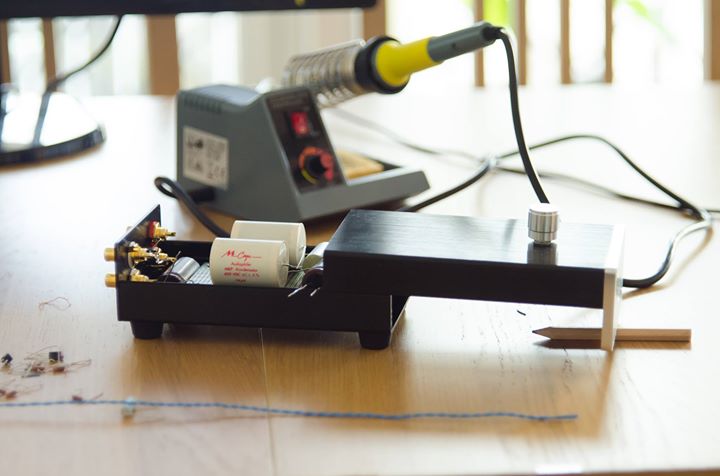

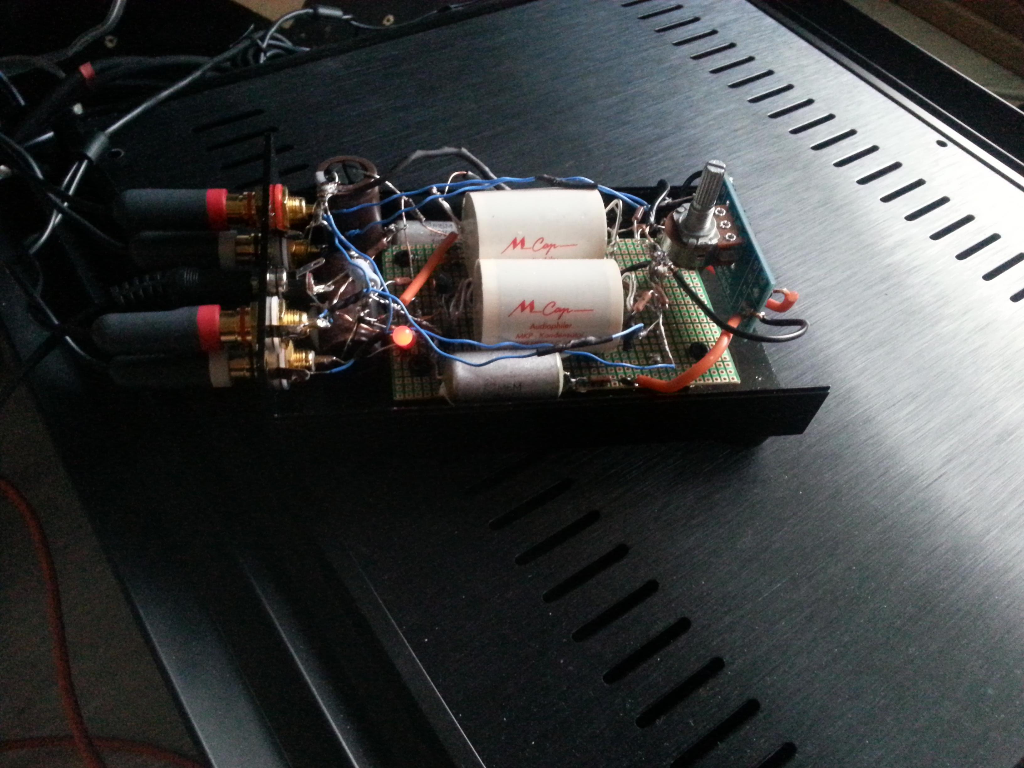

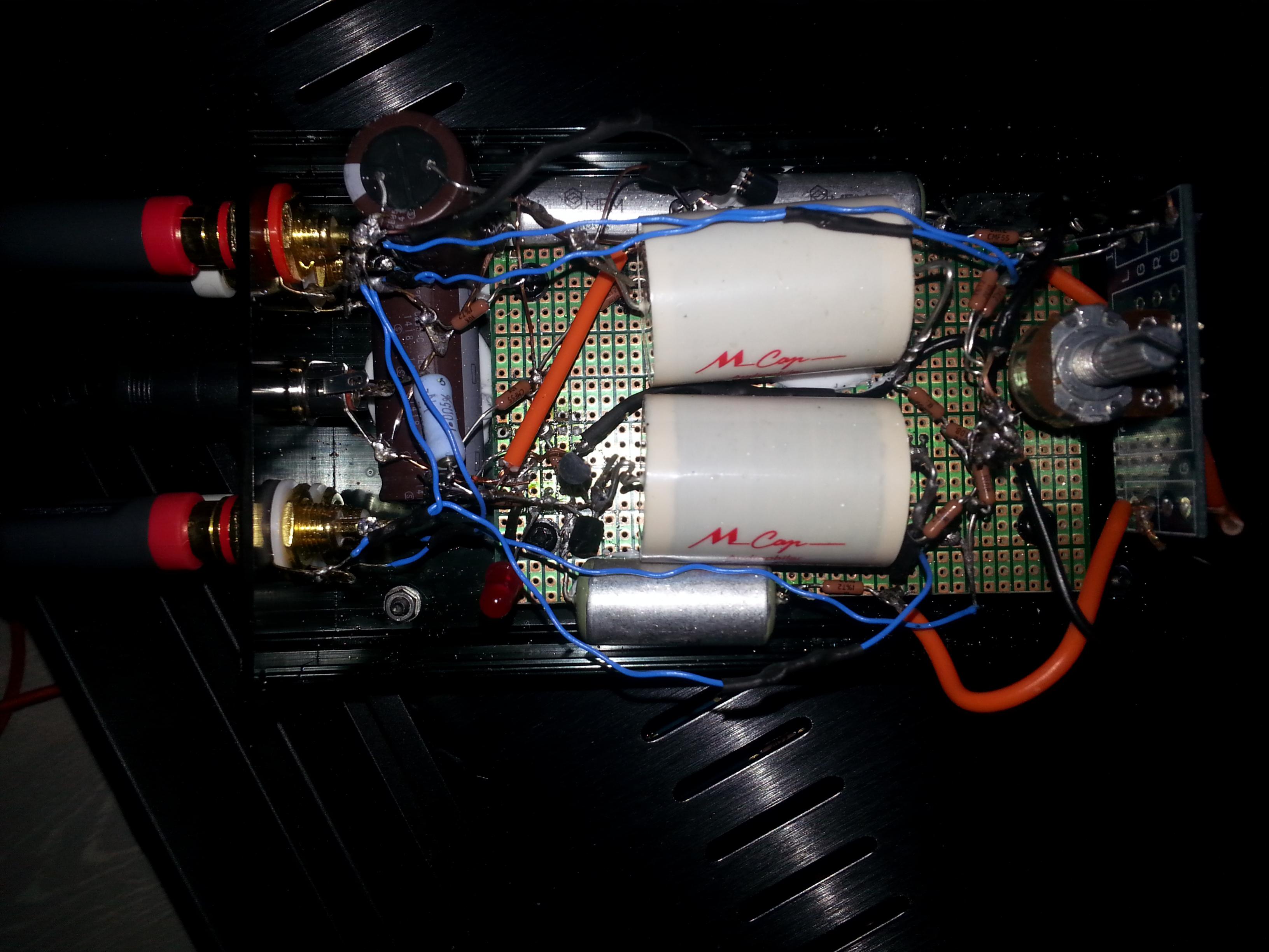

Here is my B1. Rather compact! Less noise I hope, because it was a b**** to fit everything. Will change the wall wort for a battery soon.
The sound is much better than with just a pot. It took me two days to build it. First days of Easter vacation and I am already done. Now what to do?
