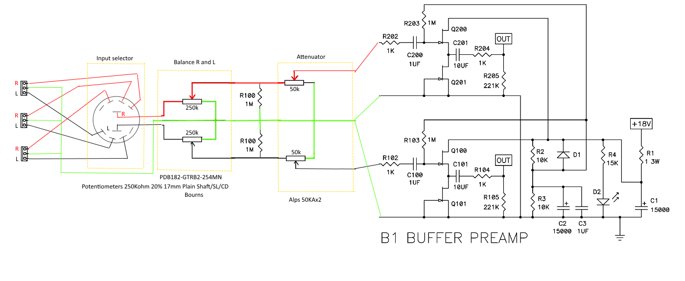

Hi All,
i am thinking to add :
input selector,
balance Pot,
Pot attenuator,
any obvious mistake in my sketch?
thank in advance guys!
Balance attenuator — imgbb.com
input selector,
balance Pot,
Pot attenuator,

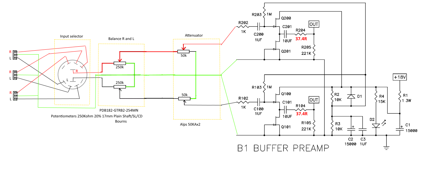

it's OK , except no need to post in several threads
no need for 1M after balance pot
lower values of R104 and r204 to anything between 22R and 51R
Hi Zen,
i am mainly going to use the B1 with A FirstWatt M2 Clone, which has a imput impedance of 100K.
i was also reading ... you are going same direction than Papa, but 22-51R isn't that too low?
B1 Buffer Preamp
Thanks!
B1 Buffer Preamp
Thanks!
that's idiot proof part , Papa put there as protection , taking in account that B1 was commercial product , with all possible consequennces
however , when I'm making some gadget , I'm only idiot going to use it , so why not optimize it ...... 🙂
you can omit that resistor completely , meaning - you can put short instead
