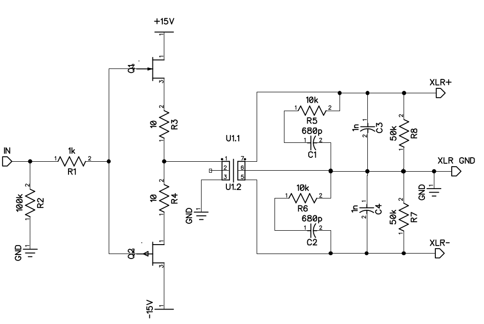

Why do you want to add an autotransformer to the B1 version 2?I have question about Firstwatt B1 with transformer (from burning amp 2017).
because I need more gain. my cd and dac has 0,4-0,5V RMS, my amp is Aleph J, my speaker has 86db sensivity (small monitors)

That would be extremely unusual.because I need more gain. my cd and dac has 0,4-0,5V RMS, my amp is Aleph J, my speaker has 86db sensivity (small monitors)
CDP and DVD have maximum outputs of 2Vac to 2.4Vac.
0.4Vac to 0.5Vac would be more typical of average levels from these digital sources.
Have you downloaded Pano's sound files to do any measurements of the signals coming from your digital sources?

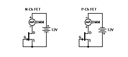

better to use a 100r resistor plus the battery.
Use the diagram in post375 and replace the mA (milli-ammeter) with the 100r resistor.
Set the DMM to voltmeter 20.00Vdc.
Short the Nchannel jFET Gate to Source. You can use a crocodile clip to clip these two legs together. Take that croc clip lead to the -ve of the 9V battery.
Clip your DMM voltmeter across the 10r resistor.
Clip the top of the resistor to the +ve of the battery.
Touch the other end of the resistor to the drain lead of the Nchannel jFET. The DMM reading will change from 0.00Vdc to ~1.00Vdc.
Untouch and reset the DMM to 2.000Vdc.
Touch and read ~1.000Vdc.
The DMM reading can be converted to an equivalent current, using Ohm's Law I=V/R
V=1.013Vdc
R=99r7
Id=1.013/99.7 = 0.01016A = 10.16mA
That is the Drain current when Vgs=0volts.
The Vds is battery voltage - volts drop across the 100r resistor - volts drop on the test leads.
Thus Vds ~9V - 1.013V - ~0.001V = 7.986Vds
If the Vds were 10V and the junction temperature inside the jFET were 25degrees C, then the Id would by definition be the Idss.
Your approximate Id is close enough.

I checked output levels
TDA1541 + SRPP 6111wa = 1 Vrms
TDA1543 + PASS D1 I/V = 0.8 Vrms
TDA1541 + AYA2 I/V = 1.5 Vrms

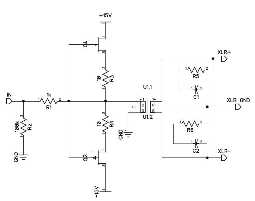

I want to build push pull 2sk170/2sj74 with gain stage and input selector but switchable for 3 options
- only input selector
- input selector + jfet buffer
- input selector + jfet buffer + gain
And I do not know how to connect transformer. Is this correct (transformer is EDCORE 600/10k 1:4 ratio) ?
