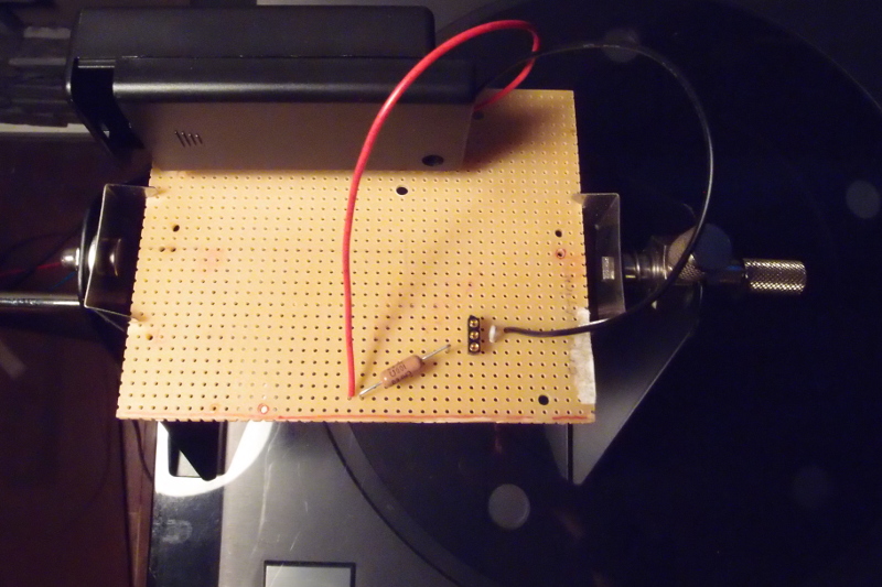

Anyway, it is still not good so I prepared a small test bench for the J-Fet.
I found ten 2SK170 coming from a Boozhound kit that I never built (I made a Pearl 2 instead). I'll test my test bench with them.

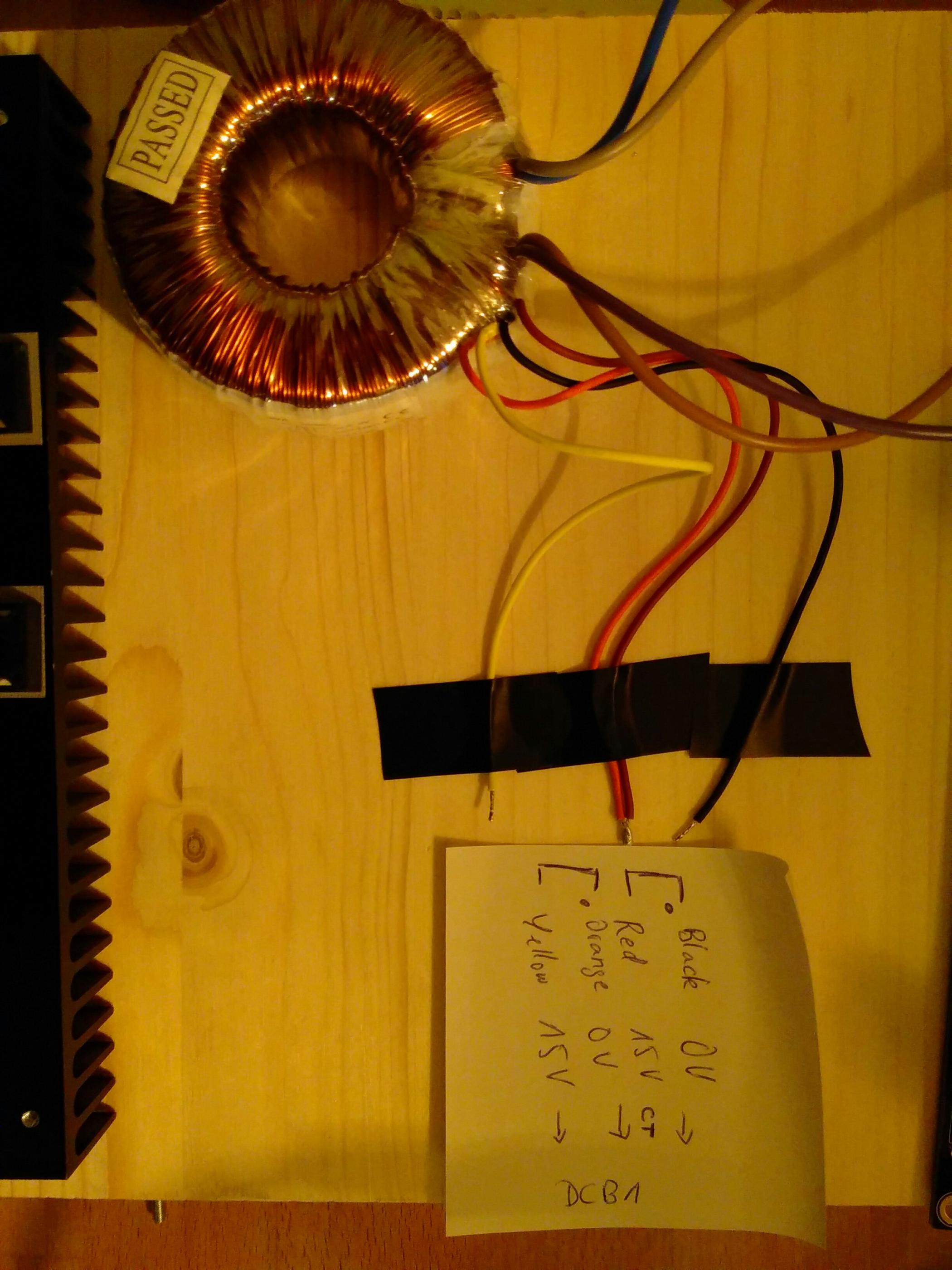

Hello, I am close to finishing my DCB1 build. Before I connect the board to the 50VA 2x15V transformator, however, I want to ensure that I did understand the wiring correctly. I connected the primary side in series due to the 230V system. I also connected the secondaries in series resulting in the three wires shown in the first picture. These three are connected to the DCB1, right? The connection in the middle serves as "center tap". Polarisation of the other two wires doesn't matter.
The second picture shows the finished DCB1 build. Is there anything you recognize as obviously wrong? I don't want to blow up all my work due to a stupid mistake 🙂.
Thank you.

Stefan, I think it is for you to ask your question in the Salas hotrodded blue DCB1 build thread. People there are a lot more familiar with your board.... Is there anything you recognize as obviously wrong? I don't want to blow up all my work due to a stupid mistake 🙂 ...

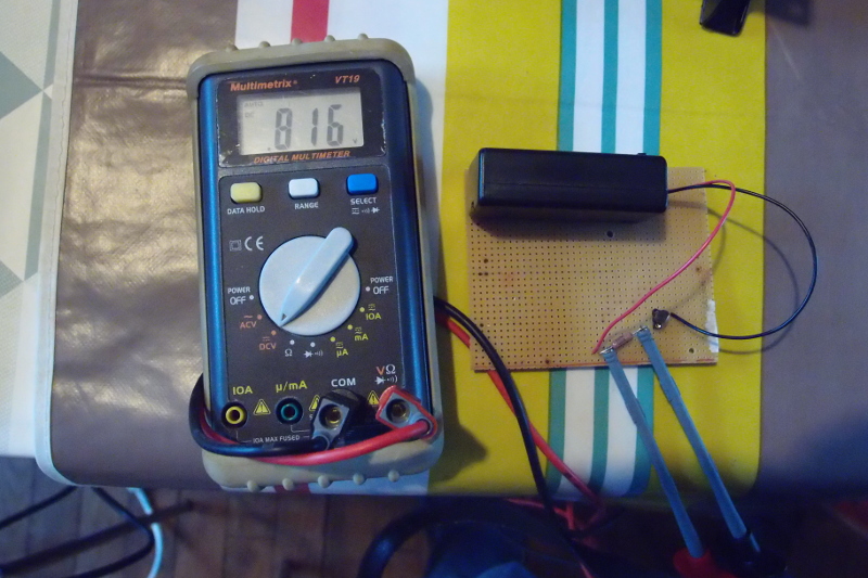

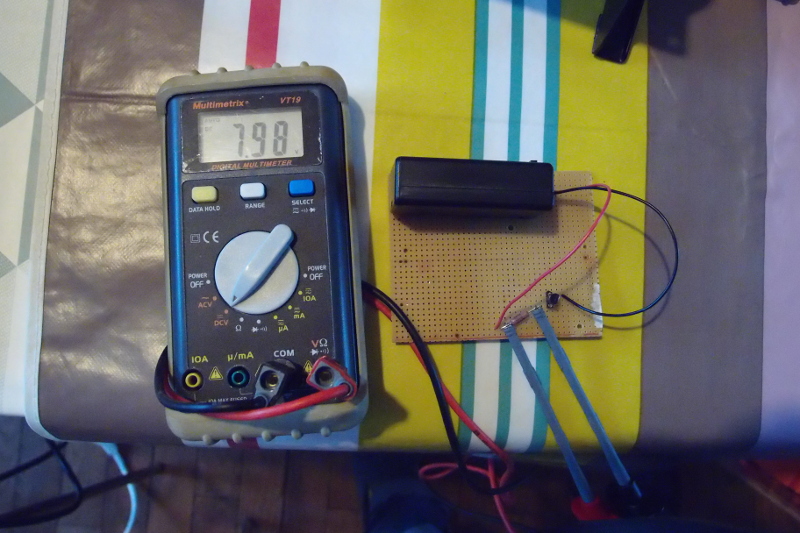

I just desoldered and test the J-Fets.
Q101: 0.816V
Q100: 7.98V
(R is 100.6 ohms)
Given what AndrewT said above,Q100's measure looks strange...

The 0.816Vdc across a 100r indicates 8.16mA when Vds = ~8.2Vds
The 7.98Vdc says it is broken, (79.8mA when Vds~1Vds)
BTW, that resistor will have been overheated, it was dissipating ~640mW. If you need to re-use, then do so in some non audio location and not for calibrating devices.

OK. So I have to change Q100.The 0.816Vdc across a 100r indicates 8.16mA when Vds = ~8.2Vds
The Jfets from PassDIY are matched, so I presume I have to change the four 2SK170...
I measured the ten transistors from the Boozhound kit. There four matched at Id around 5.3mA and four other around 3.2mA. Is there an Id requirement for the B1?
The test was not long, but I'll put a new resistor on my test bench.BTW, that resistor will have been overheated, it was dissipating ~640mW. If you need to re-use, then do so in some non audio location and not for calibrating devices.
