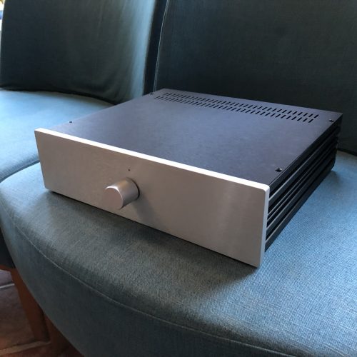

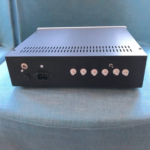

Finally my B1 is up and sounding fantastic! A perfect match for M2 and horn speakers (102dB).
50VA transformer, Salas BiB (19V), B1 PCB from passdiy, chassi from modushop.biz
The inside image just lacking cables from the regulator. Front with a not blue led 😉 .

Yes it is. I had a Toroidy 300VA in my M2 but upgraded to a Toroidy 500VA. They perform well. I like the filled center and the m6 bolt holds them quietly in place.
Nice Mundorf Caps. they are huge!
The size surprised me as well. 🙂 They are certainly not a necessity and I can not give them all the credit for the good sound. It was fun building though.
