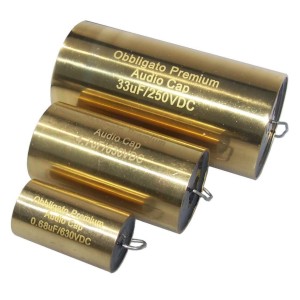

Obbligato Gold Premium 10 uF
Hi KaD,
Have a look: Obbligato Gold Premium Caps | Diy HiFi Supply

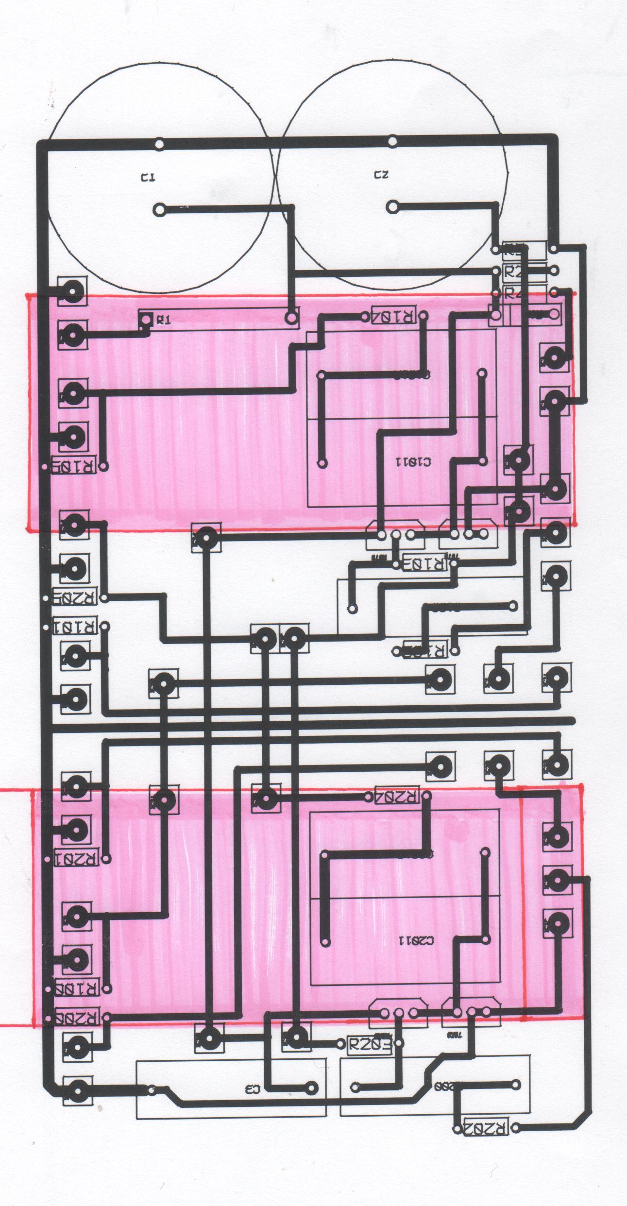

OK I've gone for the Obliggato 10uF Paper in Oils.
BOY. They are HUGE. 95mm long and 40mm Dia.
This is going to be fun trying to get them to fit.
There is space but I'm going to have to raise them off the board to clear the other components.
This is going to be mini re-build.
The transformer is being replaced by a 30VA toroid. I'm going to replace the capacitive multiplier with a CRC circuit and the output caps are being replaced with the coke cans. The outline of the PIOs is shown highlighted in PINK.
I'm wondering wether to retain the regulator or just let the B1 run with a good CRC filter. Its 4700uF + 1R0 + 4700uF. More than sufficient for the B1.
I originally didn't have the regulator, it doesn't seem to have made much difference.

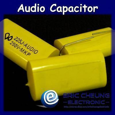

I've just received the Chinese Audiophile caps from E-Bay.
On inspection they are very small compared with the 1uF WIMA MKS4 caps that I'm currently using.
(Yes I know the value in the photo is wrong - it's a stock photo)
Looking at the original Pass B1, the input caps are simple blue dots.
I'm still going for the Obligatto 10uF PIOs for the outputs, but has anyone any experience of these Audiophile (Yellow Caps) compared to the MKS4's as input caps ?
I've got some 3.3uF 750V WIMA MKP4's that I could use as input caps but they are much bigger than the MKS4's that the board was designed for.

You shure do ask a lot of questions considering your experience. From what littl ei know of Mr Pass, he tends to place his emphasis on the active devices and the topology more so thatn the individual components. This is not to say he doesn't have preferences, but realizes that each person has his or her own opinions and tastes. Most of his schematics leave great freedom in part selection based upon personal opinions. Both caps are in the signal path, so they both have an affect. The only way you are going to know is to try. Search the forum for preferences in your price range and swing away.
