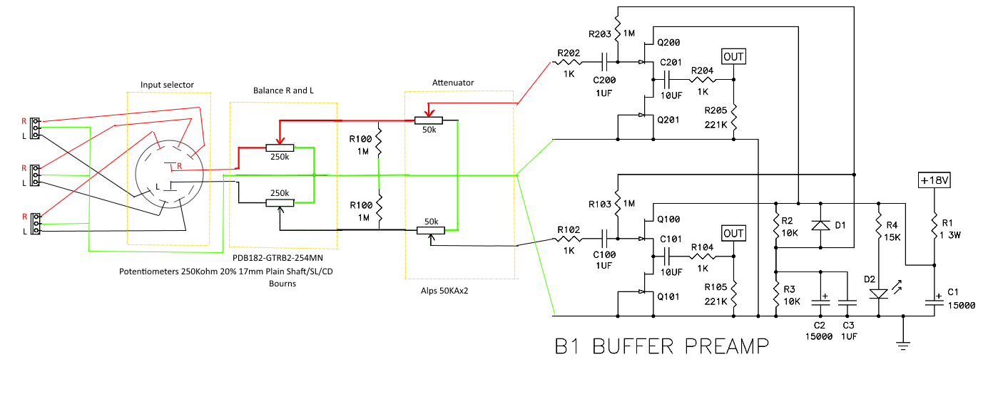

getting 6Vac from an 18Vdc supply will right at the limit of visible clipping.
But long before you get there, there is an increase in distortion. Initially it's mostly second harmonic and because it's a Follower without global feedback it can sound quite acceptable.
Because of that increasing distortion with signal level, many advise a maximum signal level of ~ half the clipping level, i.e. <3Vac from an 18Vdc supply. This fits well with most CDP and other high level sources which top out at around 2Vac to 2.5Vac.

Hi All,
i am thinking to add :
input selector,
balance Pot,
Pot attenuator,
any obvious mistake in my sketch?
thank in advance guys!
