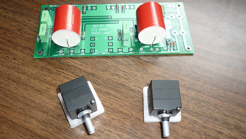

after 2.5 years i have my B1 running, only took me long enough 🙂
Will post pictures of it in the temporary case for now to work bugs out and do more testing with different caps and stuff.

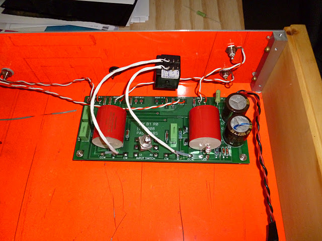

Did you have problems with it ?
My worked at first attempt - and perfectly to boot.
I'm just playing with caps to brighten it up a bit.

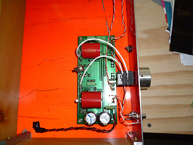

Pictures.
Picture of the board & 2 pots. One pot is for the B1, the other is for a Passive pre-amp im going to build.
It's in a spare case that a friend made me, for testing propose..
Can you please explain why a cheap pot might be better than the more expensive ALPS ......
I've got cheaper pots but the channel matching is appaulling.
The Power Amp is a Pass Aleph 4. I think its bandwidth probably saved the speakers...
