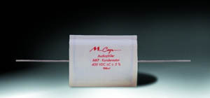

OK. I've cut corners with my B1.
Where do you think the greatest impact will be in improving it.
My Transformer is minimal - only 15VA it does feed a MASSIVE capacitive multiplier and then is regulated. There is NO noise on the B1 at all.
C100/200 are simple WIMA MKS4 1uF
C101/201 are 2 x 4.7uF Metalised Polypropylene Drops of unknown origin (Ebay)
I've ordered some 33uF Mundorf Caps to replace C101 and C102, these are bypassed with 1n5 Polystyrene.
This thing is BLACK AS THE ACE OF SPADES sonically. It is SILENT. The BASS is nice and TIGHT but the MID/HIGH just needs to have a bit of sparkle added to it.
I'm also hoping to get some 1u5 Auricaps to replace C100 and C200.

Output cap is greatest opportunity for affecting sound. I would suggest Obbligato Oil as quality inexpensive choice. Get a bigger trafo and drop regulator and build as Nelson designed or try DCB1 for what i believe is an upgrade. The B1 is not really suppose to change or add anything, at least that is the concept.
