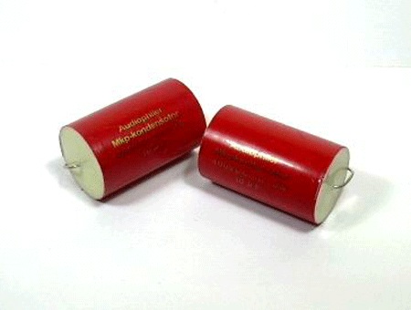

I've got some AudioPhiler 1uF Polyprops but they were slated in a previous post.
I've also got some WIMA MKP4 1uF 750V but they are HUGE compared with the MKS4 400V.
MKS4 is POLYESTER
MKP4 is POLYPROPYLENE.
There may be some improvement by simply trying any POLYPROP in place of the current MKS4's.
