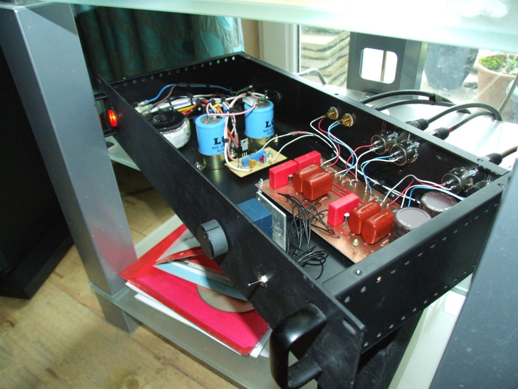

Well, Phase one of the rebuild is now complete.
I have replaced the Capactive Multiplier with a CRC combination and the 15VA EI transformer with a 30VA Toroid.
The sound is still "BLACKER than BLACK", but it does seem to have livened up a bit.
I'm still using the LM317 regulator.
Could the reduced impedance of the 30VA and CRC driving the regulator make that much difference ?
There's always the factor that we all want to hear improvements when we are "playing".
Reduced supply impedance can make it sound different.
Reduced noise passed from Mains to buffer can make it sound different.

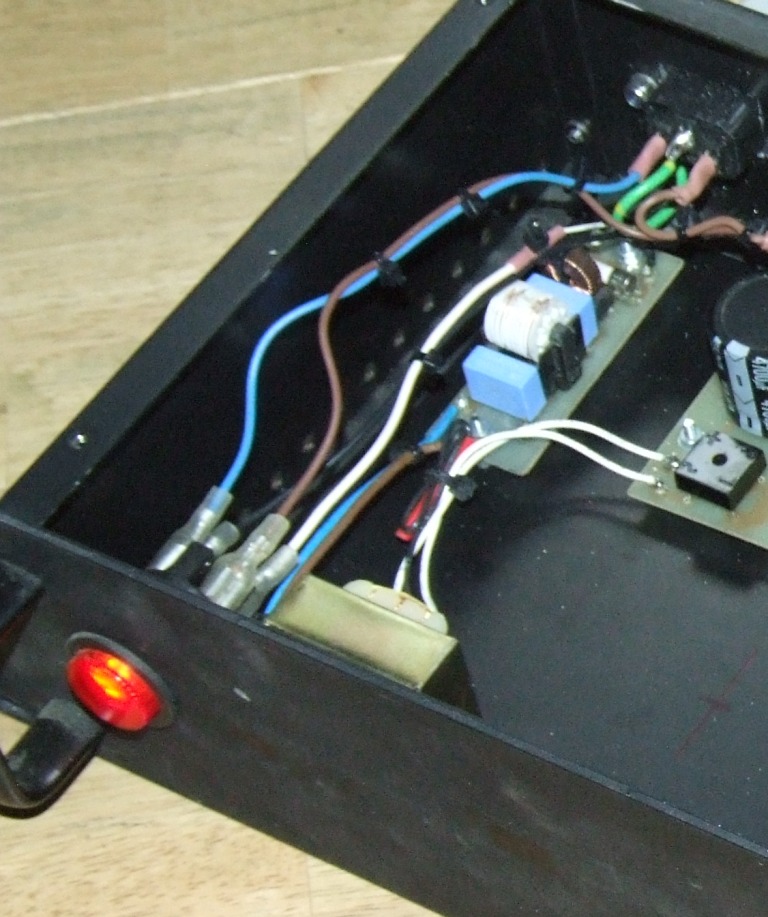

I've been very careful with mains filtering but I know there is a difference in the way that EI and Toroids isolate mains born noise.
I've got a mains filter at the input. Pinched from an old VCR. This is two bi-filar toroids and two X caps .
After the TR / Bridge I've got 4700uF + 2R2 + 4700uF then it goes to the regulator.
The result is a BLACK silence that I am more than happy with.

I must re-emphasis that a proper PSU as opposed to the Capacitive Multiplier has made quite a big difference.
As this is only a PRE with 20mA or so of load - how many Power Amps are being compromised with poor PSUs ?
As a PRE it has over 40000uF of capacitors - all computer grade in its PSU.
Its a long winded CRC - REG - CRC circuit - But it is ABSOLUTELY SILENT.
Call it OVERKILL but it works.
