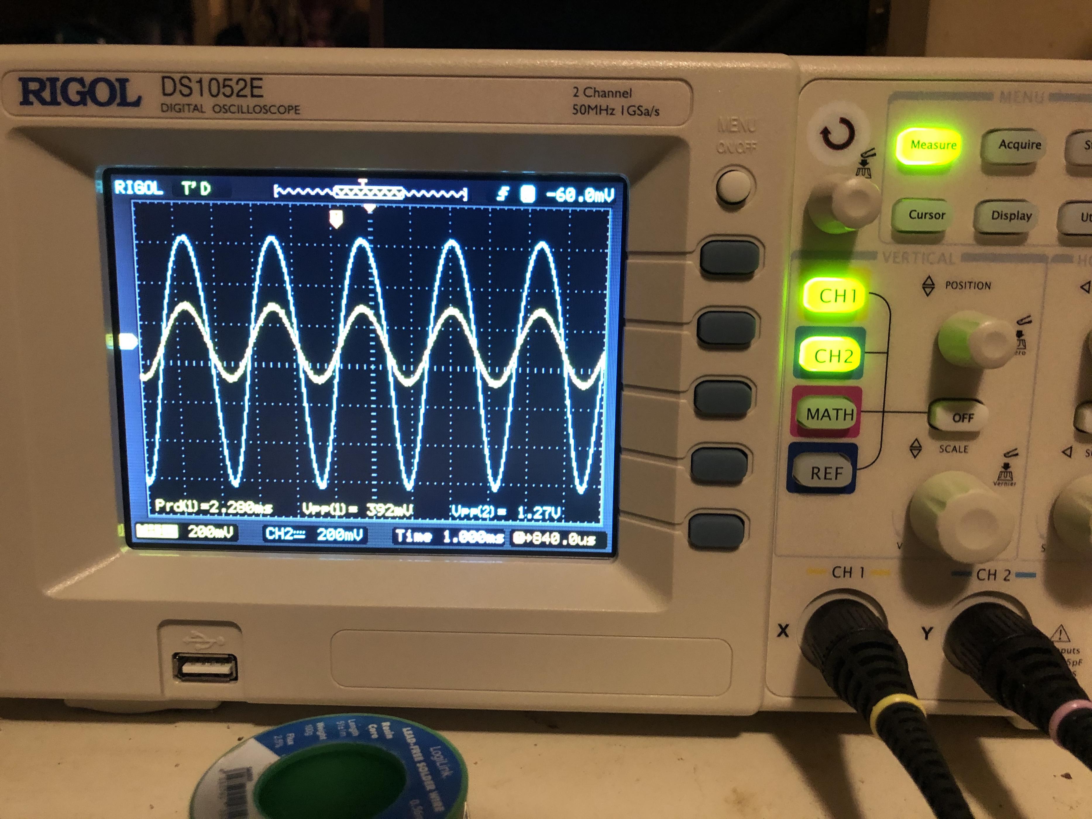

I have ran a few sine waves through the B1 now. Everything looks normal to me. However, sound is still terrible. I am connecting it to a Moon DAC and two Amp Camp Mono blocks. I just cannot get what the problem is....
Hi - no the 1,27 volts is the output from the B1 - the yellow signal is generated by my computer and measured at the input to the B1.
Sound is clearly distorted, overdrive is not unlikely. Not "sweet and creamy", rather sharp and not agreeable. I agree on the difference between pos and neg. I will do some new measures tonight and post them - anything in particular I should focus on?
I did some new measures - no DC on output. Also did some new sine measures with the scope. Everything looks fine until I measure after the JFets - then the negativ sving differs from the positive. When I measure the DCvoltage across the JFets Q100 and Q200, I noticed something strange: the gate has 1/2 the supply voltage as expected, but the source is the same as the supply - isn't the source supposed to be half the supply?
