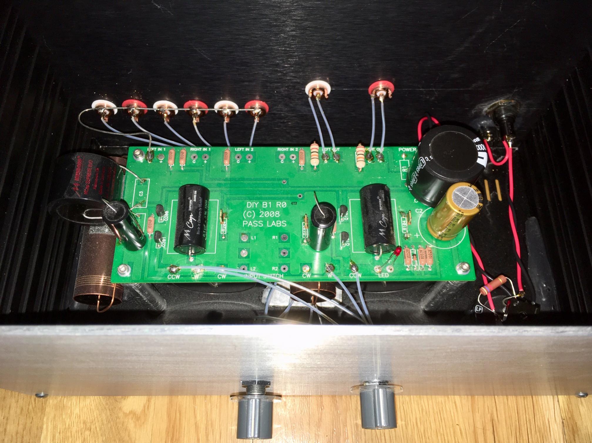

- I inherited a bunch of electronic equipment and such from my late grandfather's workshop. Including a solid copper chassis from an old RCA voltage amp. No reason not to use this for a B1, right?

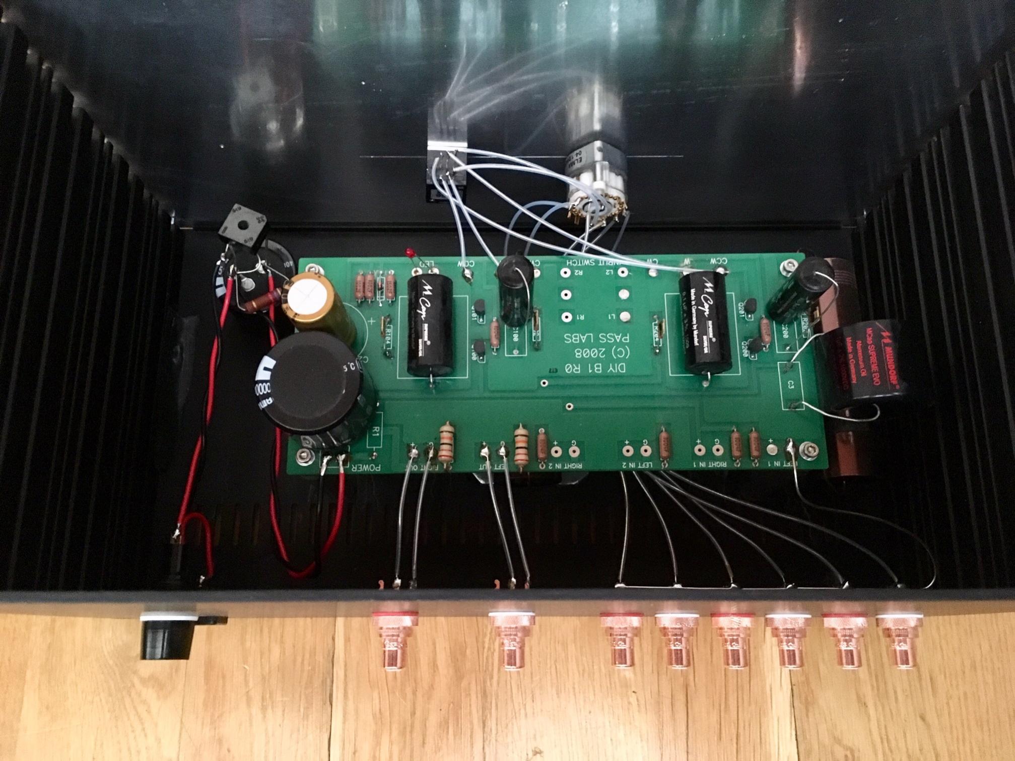

- I've cascaded three film caps together for C101/C201. What's the most elegant way to get a thick cap lead(s) to fit into a typical hole on a circuit board? Clip some of the strands until it fits through? Solder on a single copper wire? (I've done the former but am open to other techniques.)

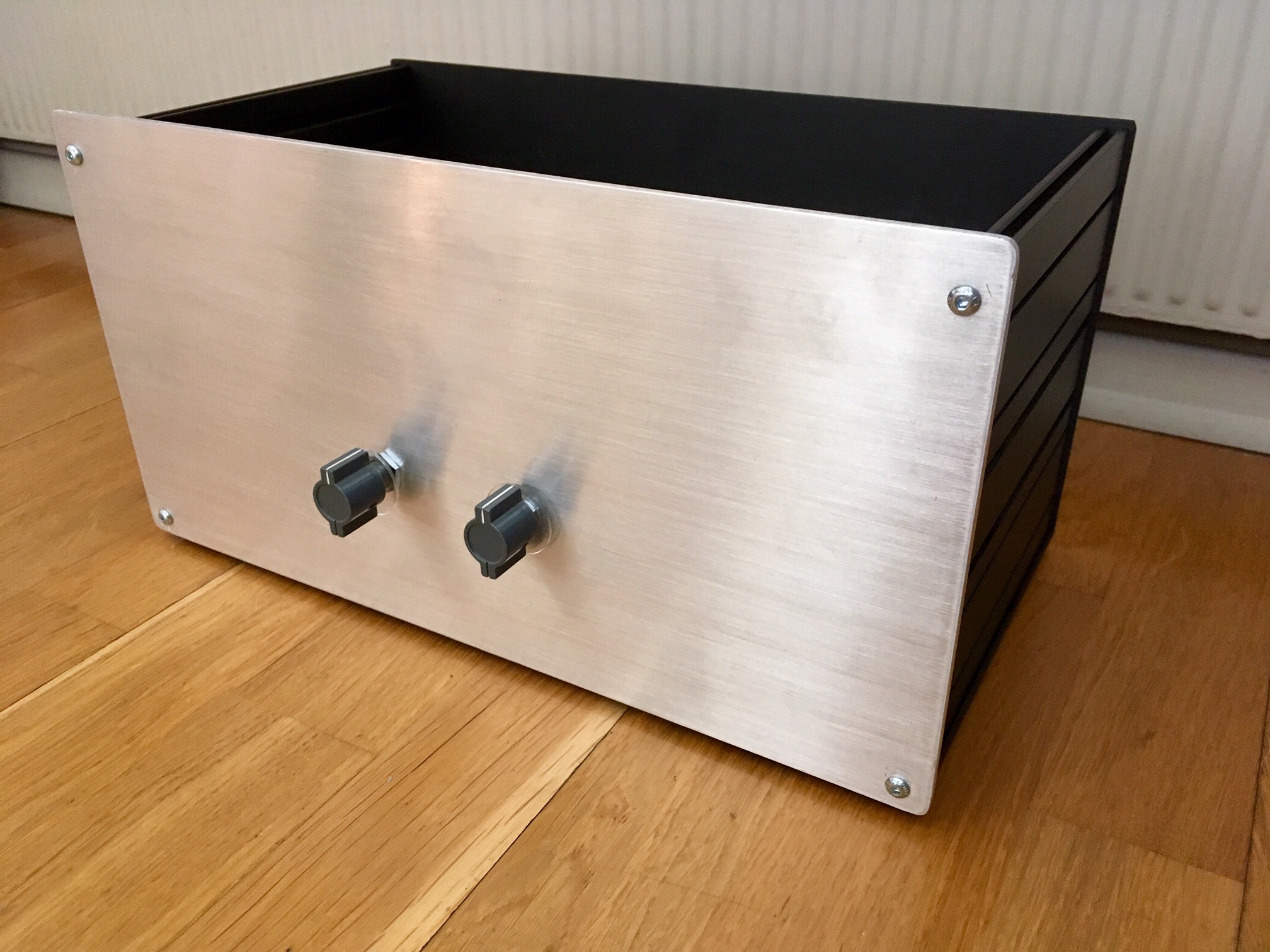

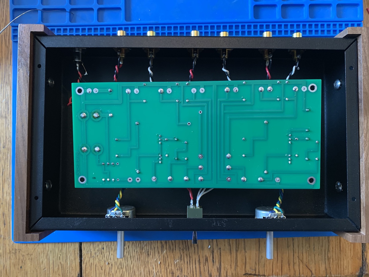

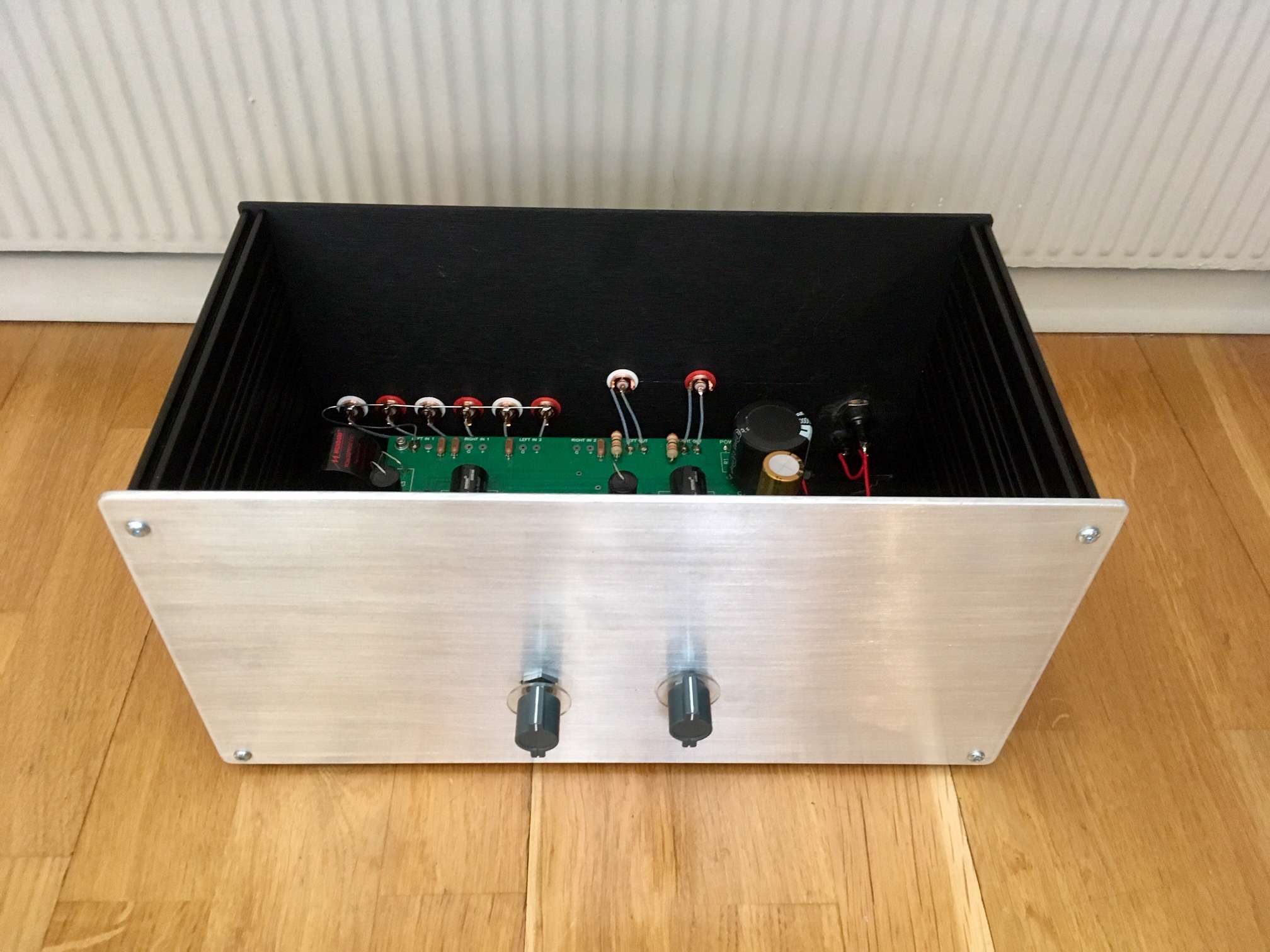

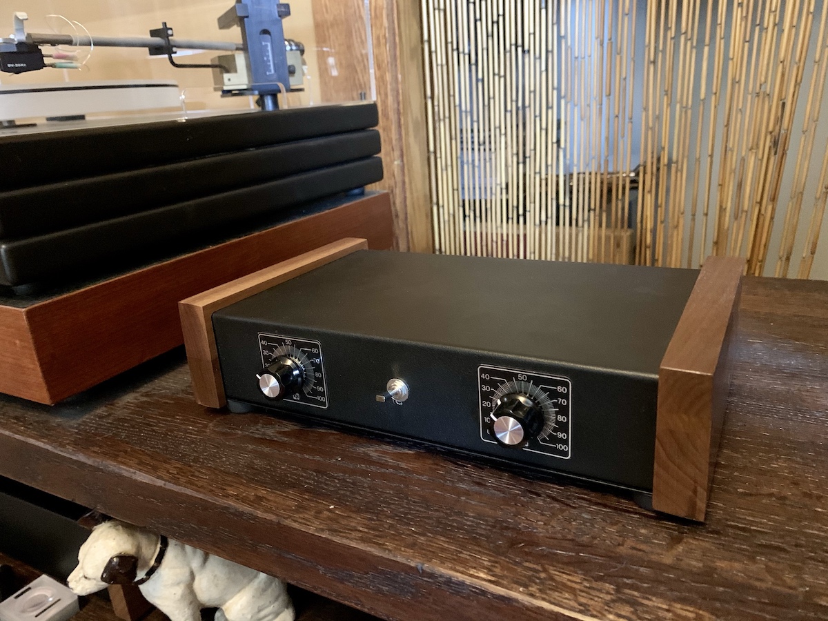

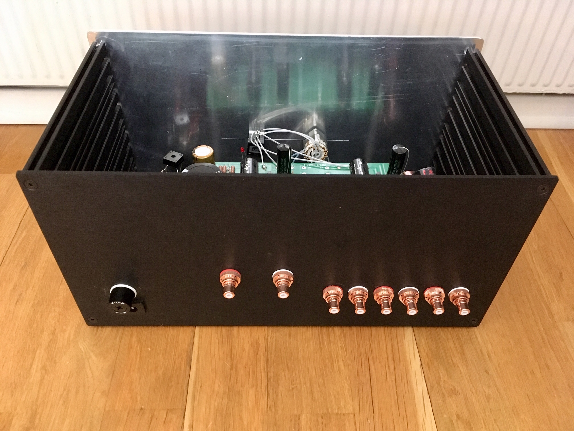

I got tired of looking at the populated board sitting in my office so I finally finished up the enclosure for my B1.

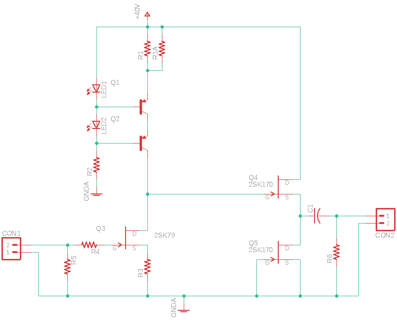

you can, but only if you cascode it, from both sides
then , there are several ways of, practically, introducing additional voltage regs for buffer rails
what voltage swing you're demanding from buffer, in that scenario?
Swing would be about +-10 can't be any more than +-15v. Here is a quick scheme of what I was thinking. Is there a link to a cascode b1?
