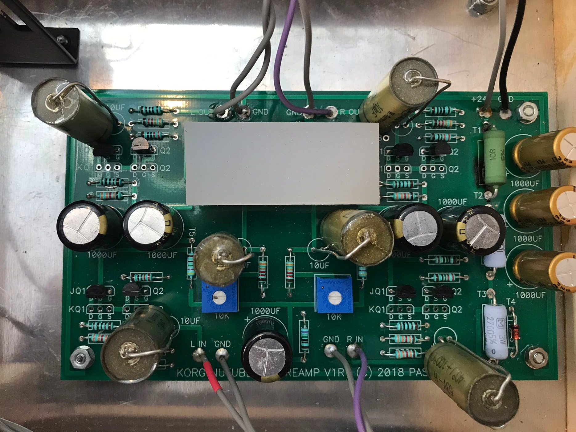

Done!!!! 😀
It seems to sound very good.
The current is about 6 mA per rail, the offset, without pot is 1 mV on one channel and 0,2 mV on the other.
Just one question. In this configuration I have about 14V on the positive drain and about -17V on the negative source. Is it ok or it is too much?

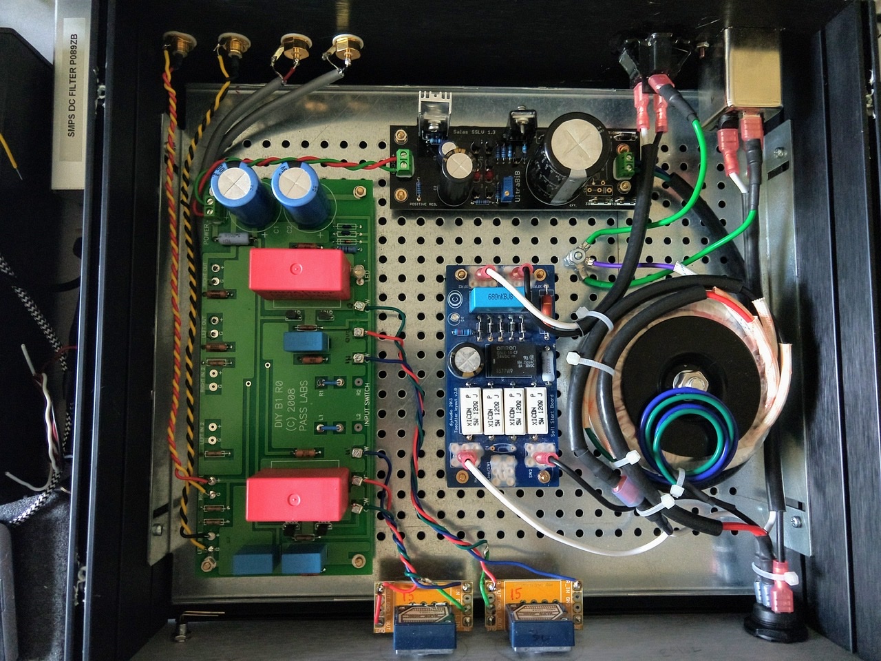

BTW, since this is the B1 forum, here is a picture of my B1 build including the PS using a Salas BiB shunt regulator and a diyAudio store soft start circuit for outgoing power to an amp connection. I use two individual ALPs mono pots. It is a wonderfully simple pre-amp buffer with great sound.
Cheers, Pete
