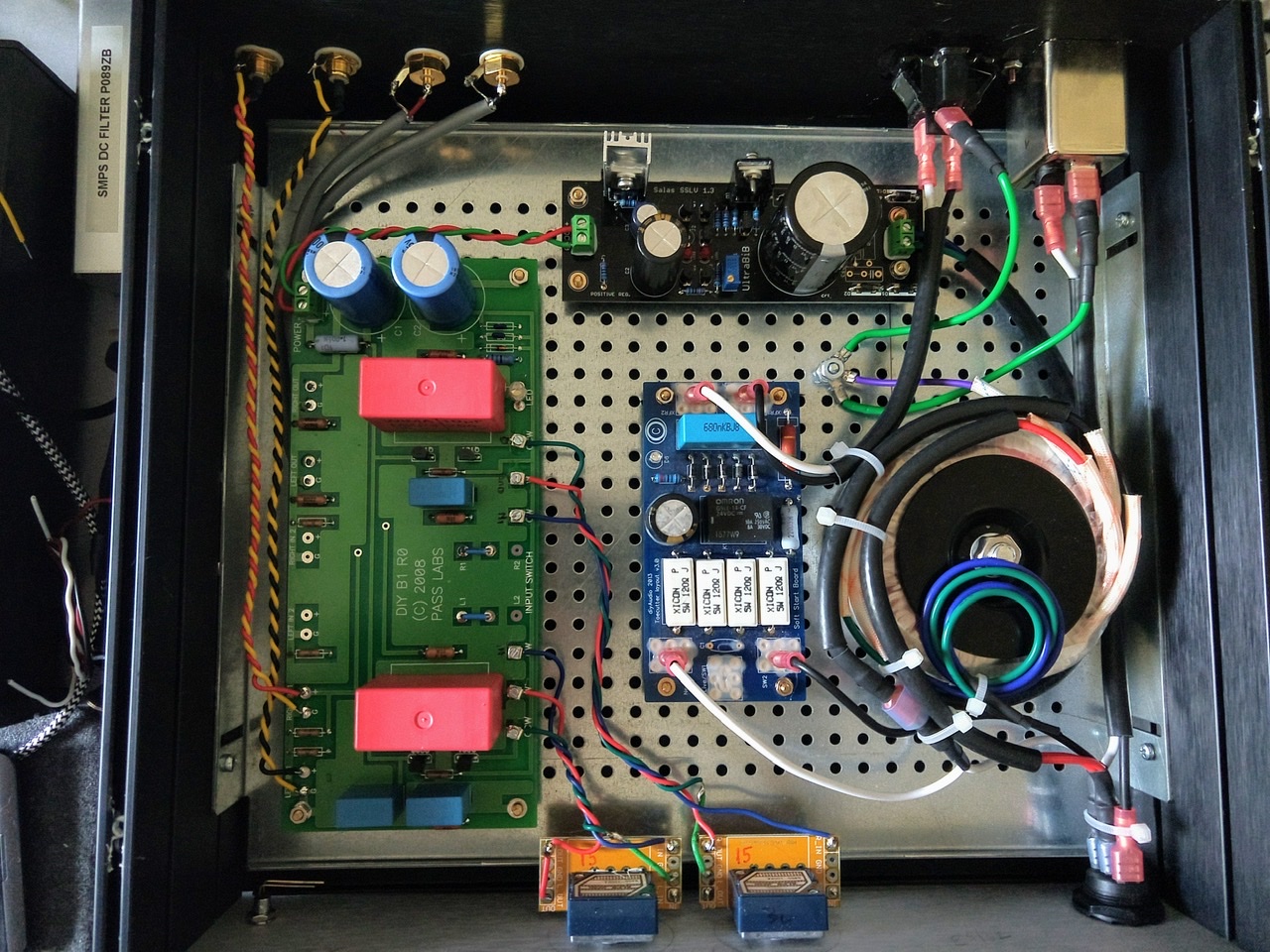

Here’s my B1 build in its Galaxy case
I used a Salas UltraBiB shunt regulator after the toroidal and a soft start circuit (on the outgoing AC line) for amp attachment. Independent ALPS mono pots for balance control. Very clean sounding with a wonderful bottom response. I’ll be fooling around with the 1&10uF film cap positions to try to warm it up slightly.
Thanks to Papa and previous builder for ideas and observations.
Cheers, Pete

Hi, I was using Jantzen Alumen 1uF and Mundorf Supreme EVO Oil. Bouth bypassed with Mundorf SIO.
Building a new now I have ordred V-cap ODAM 1uF, not decided the 10uF yet ( think ODAM there also ). Trying no bypass cap this time. Are all the 4 parts in the signal way likewise impotent? R102/202, C100/200, C101/201 and R104/204?
And if you want to use a extra good part like say Vishay VAR (resistor) in the signal way. Do you place it first R102/202 or last R104/204? Sorry for using your post for open questions, hope its ok ( :
Frank
Frank, when I built mine, is was just easier to put Dales (RN55s or CMFs ) everywhere (R1 may not really benefit from using a Dale, IMHO) and not really worry about which resistor position had greater impact. It’s really not greatly expensive since there really isn’t that many resistors used.
Both the 1uF & 10uF caps (C100, C200, C101, C201) will have impact on the signal (some folk argue it’s all in one’s head) and if you really wanted to get exotic, you certainly could upgrade R102, R202, R104, and R204 to Z-foils, Audionote Tantalums, PRPs, Takmans, Shinkohs, etc) if you want to spend the $ and guide the SQ. Anything directly in the signal path should (probably) be considered important.
