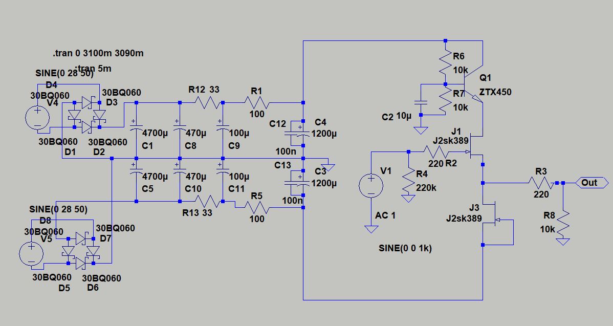

My passdiy.com B1 pcb & FETs should arrive in the next day or so, and I need to order parts to stuff the board.
I recently built the B1Korg and note that resistor values are quite different -- 100R in the output instead of 1K0 in the original schematic, for example.
Have values been optimized since 2008, is there a schematic somewhere that shows the current thinking on all this? The Korg B1 values are quite different.

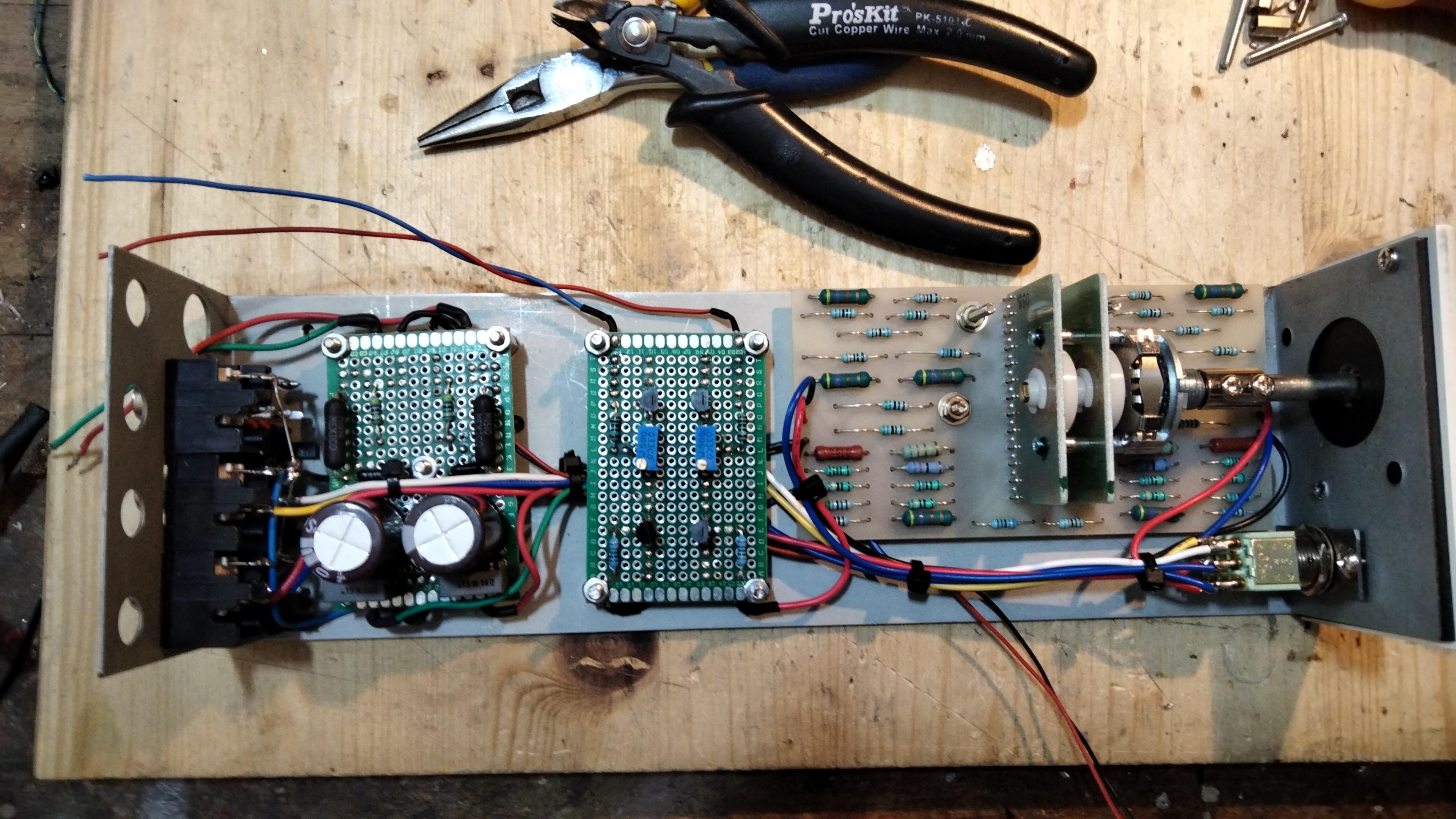

Papa/ZM's experiment with symmetrical PSU on B1 using 4x2SK170 inside an old Japanese attenuator :spin:
