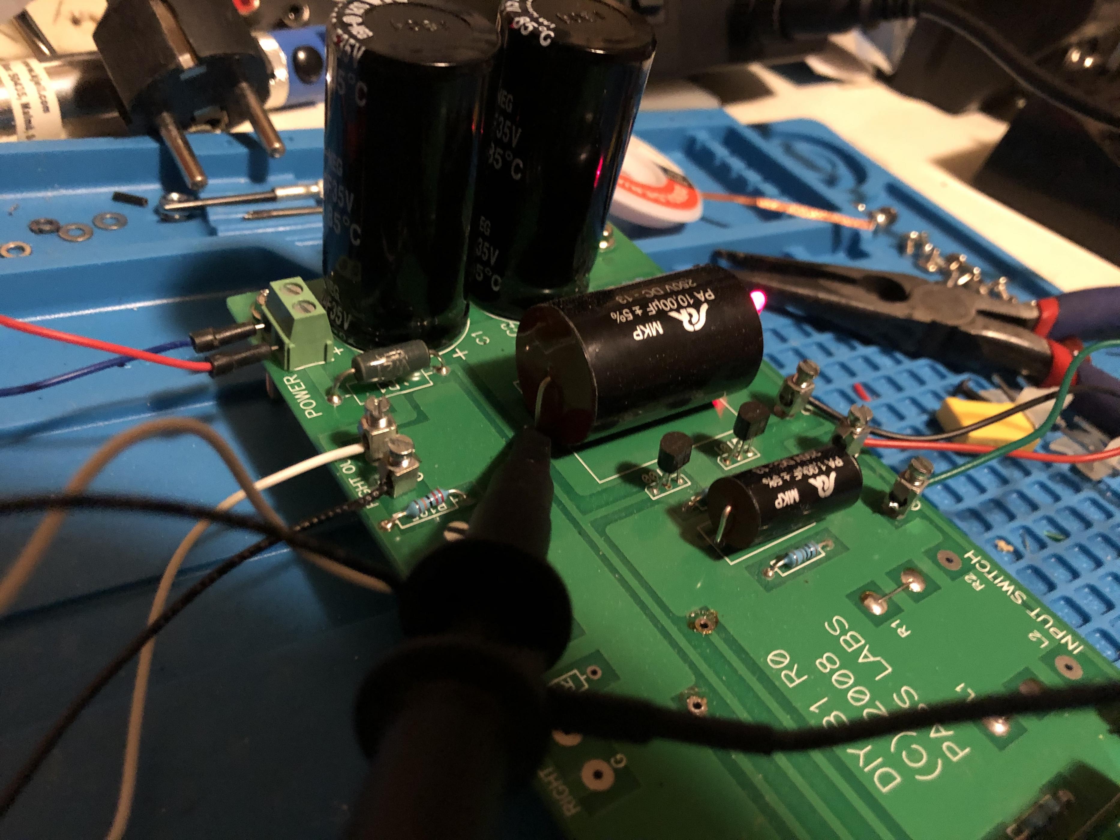

I could only successfully measure it at C201. That is also where the swing begins to look weird. See pictures.
You can measure the current indirectly by measuring the voltage drop across resistor R1 and use Ohm's law to calculate current (I = V/R).
The circuit in the PDF shows a LED and the voltage divider that goes to the gate connected to the power supply in addition to the JFETs. So, if that's what you've got, that is about 2mA (18V/15R + 18V/20R) and the rest feeds the JFETs.
Well, my only conclusion so far is that weird things happen once the audio signal passes the JFets - it seems that there are two plausible causes: 1.) too high bias voltage (which does not seem to be the case) or 2.) damaged JFets. I am leaning towards the latter. Only problem is that it is really difficult to get hold of LSK170, probably need to order new ones from Diy audiostore.
