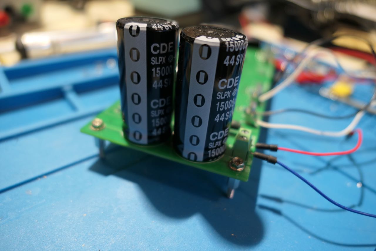

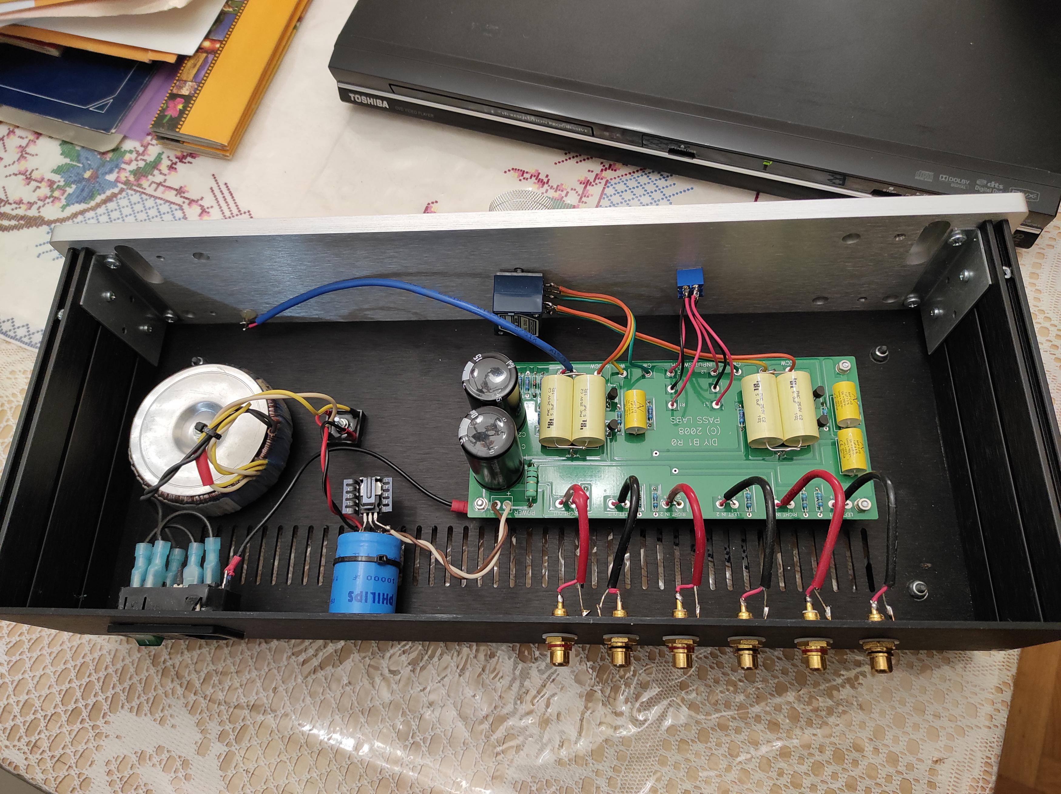

I am revisiting this post ~10 years after building my B1. I just wanted to encourage those thinking about building it to do it. It is quite a simple build and generally will not require troubleshooting. For fun I did my B1 in a point to point manner (no pcb) and put it in a simple enclosure.
My build is still working great with an 18v external laptop power supply after 10 years. I use it regularly in the garage coupled to a diy amp and mainly use a bluetooth receiver for input.
a few pics
Cheers
Ditto that, this pre still top’s any other thing I have built so far

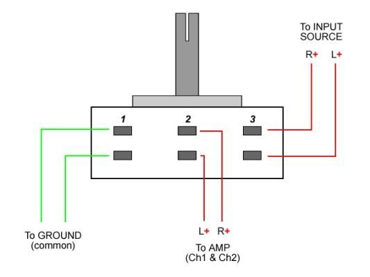

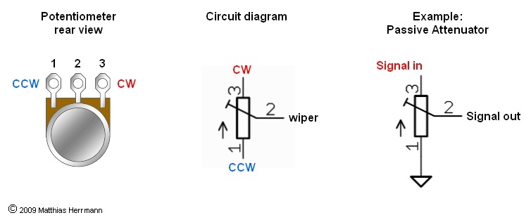

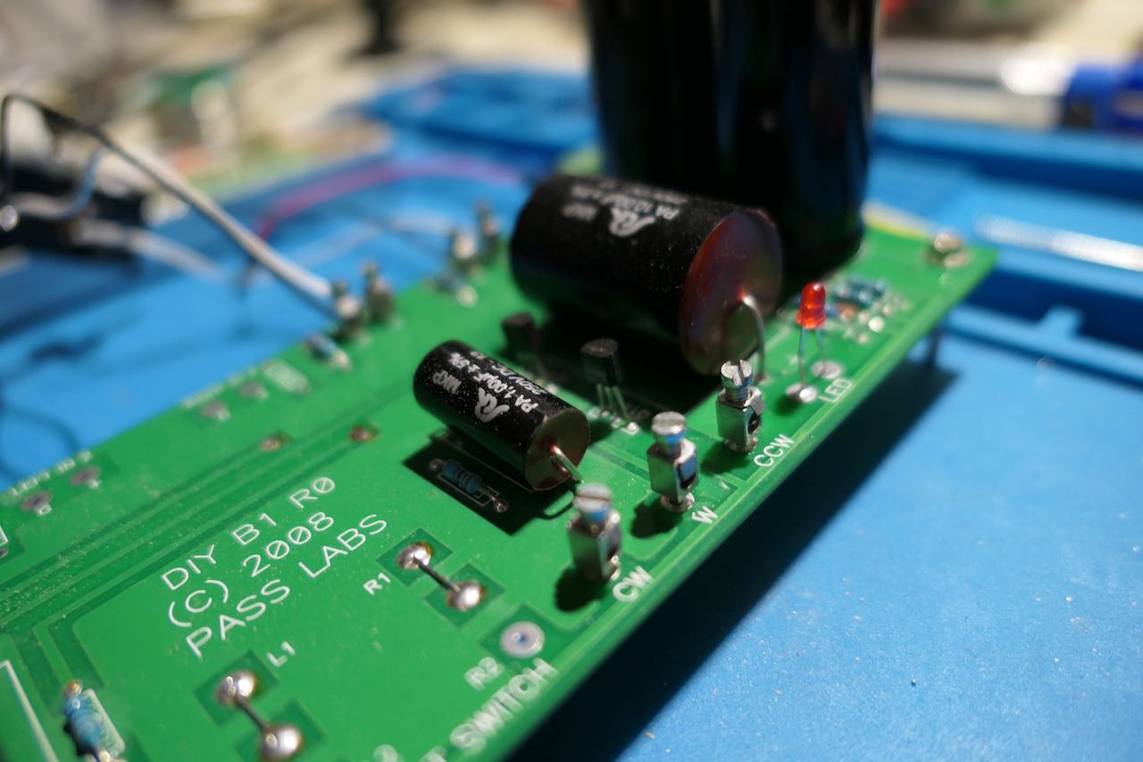

I have the Pass B1 board.
I'm not sure how to wire in a Alps27
The board has CW, W and CCW.
The pot of course has pins 1, 2, 3.
Thanks in advance.

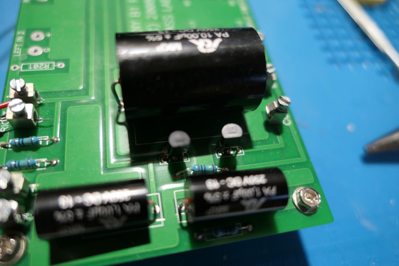

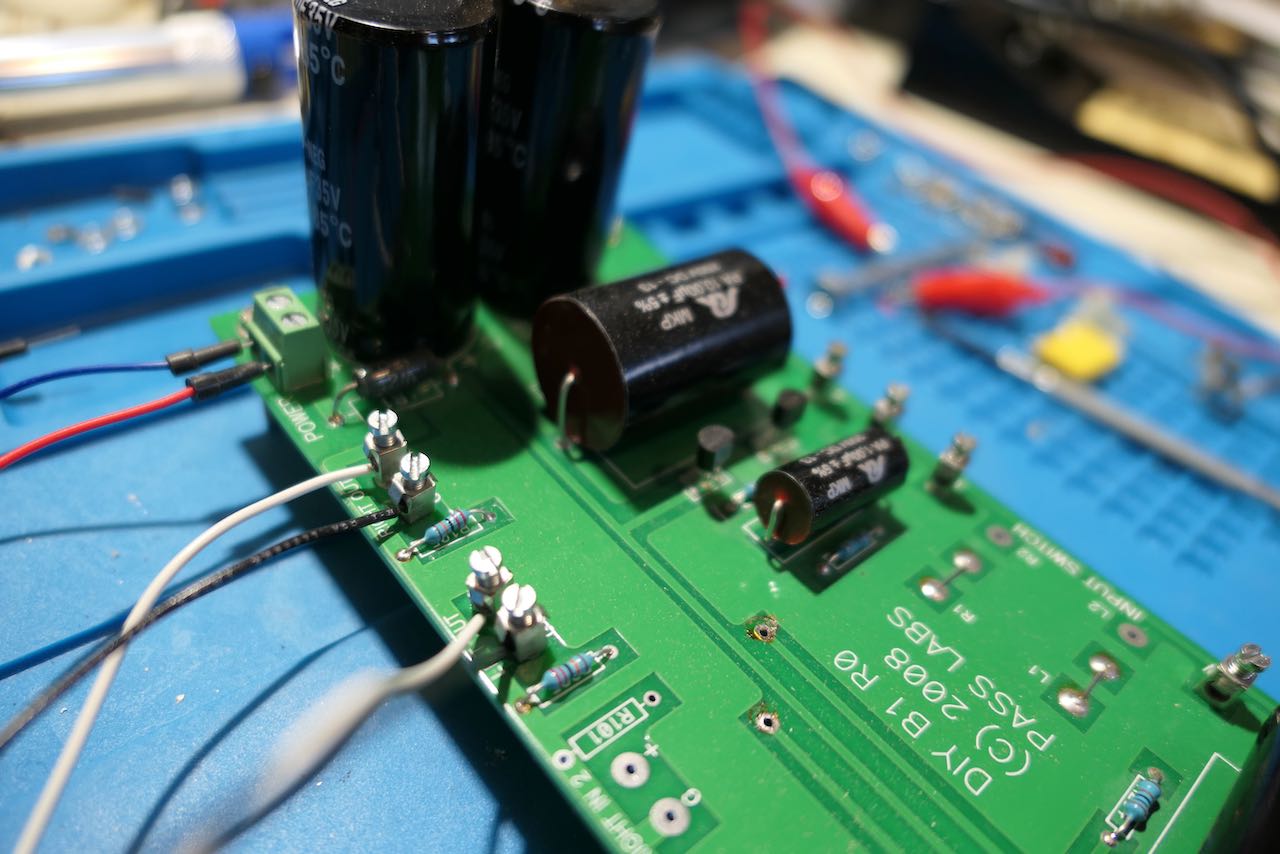

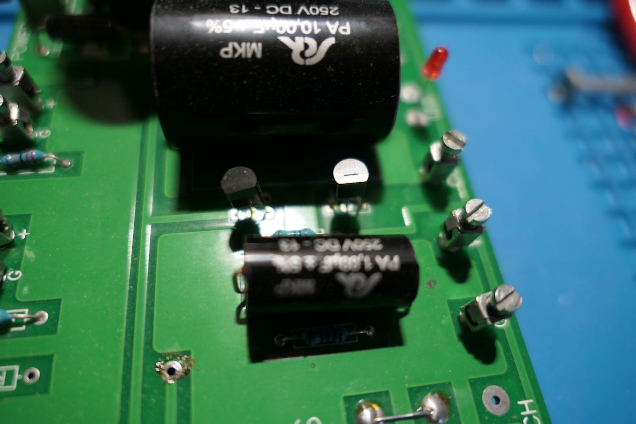

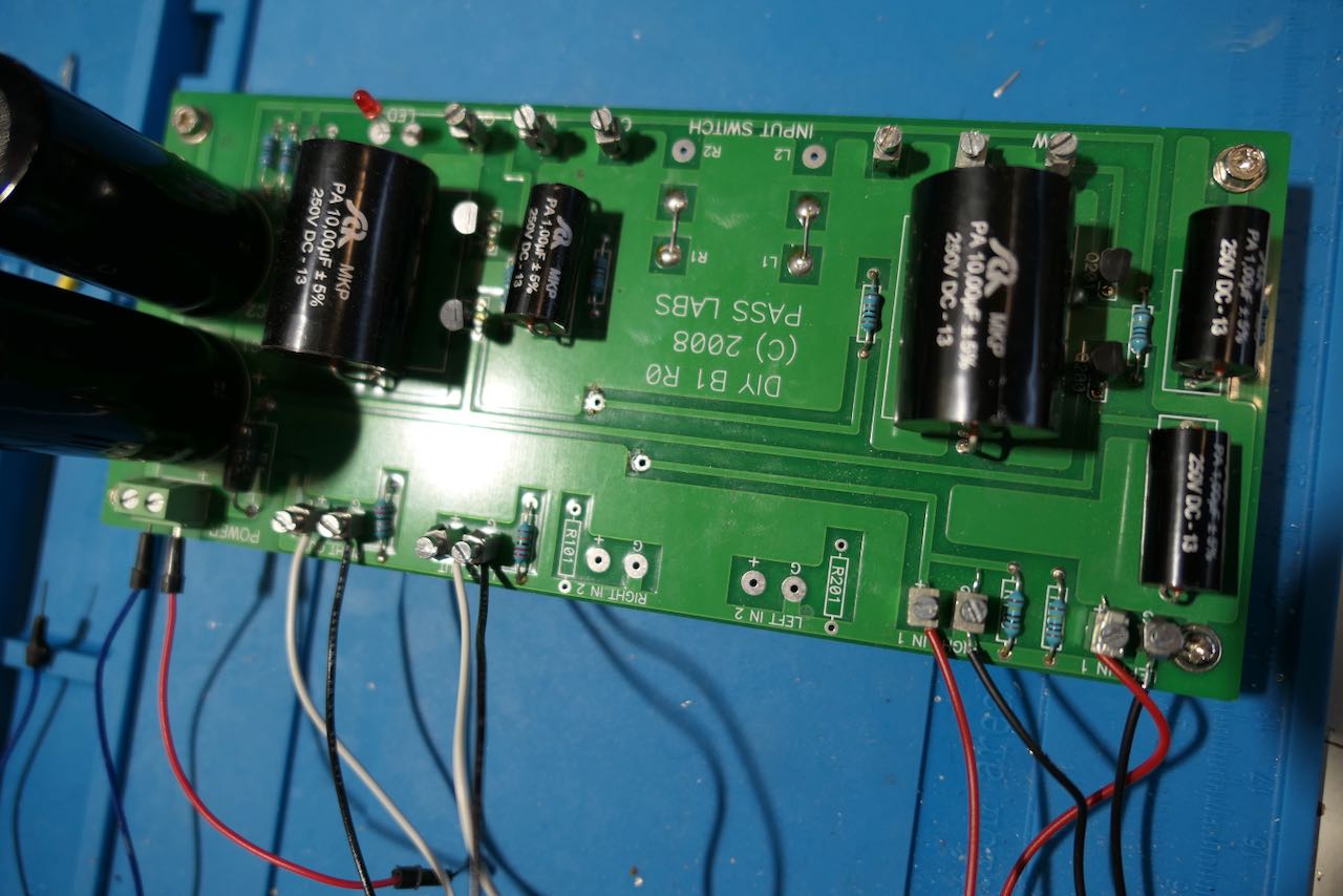

Hi guys - I got a stuffed B1 Buffer PCB (think 2008), seems to be well-soldered, high quality components and the correct JFets. It powers up, BUT there is a terrible distortion coming from somewhere in the circuit. Otherwise it is dead silent, no hum or anything (as expected). Only distortion when playing sound. I connect it to an amp camp which works just fine with my other gear, so no problem there. What could it possibly be? Bad cap? All parts seem to be in the right place and I have measured the resistor values as far as I can without ripping it apart completely.
JFets in proper positions?
JFets of trusted origin?
vol pot properly connected ?
btw. those screw connections are not making your life easier ......... only less predictable
what's wrong with plan old soldering?
JFets in proper positions, and yes they are trusted origin (from DIY audiostore). Have only tried one vol pot, but to my understanding it was properly connected. Even tried just connecting a resistor. My first try was to solder the connections directly to the board, but I wanted some flexibility so I attached to screw connections.
Question: What would happen if the polarity accidentally had been reversed (ground to positive and vice versa)? That was my first idea. Obviously, the polar caps could be damaged, so I exchanged them.

same distortion in both channels ?
