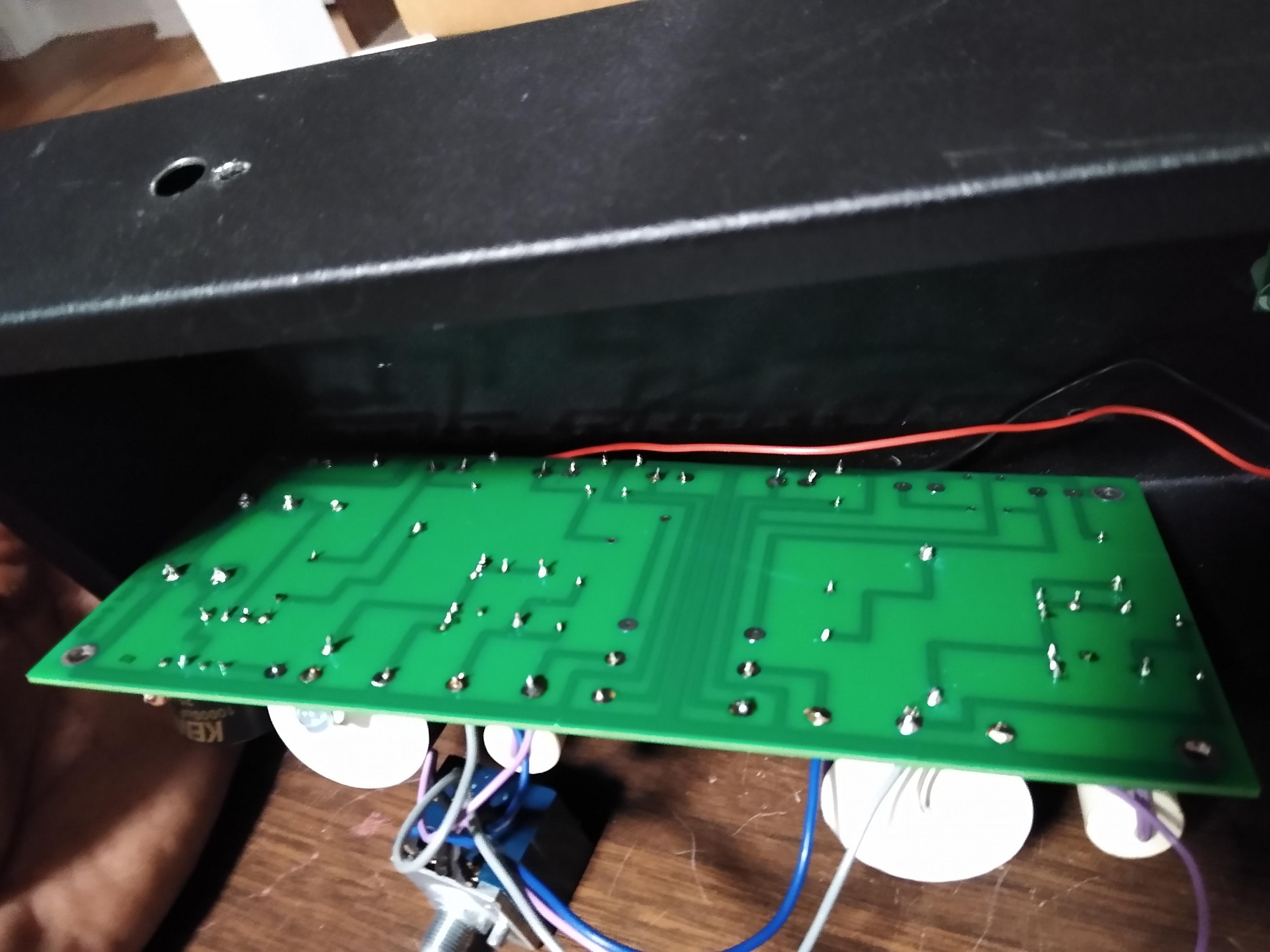

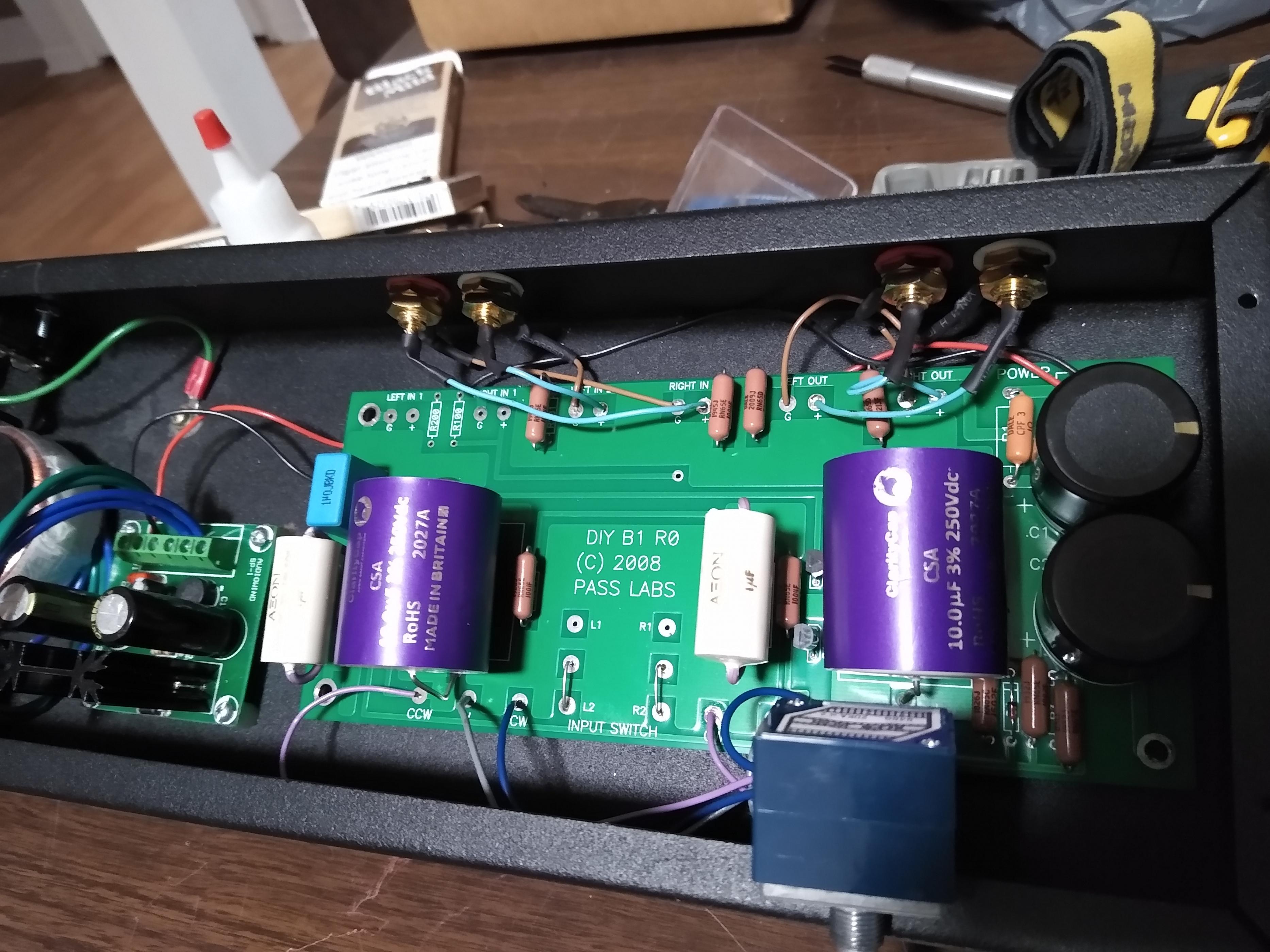

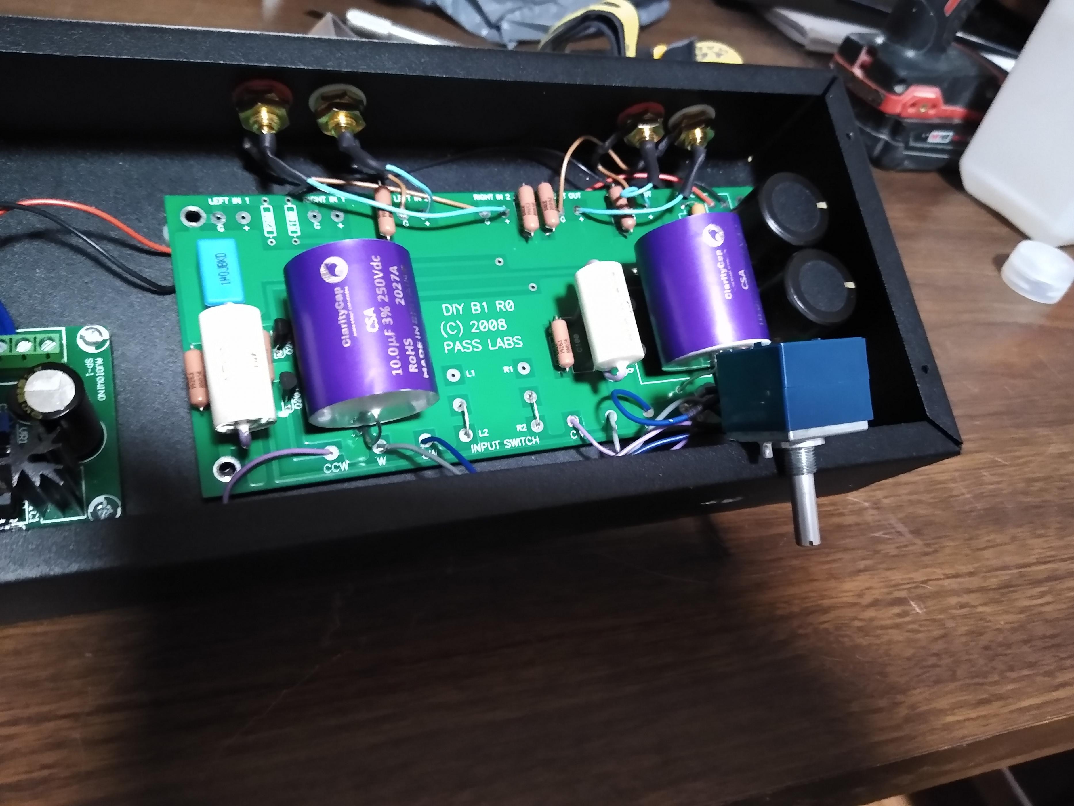

Channel imbalance
I built my B1 a few months back and have been very happy with it. But while trying to setup an active crossover the other day, I measured less than half the output voltage on the left channel than on the right. I've double checked all my solder joints and the correct value and placement of all parts. Everything looks right. So I'm a little stumped. Funny thing is I've never heard this imbalance while using the B1, which at half the output seems like it would be apparent. Has anybody had a similar issue?
Crappy pictures, I know. I will take some better one tomorrow when I have more light

Quote:
"Swap the volume control wiring L/R channel assignment.
If the imbalance stays in the same channel, it's in the boards, if it changes sides, the volume control is the issue."
Great advice.
Blue ALPS are known to have sometimes small and sometimes (many more times) big channel disbalance.
Worth keeping in mind.
After I posted earlier I took some measurements trying to track down the problem. Playing a sine wave through the B1 with the pot maxed I measured full voltage being passed for both channels at the pot pads on the board. I measured full signal at R102,202 as well. At the output caps I measured half voltage with the left channel. The output caps are so big I can't measure at the fet pins. And with the way I have things wired up I would have to desolder the rca connections to remove the board from the case. This was my first diy electronic project. I'm thinking I may have damaged the fets when I soldered them
