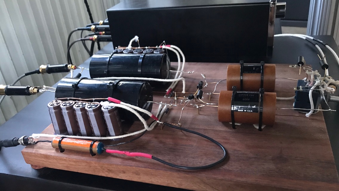

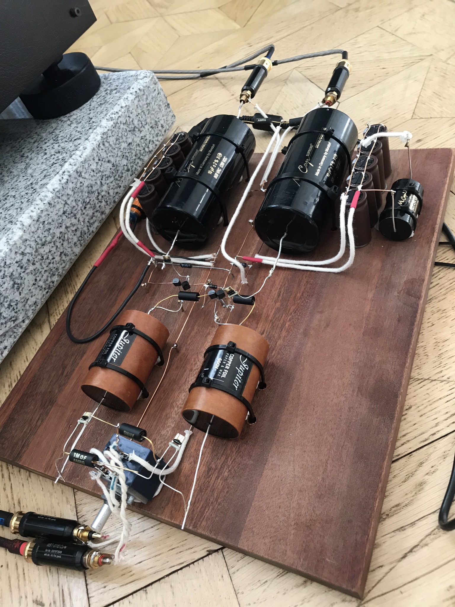

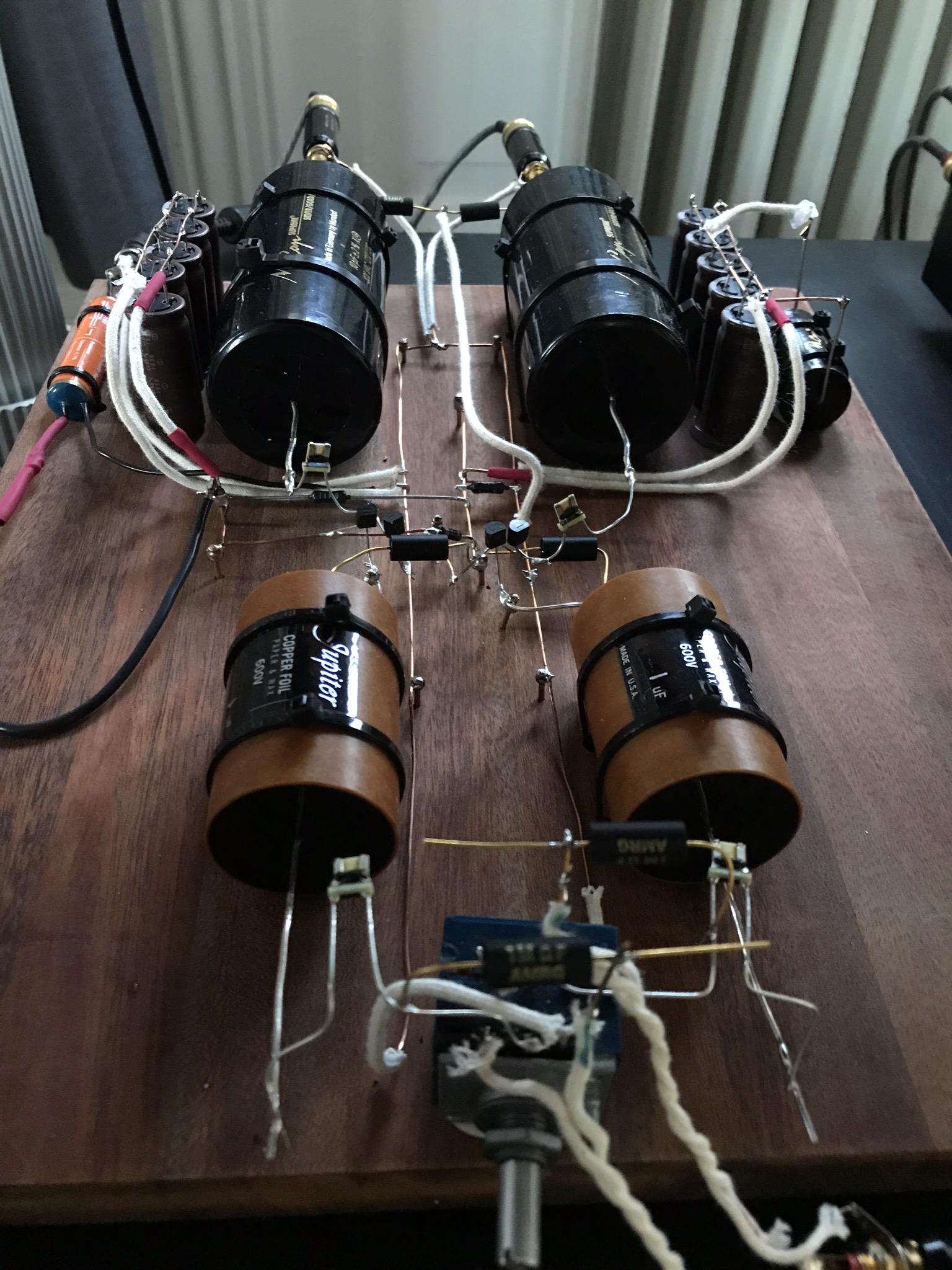

I really love this version of the B1, don’t underestimate good components and careful matching. This is the best I’ve heard yet.... period. I’m scrapping money for a nice attenuator next, switch for input, WBT next gen and a nice case.
The sound is so extremely delicate and real. Later I will test it against a 10000 preamp.... I already know the winner.

Adagio, I really love your version of the B1. "Dead-bug" style is always interesting to see.

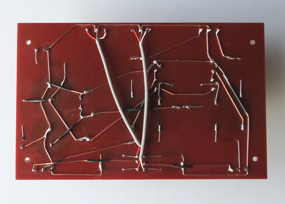

Not to take anything away from your achievement, here is my own B1 version built on Paxolin sheet. It sounds absolutely gorgeous; especially when used with the H2 Rev 1. That combination just sounds "right" to me.

Hi ! really impressive display of high quality parts. 😱
Could you share any detail about the power supply maybe ? 😱 thanks, gino
Hi! Well that is the part exept attenuator and input selector I haven’t got around to yet. Right now I use a simple low ripple 18,5V power supply from LG.

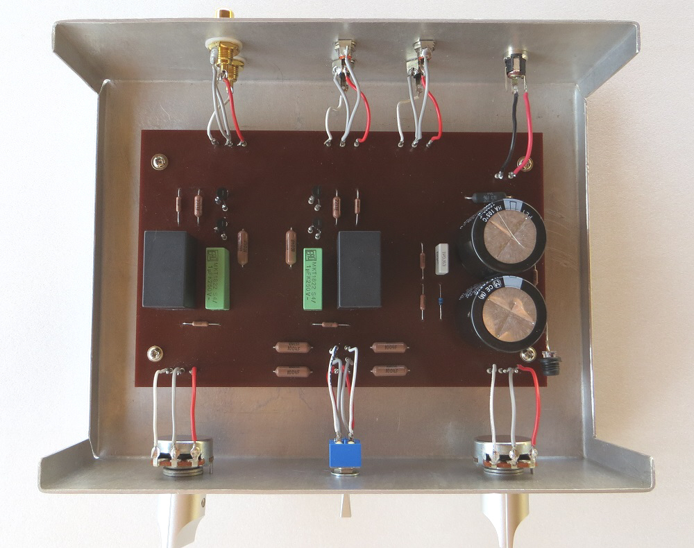

I listened tonight to my balanced B1 and was really blown away by it. It's made me think about building it again but with better parts. Are there Gerber files (or whatever) of the PCB so I could get some more made? (I assume these are not readily available at this point.)
Of course, there is the alternative of doing point to point wiring, but I'd prefer a PCB.
