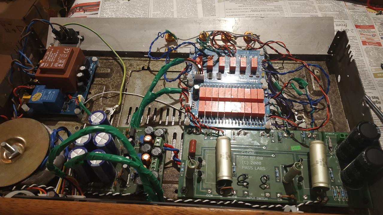

I have a 50k relay resistor attenuator for volume control which has 1024 steps a b1 buffer after it, the b1 has W and CW jumpered, which means it's outputting full volume, due to this I can't use my volume control past 100 of the 1024 steps.
Is there a way to make the b1 show half the volume, maybe a resistor?

I built a B1 (pics in post #4331) and used it for quite some time, but eventually replaced it with another preamp with some gain - to get more volume from my 6W ACA.
After I built an H2 V1, which was generously donated by Papa Pass, I dusted off the B1 and connected it up to the H2 and ACA. This is the best my system has ever sounded. And the amount of gain the H2 has, is perfect for use with the ACA. With the H2 distortion set to 1.1%, the soundstage improved slightly with better layering, but what I like most is the almost mystical way the sound is now reproduced. It just sounds RIGHT to me. Sure, one can argue that the B1 is virtually transparent in sound, but the H2 makes it sound so much better. Now my B1 is being used again and I think that the combination of B1 + H2 will by in my system for a very long time.
