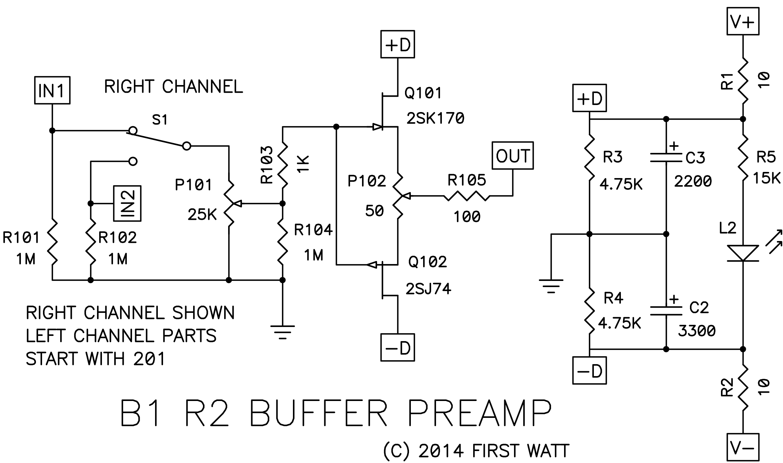

B1 R2
Hi, I would like to build the B1 R2 buffer, schematc added, but I have some doubt, first the voltage of the power supply, I’ve seen from 10v to 30v.
The other questions I have 2 very matched pair of 2sk170/ 2sj74 with idss 4,12, should be enough?
Many thanks
Where did you find the B1 R2 schematic? Maybe there is more documentation available in the same location. 😉
I've built the B1, but am not aware that is a R2. It looks like a typical Pass schematic, though, so maybe I missed the announcement. Do you have PCB's?
